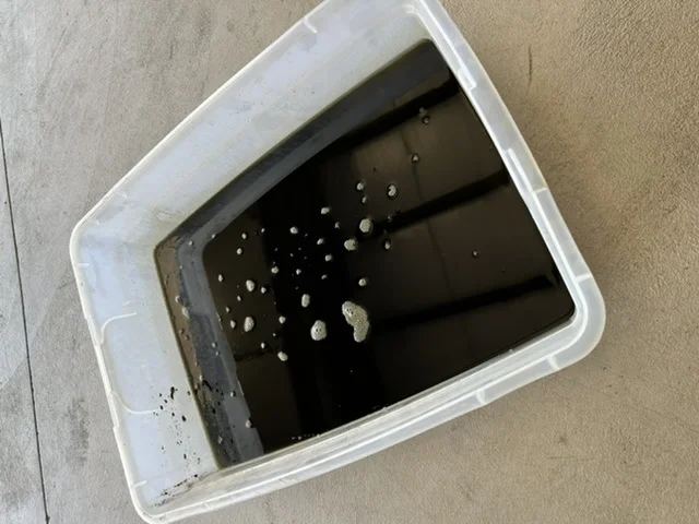

Mine was gross after one year and 15K. I'm thinking it's due to lots of creek crossings, despite having extended differential breathers. From now on I'm using cheaper fluid and changing it every single year - it's only a $50 job using Valvoline Conventional 80W90.
