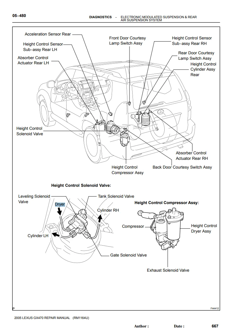

Searching the Repair Manual for "Desiccant" and other variations of the spelling doesn't return any results, so if the repair manual doesn't even mention it I'm not sure where we could find more info on it. The manual does mention the Dryer itself though, here's a quick diagram in case you haven't seen it. Which it does look like it probably isn't meant to be removed/serviceable on its own, but I could be totally wrong.

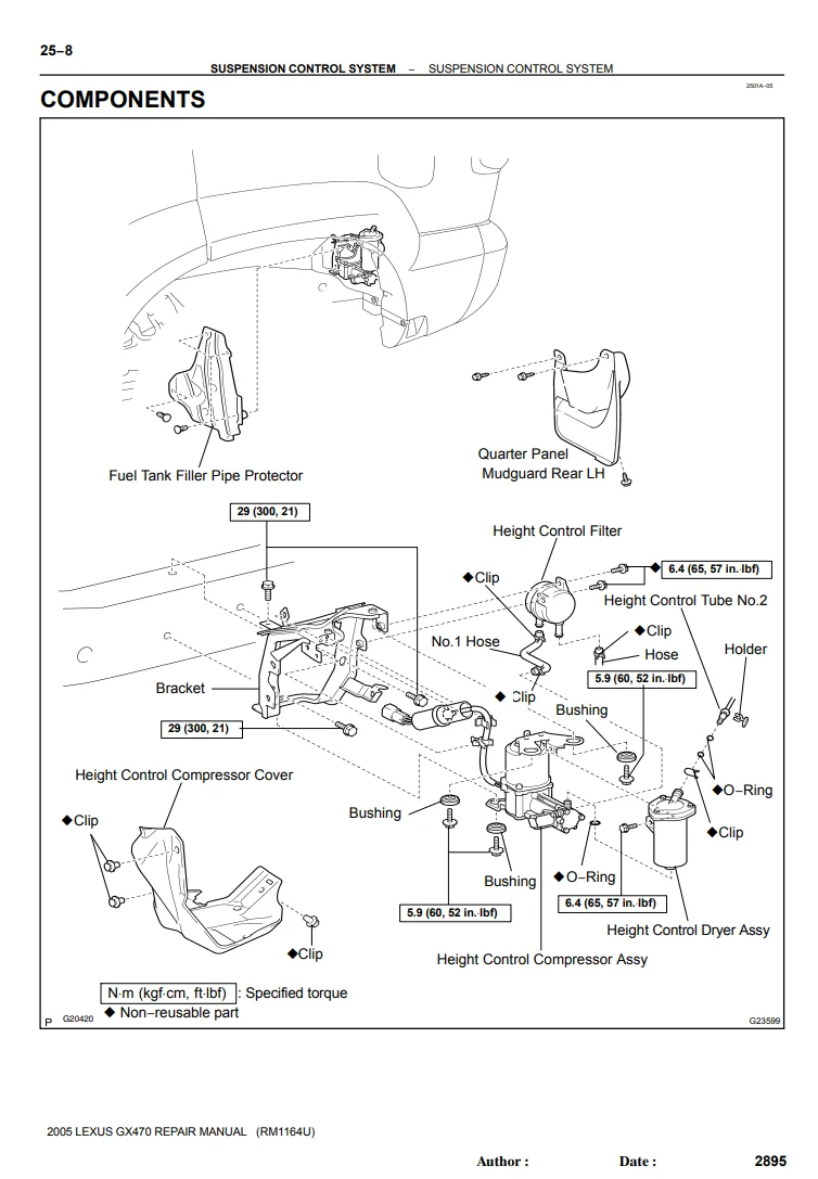

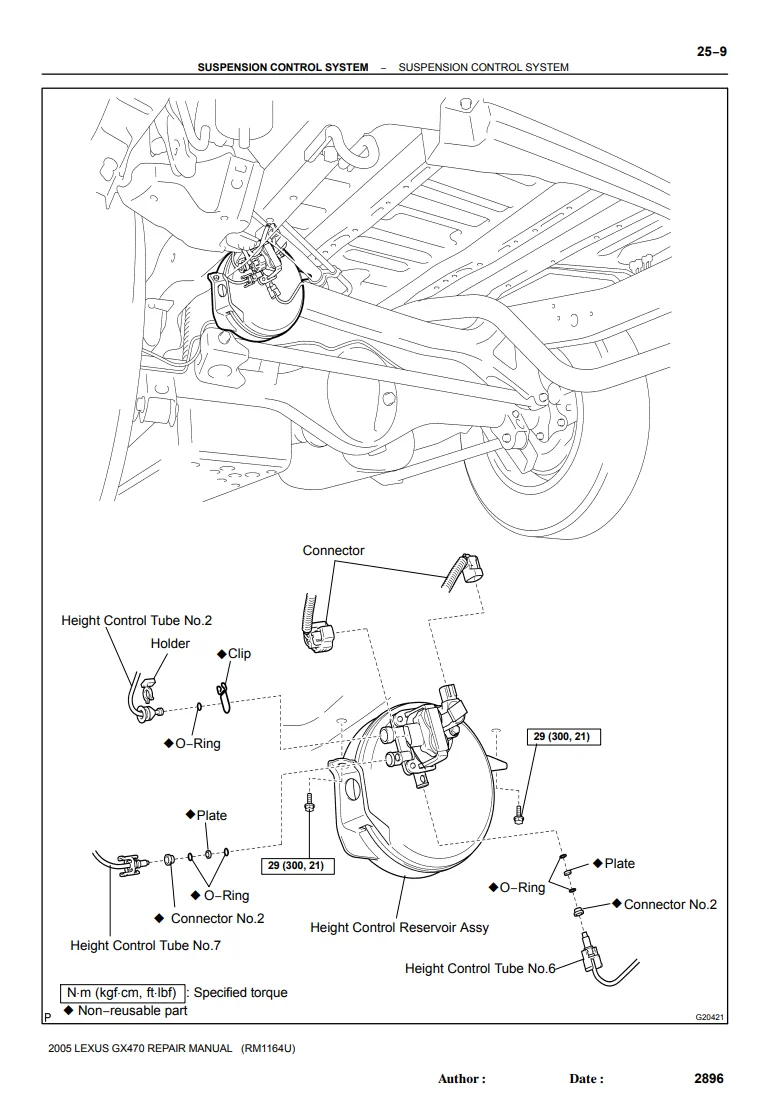

Posting this in a separate reply since the pages are kind of big images. But here's a closer look at the system. I'm not sure how the desiccant and dryer and filter all play into each other, but there are torque specs for removal of them if needed. I'm not seeing any diagrams of the interior of the dryer or filter though, which again makes me think Lexus probably doesn't want techs cracking them open and just replacing the unit itself.

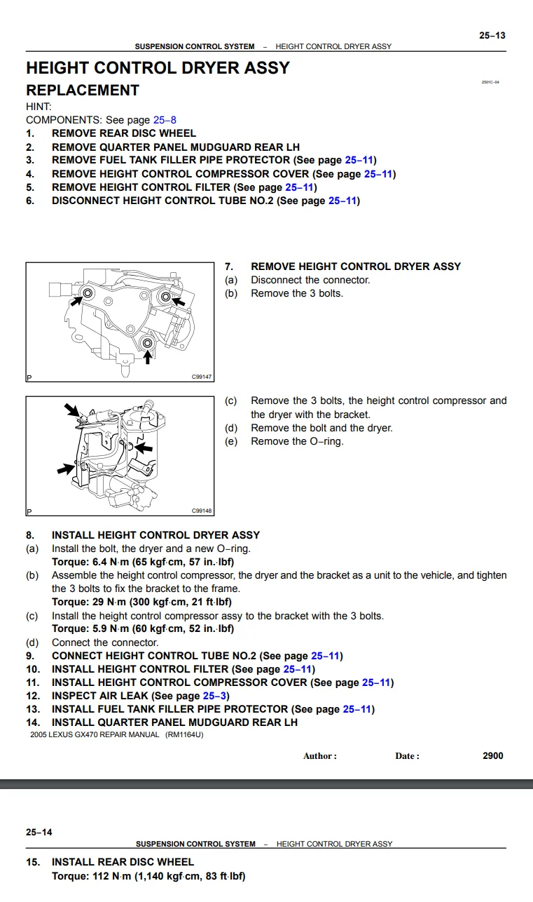

And reading more there is actually a guide to replacing the dryer assembly. And I read further ahead to make sure I would get anything else in this post, hopefully all of this is helpful info and I'm not spamming the thread too much. But the assembly itself can be replaced, so it's not part of a larger system that needs to be replaced all together. But there's no mention of doing anything inside of the dryer assembly or the filter with any sort of desiccant, only replacing them entirely. That's all I can find right now unless you have other search terms that I could look in the repair manual for. As of right now though it seems like the desiccant itself isn't something Lexus planned on being serviced, just the entire dryer. But again I might be totally missing the mark and there might be someone more knowledgeable out there about this.
