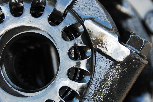

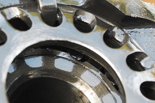

The old diff does not turn smoothly. Small chunks of metal are missing from the side of both carrier bearing inner races on the old diff. Perhaps the result of another problem.
I'll post pics tomorrow.
Small chunks of metal are missing from the side of both carrier bearing inner races on the old diff. How could this happen??
Any idea how this could happen?

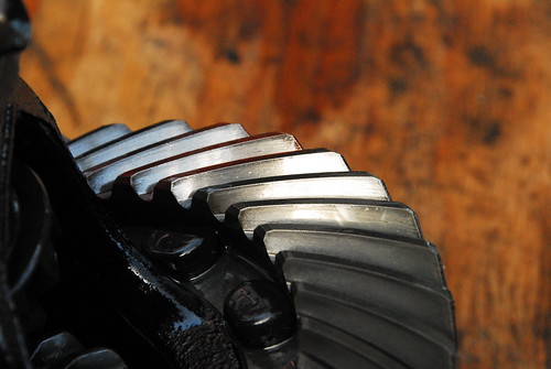

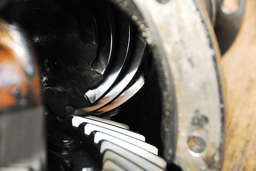

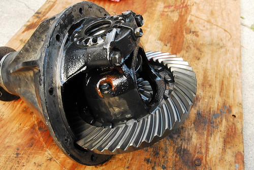

When turning the flange on the old diff, there is resistance about every 1/8th to 1/4 turn (I'm sure this was the noise we heard). I don't see any damage to the ring and pinion. I assume the resistance is in the pinion bearing or something in the carrier bearings.
The ring and pinion look good to me:
