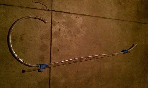

At home, I put the car up on four jack stands and had the :princess: in the drivers seat with the speedometer up to 15mph while I probed the rear drive train for noise. I cobbled together this thing for the job:
The long end of the hose on my ear while I probed with the other end while the truck was running in drive on the jack stands at 15mph. It seemed noisiest near the rear diff flange, but the pitch seemed higher. The "growl" was very noticeable standing and facing either of the rear wheels. Whatever is causing the noise, the rear axle housing is doing a great job transmitting the sound out to the ends of the axle shafts.

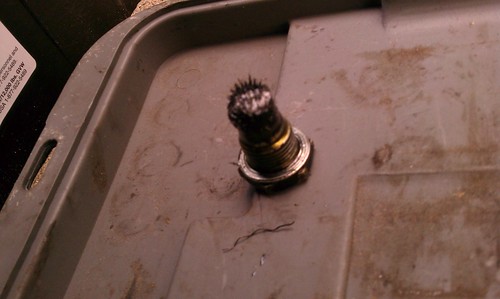

While using the ih8mud search, it was mentioned that you could pull a diff plug and quickly put your thumb over the drain hole. Allowing inspection of the diff plug magnet with very little diff oil loss. Here is the magnet:
See the wire in front of the plug, that came from inside the diff and was stuck to the magnet. What part inside the axle housing has a wire? Note: This LX-450 does not have diff lockers.

is it an actual wire or is it a shaving of metal?
It's wire. Not brittle and sharp like a shaving. Bendable.

On the other hand, that much junk on your magnet plug seems to point toward a problem in the third member. If your pinion bearing already spit that out, I kind of think things would be far worse at the rear diff flange than the evidence for that otherwise indicates.
The "wire"? That's weird.

Has the differential been opened previously and could that wire be from a wire brush?? When I did my front axle service for the first time I found a detent ball in the bottom of the knuckle that had apparently popped out of a socket extension bar.
Possibly. It has FIPG not the paper gasket.

When I went to re-fill. There was more "fur" on the magnetic drain plug. Not as much as a few days ago but plenty. I also noticed metal filings in the oil up in the drain hole when looking up inside.
That right there would indicate its time to pull the 3rd and look into it more. Something is coming apart, with the amount of noise and fuzz on that plug there is defiantly something bad happening, I would bet the ring and pinion are grinding them selves up.
