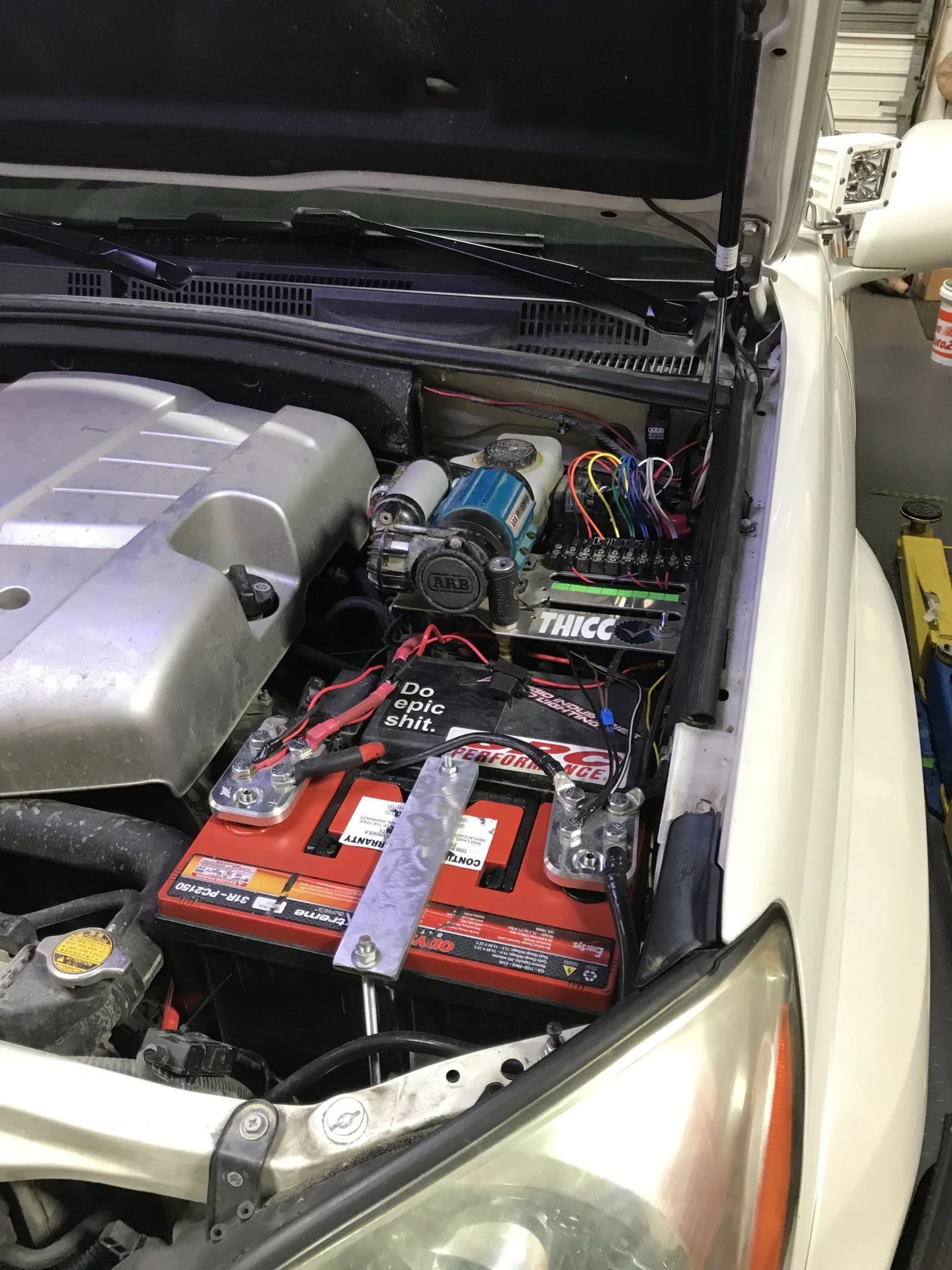

I have searched around the forum for group 31 battery installs and have found some info that it looks possible. But not a ton of info as to how difficult it is to fit. I am talking about replacing the stock battery.
It will fit, but depending on where the posts are you may need to lengthen some wires. I had to lengthen the body ground and the power supply cable to the fuse box. I am away from the vehicle so can’t get you any pictures right now.
Super easy and worth it. I had a chunk of aluminum to make a new battery tieand added some Xplicit Audio battery terminals.
