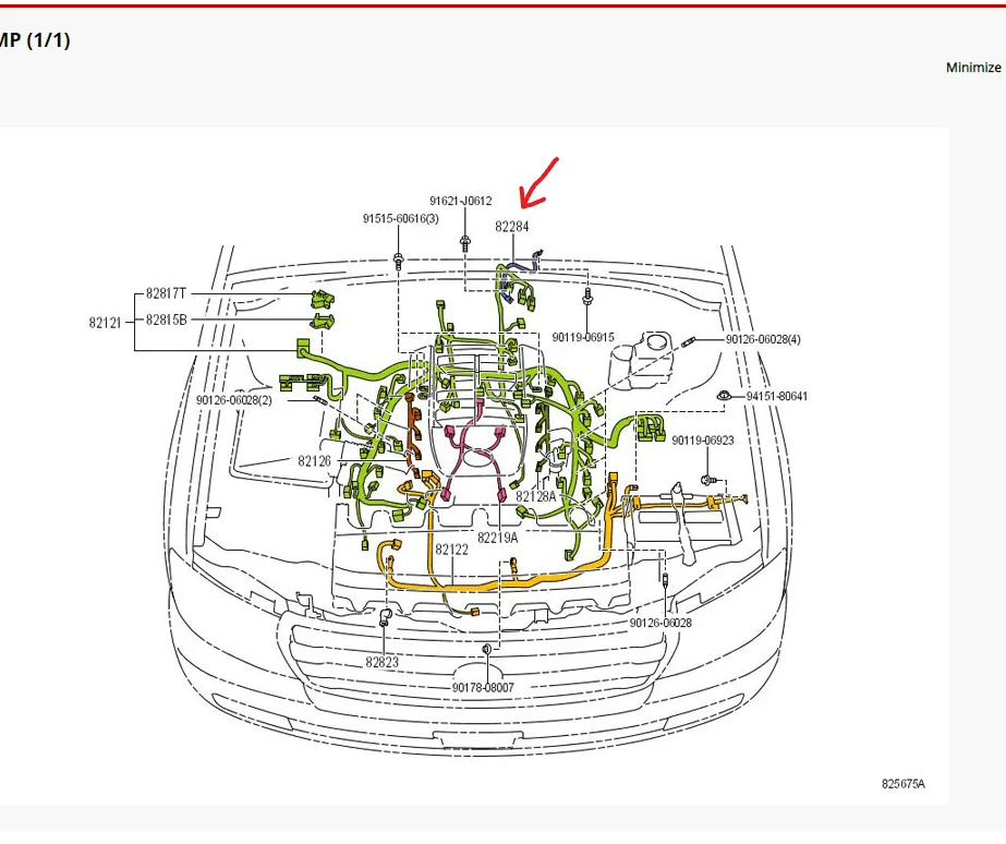

Does anyone have a part number for the ground strap for the transfer case? Can't find it on any diagrams. Might just get a generic one if I can't find OEM.
Edit, @Karbon seems to have confirmed this. Another tip: Check your transfer case carrier ground strap! - https://forum.ih8mud.com/threads/another-tip-check-your-transfer-case-carrier-ground-strap.1240292/
I'm wondering if it is P/N 82284-60130 (CABLE, GROUND. WIRE, EARTH)

Thanks but that's not it. I'm going to get a generic one. No difference with OEM its a braided copper wire. I noticed it was hanging by a thread when I was installing my skid plates. I was also having issues with 4Lo and the diff lock. Nothing major just a little slower. I spliced the old busted one with some copper wire and wrapped it with electrical tape and it's all back to normal. Stupid but simple temp fix.
