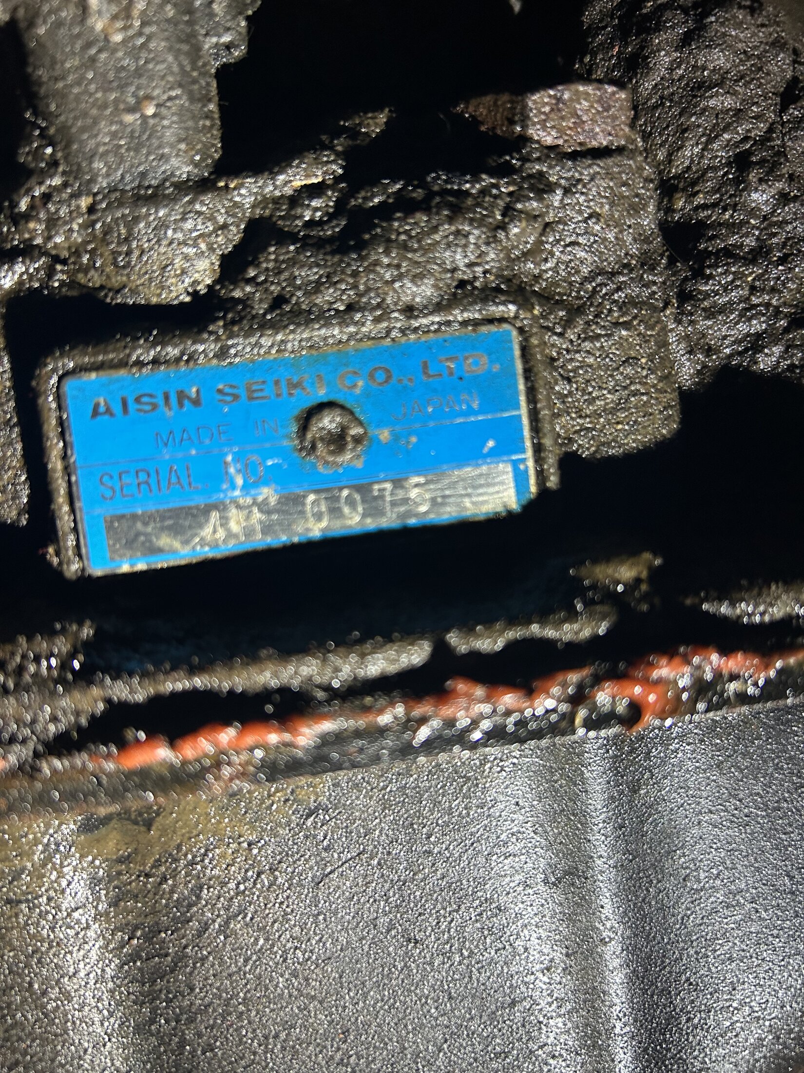

That’s tag on trans says 4h 0075 which trans is that?
If you have a 94 then you have the A442 unless there is a transitional month that some of the models got the next generation transmission, which is the A343

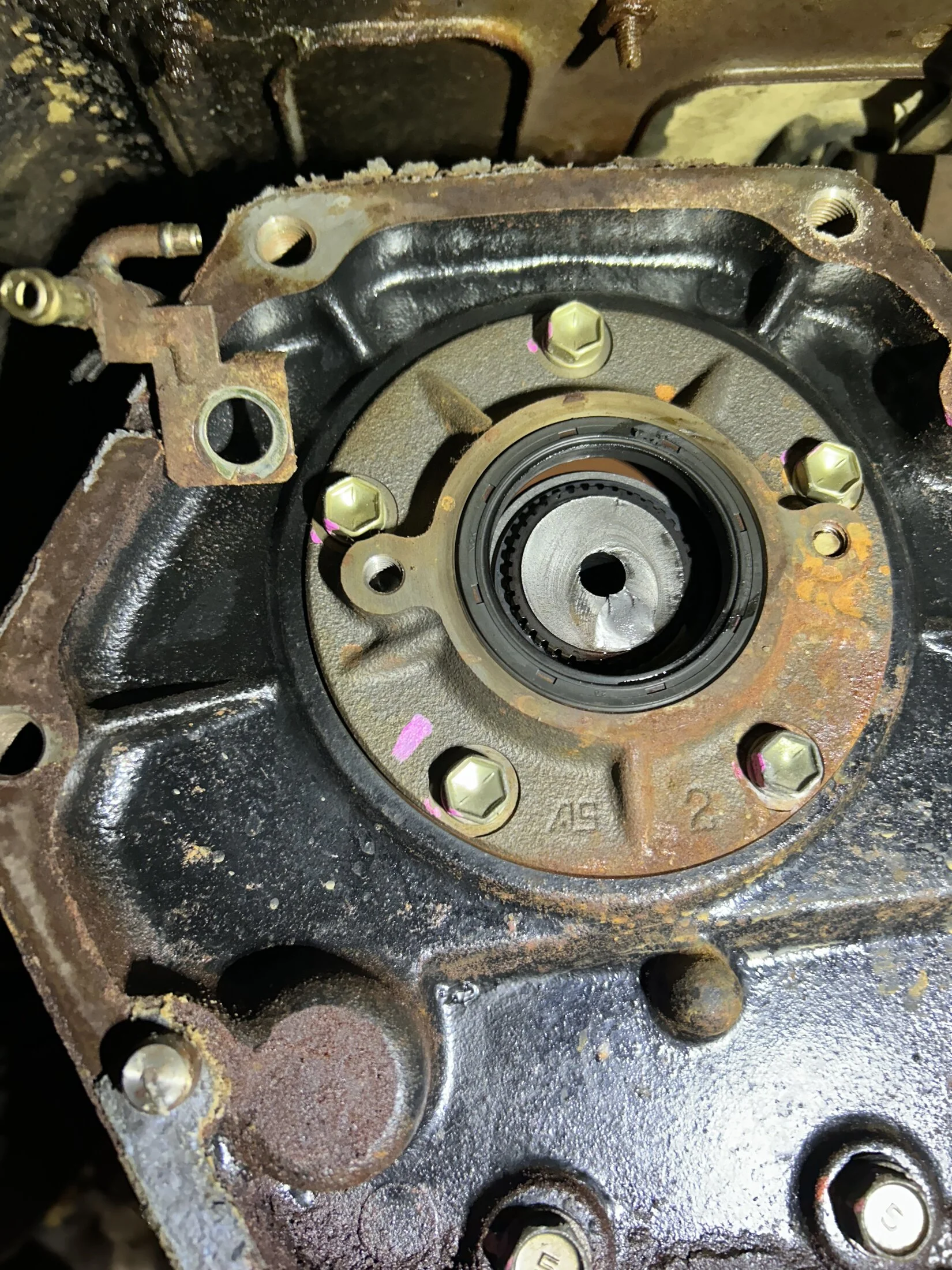

I believe it’s the output shaft. I’m going to be taking it out tomorrow I will up date once I have the unit on the bench.

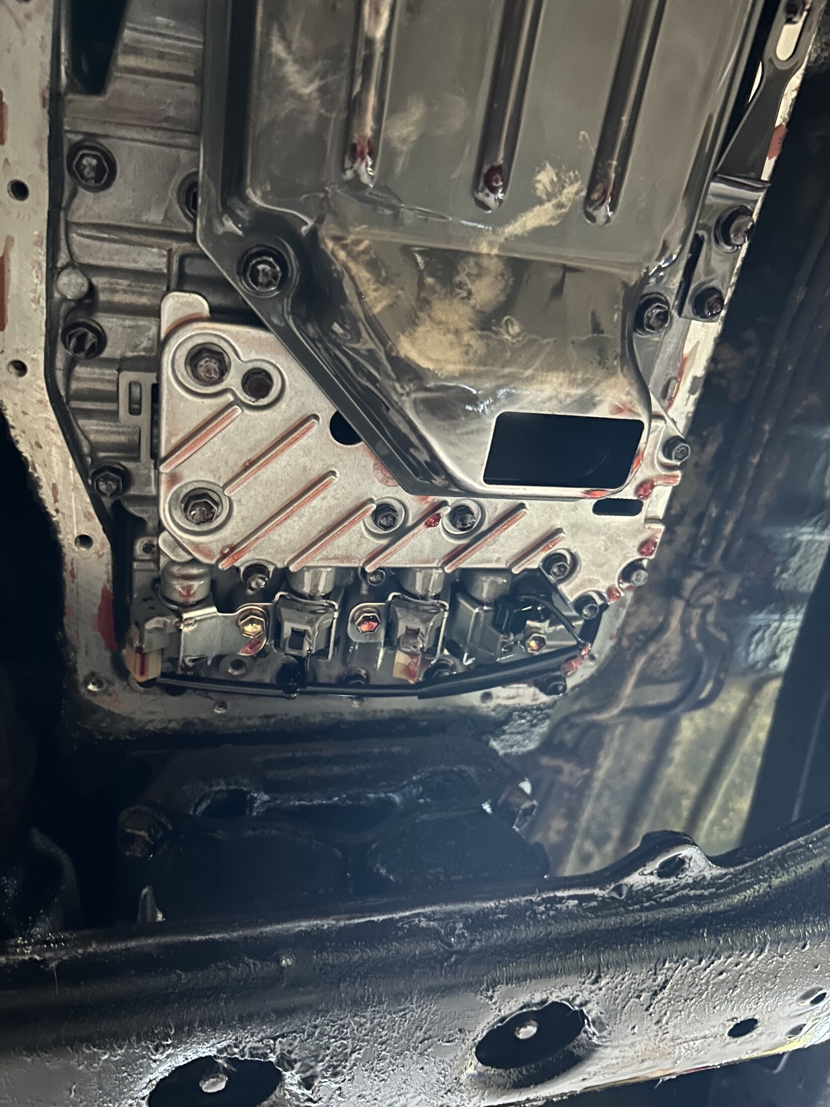

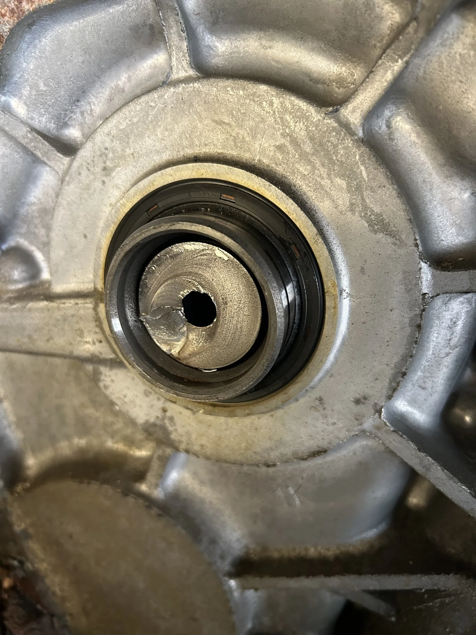

Was able to do some work on it. dumped the fluid in transmission and pulled pan everything looked good. I moved on to pulling the tc once I got it out after some fighting I found the shaft is snapped. So that is where my problem is.
That's definitely your problem.
The good news is that shaft is not uncommon. The bad news is you're going to have to buy a transmission to get one.
