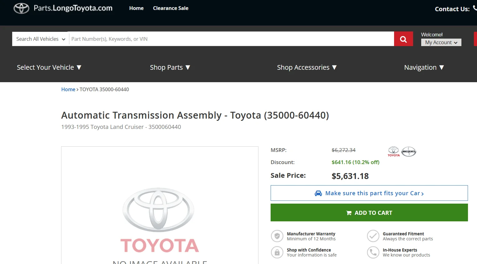

If you can't find just the shaft, you may be able to find a used A442F, but you'll need to have it rebuilt, unless you're a pro gambler. FWIW, the US stock lists new A442F, not rebuilt, for just over $5k.

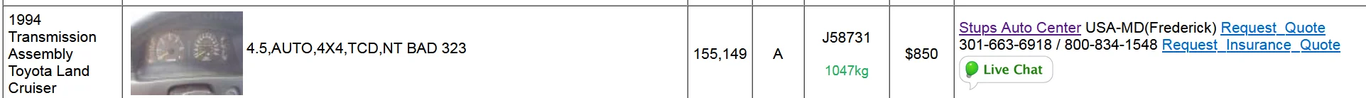

I'm pretty sure you can find someone with a transmission that's dead for other reasons and get that shaft.

FWIW, I'm going to pick up a A442F this weekend. I'll ask if there's a dead soldier lying around and let you you.

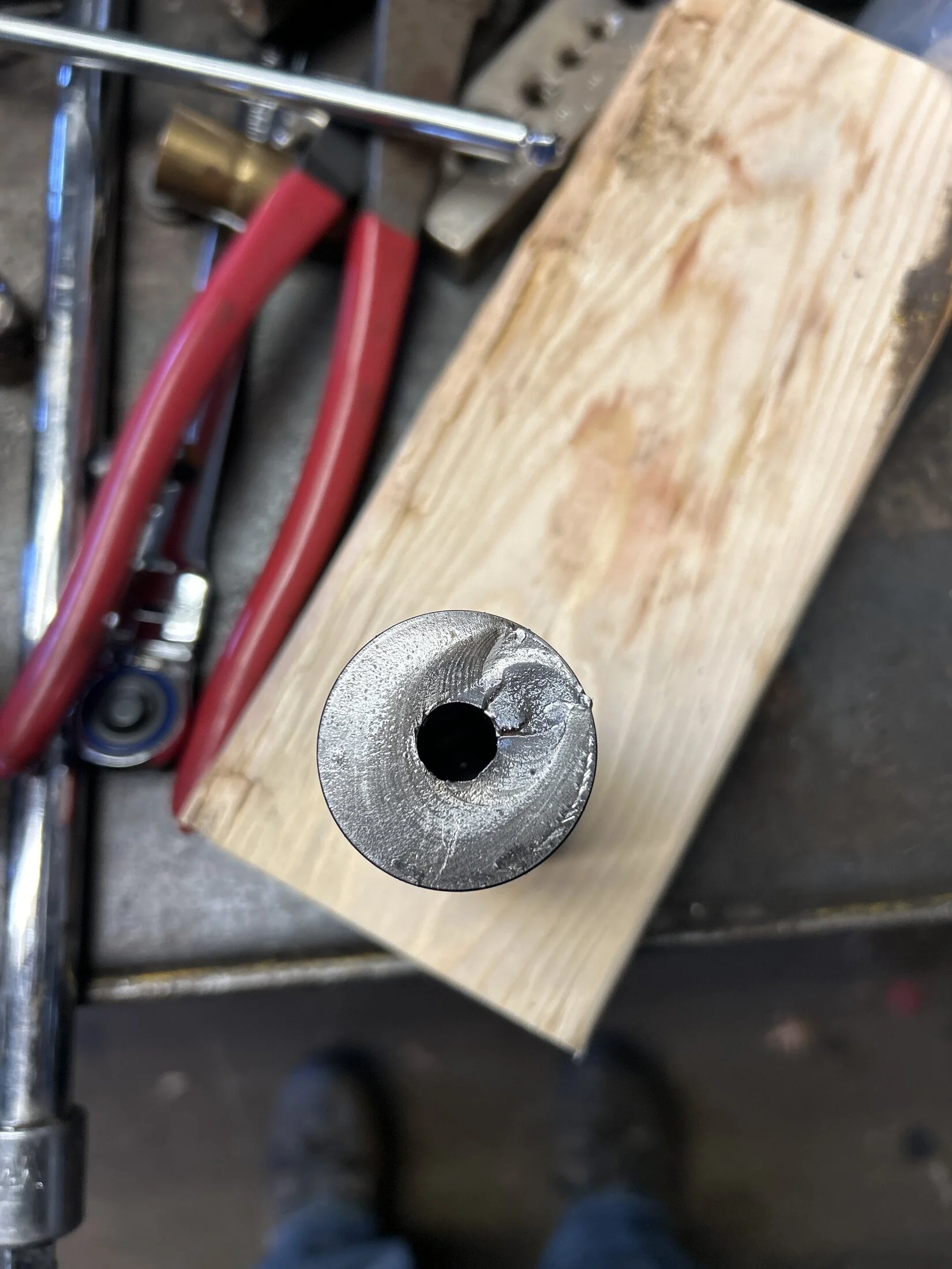

There is definitely a need for further inspection, before the transmission is fixed. It didn't eat itself.
I don't understand how there was no bang or crazy noise when this happened. Is the bearing the shaft broke near still spinning? And the one on the other end? I assume there's one on the other end...
If it didn't roll fine, I would wonder if the rear end locked up and snapped the shaft, somehow.
Maybe it's worth poking under the differential covers just to be sure things are okay.
There wasn't a ton of metal in the transmission pan. I don't immediately think the whole thing is toast based on that. But it is really suspect how it went out in the first place. It seems like something had to get into a failure condition to snap that shaft.
Have you torn down the transmission anymore to see if there's any clues?

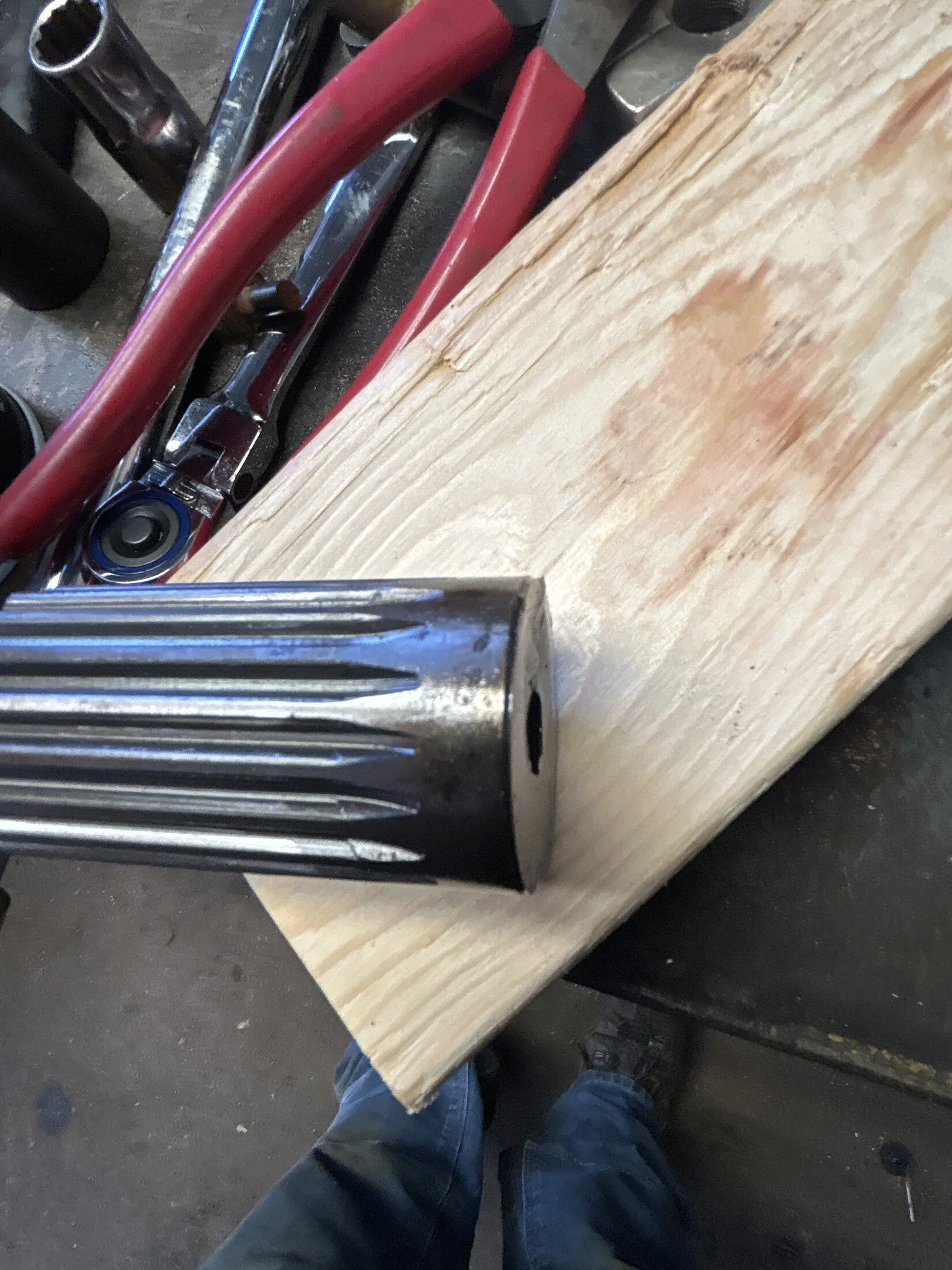

That was my thought process initially, but the break is across the diameter and not at angle, which would have been consistent with a torsion fracture, unless there was already a defect (inclusion or microfracture) in the shaft at that point. I'm not sure that shaft is hardened (and even if it was, it was case hardened only), so if it wasn't, that wasn't a torsion break, which it would have been if the rear end was to blame.
The existence of a defect also would have explained the lack of a loud bang when it split. It would have popped for sure, but maybe not loud enough to be heard over road noise. And a radio...or wahtever else was going on at the time.
It's academic at this point, but unless @family80 knows someone in a metrology lab, it's going to have to remain a mystery.
That little round spot in the face is the inception point of the failure. That shaft was a time bomb.
