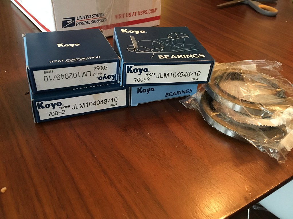

New Koyo wheel bearings and hub seals from @reevesci

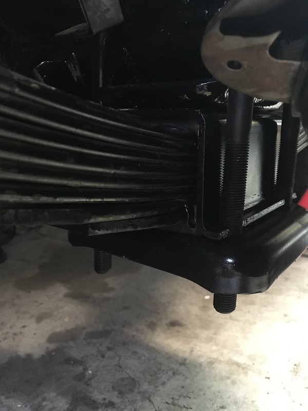

I am going back to the OEM rear spring sleeve clamp setup because 1- I received the wrong bushings to do the delete, too much wiggle room:
2- I didn't realize at the time of installation that Tough Dog actually thought about the rigs their springs were going to go on and made them so they worked with the OEM setup! Or it was just by chance, but either way its a great to be able to stick with the tried and true original setup.

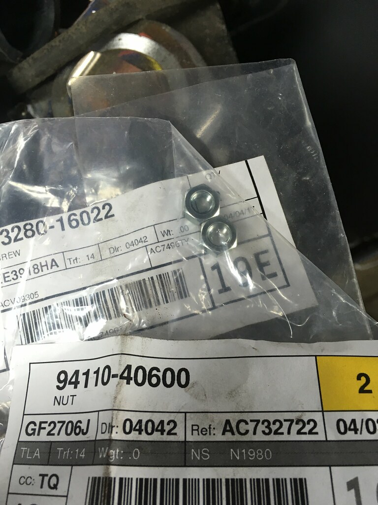

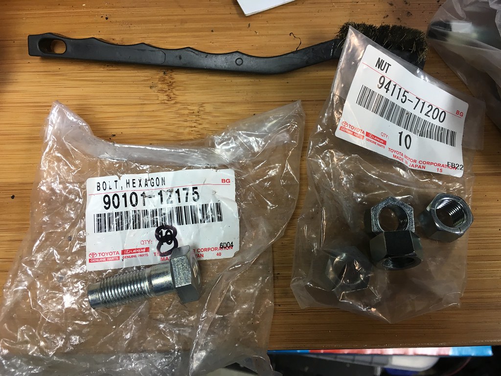

New main nuts and bolts for the shields:

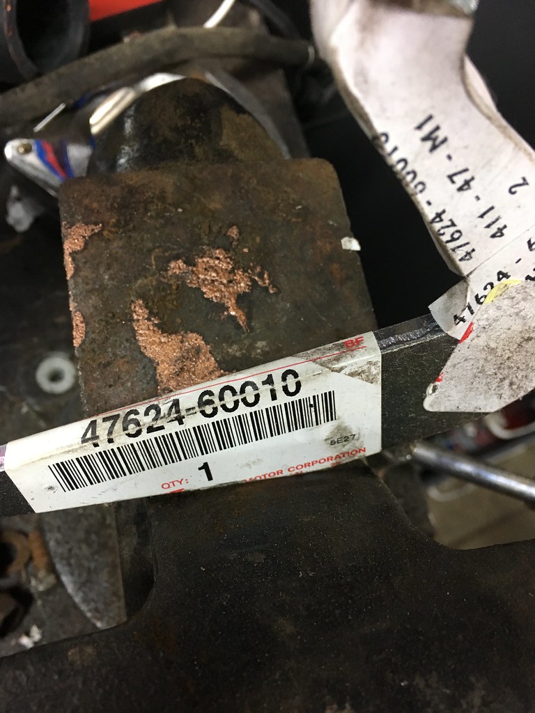

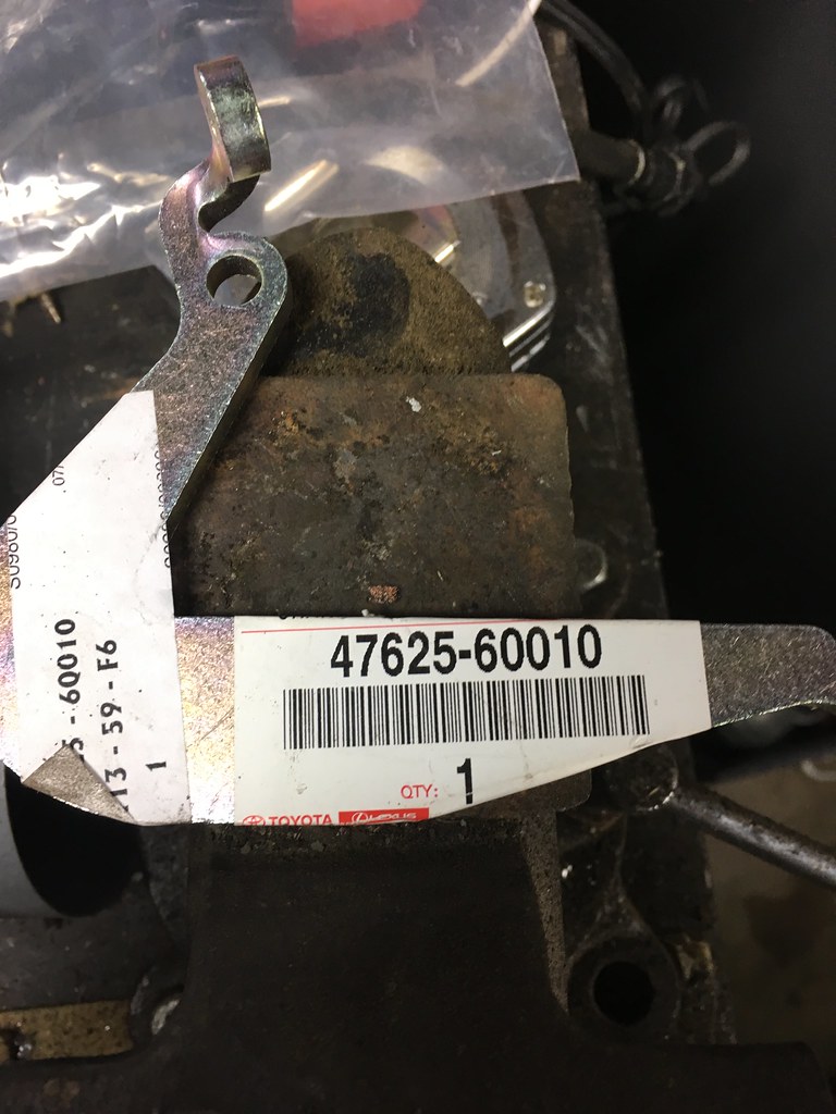

Complete rebuilt the bell cranks for the E-brake with a very liberal bath in anti-seize:
New arms

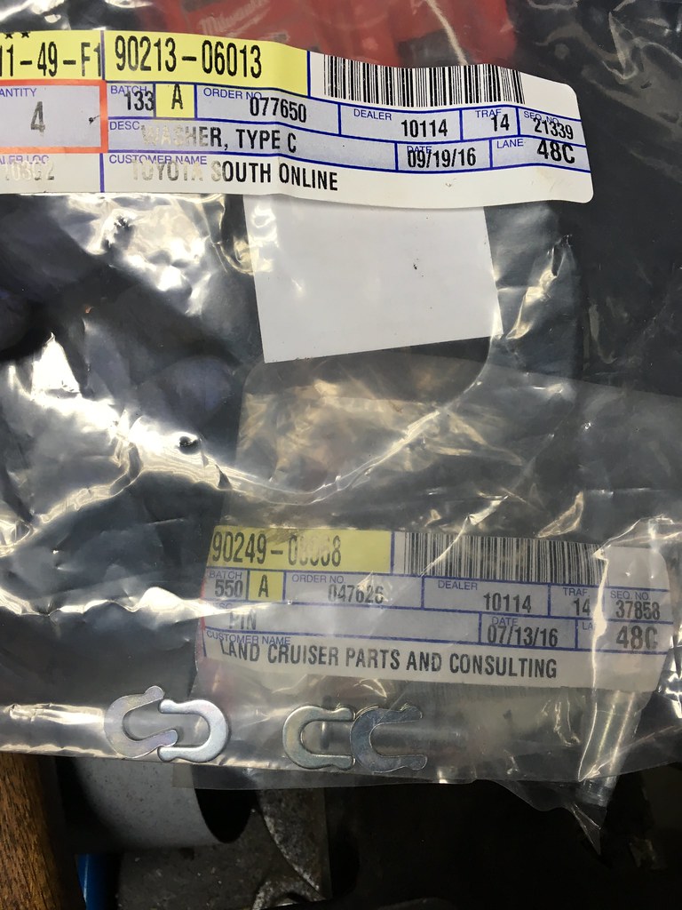

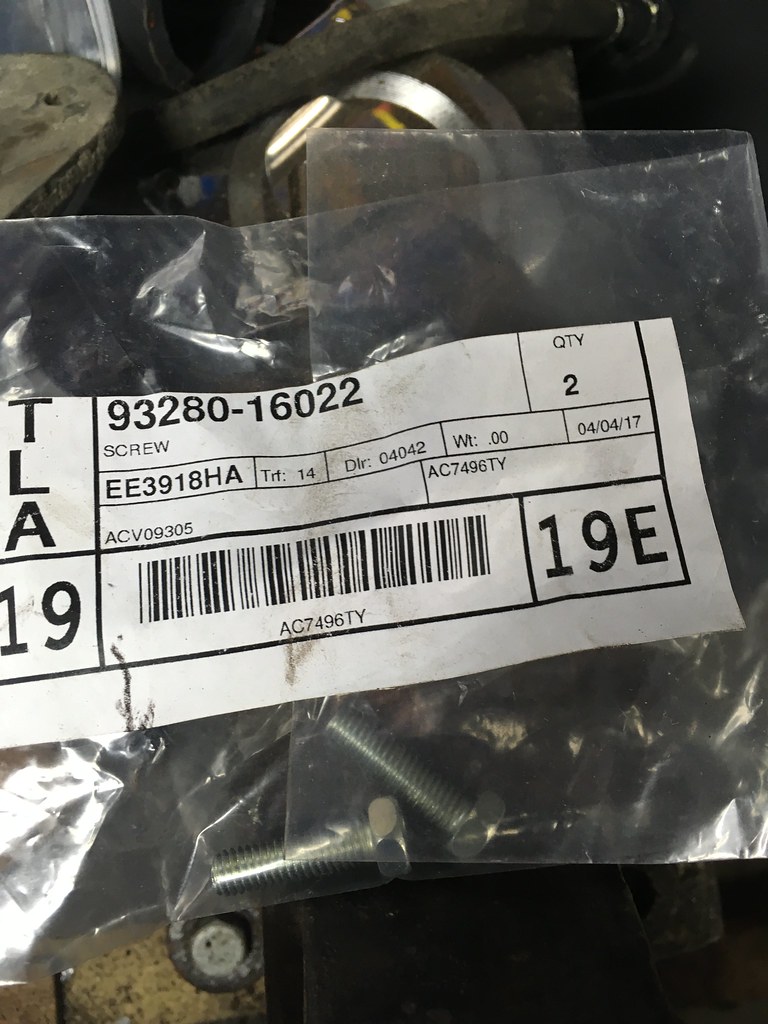

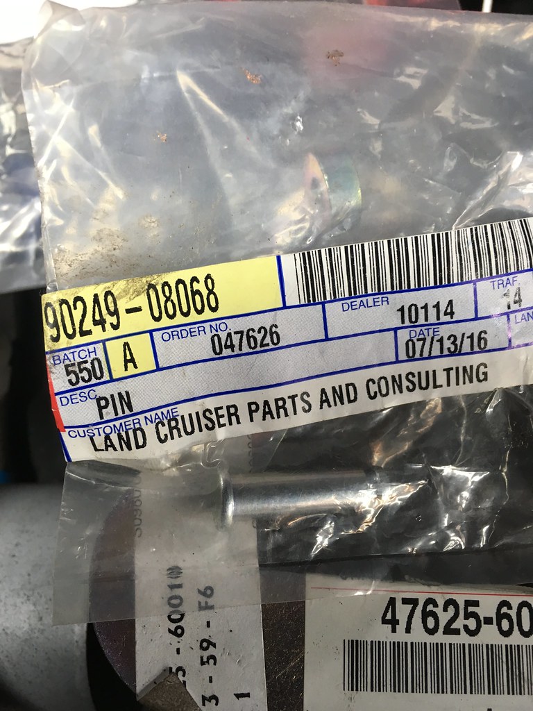

new pivot pins, c-washers and set screws for the arms

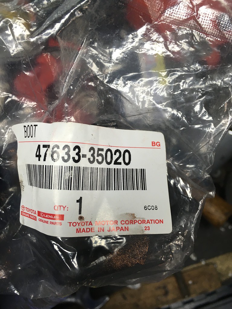

New boots:

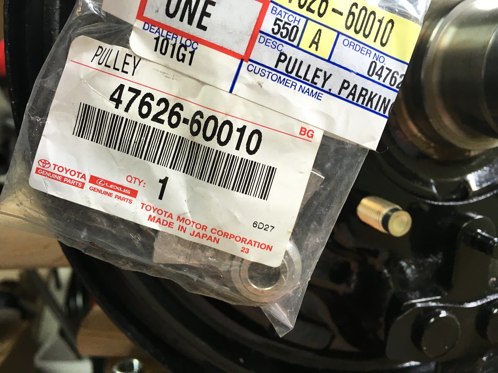

New Ebrake cable pulley (lubed with high temp brake grease)

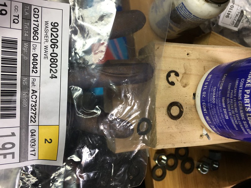

Wave washer
The correct Toyota e-washer for the pulley spindle is discontinued but I found a perfect match at the hardware store.

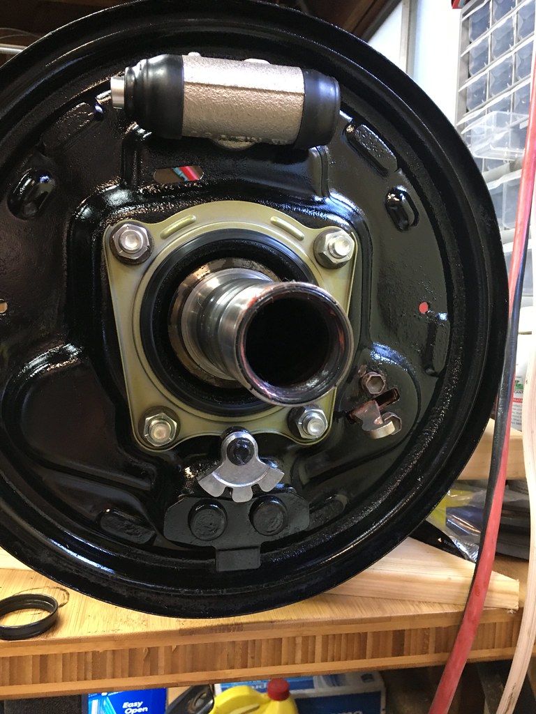

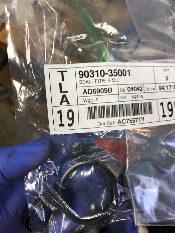

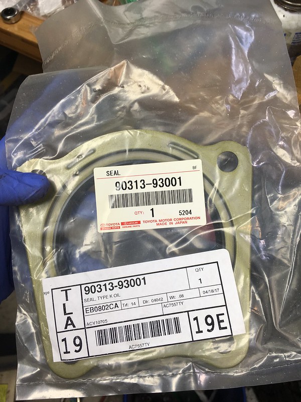

Backing plate seal
Axle seal
New wheel cylinders as well. Looking like you can eat off this thing. The last time it will ever be this clean again. :D

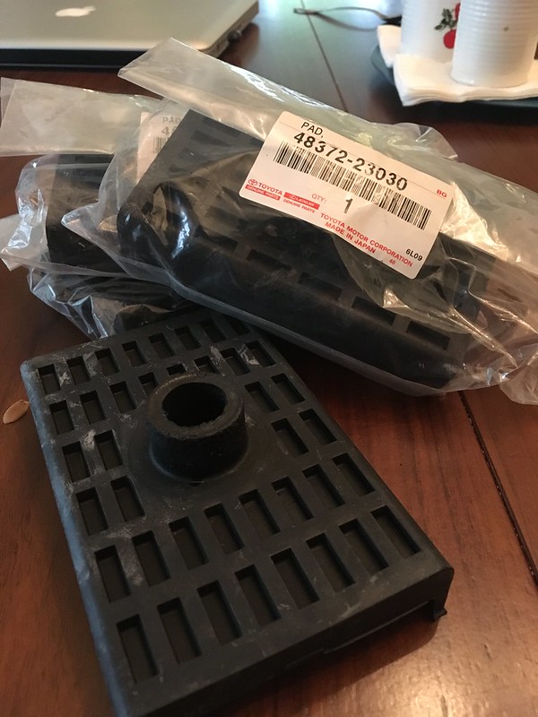

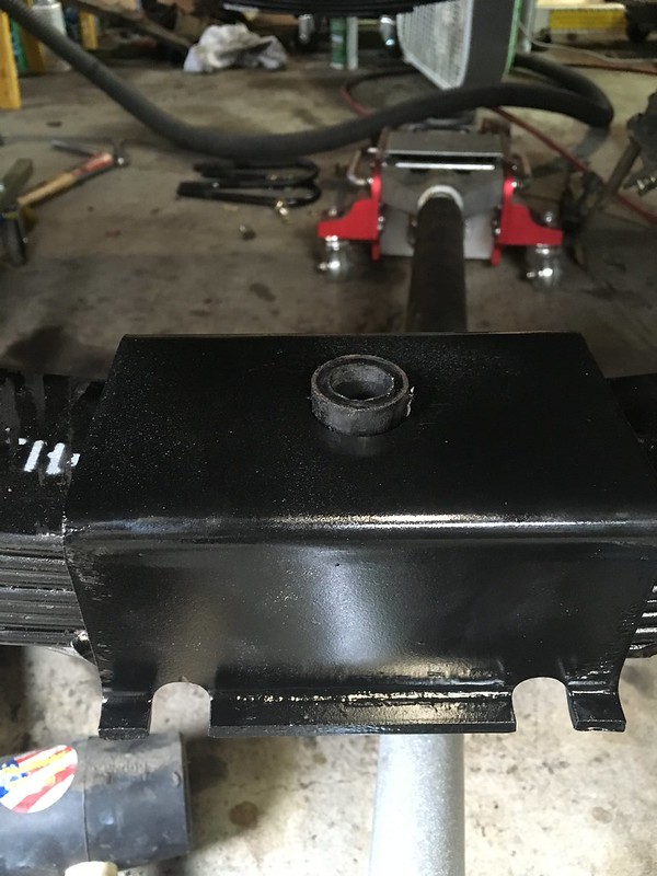

Got the new spring isolater pads in the mail (Thanks to Maarten over at CruiserWorld!) and slipped the axle back underneath. Its a race to the finish now! I like the OEM sleeve system much more than the delete with the metal bushing. Happy Tough Dog thought about this. The springs are cradled in rubber and steel and any more vibration dampening in these cruisers seems like a good thing to me. hahaha
A small note, the top sleeve is not fully seated on the bottom plate because the nuts are not fully torqued.

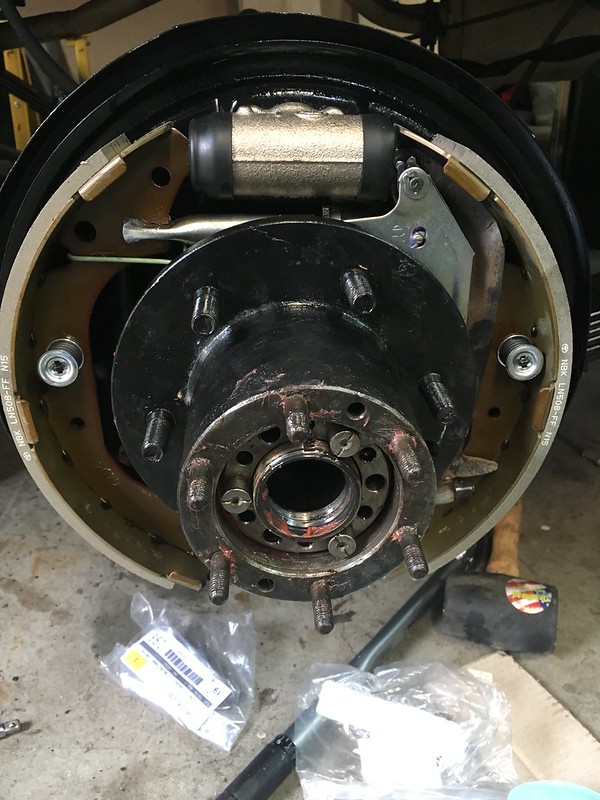

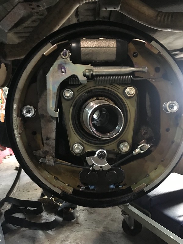

Setting up drum brakes is a b!$ch but at least they are all in.
All new hardware, shoes and drums. Thanks @beno

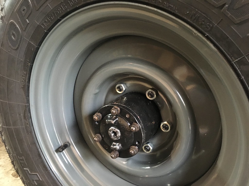

Need to modify the 54mm socket to adjust the bearing preload

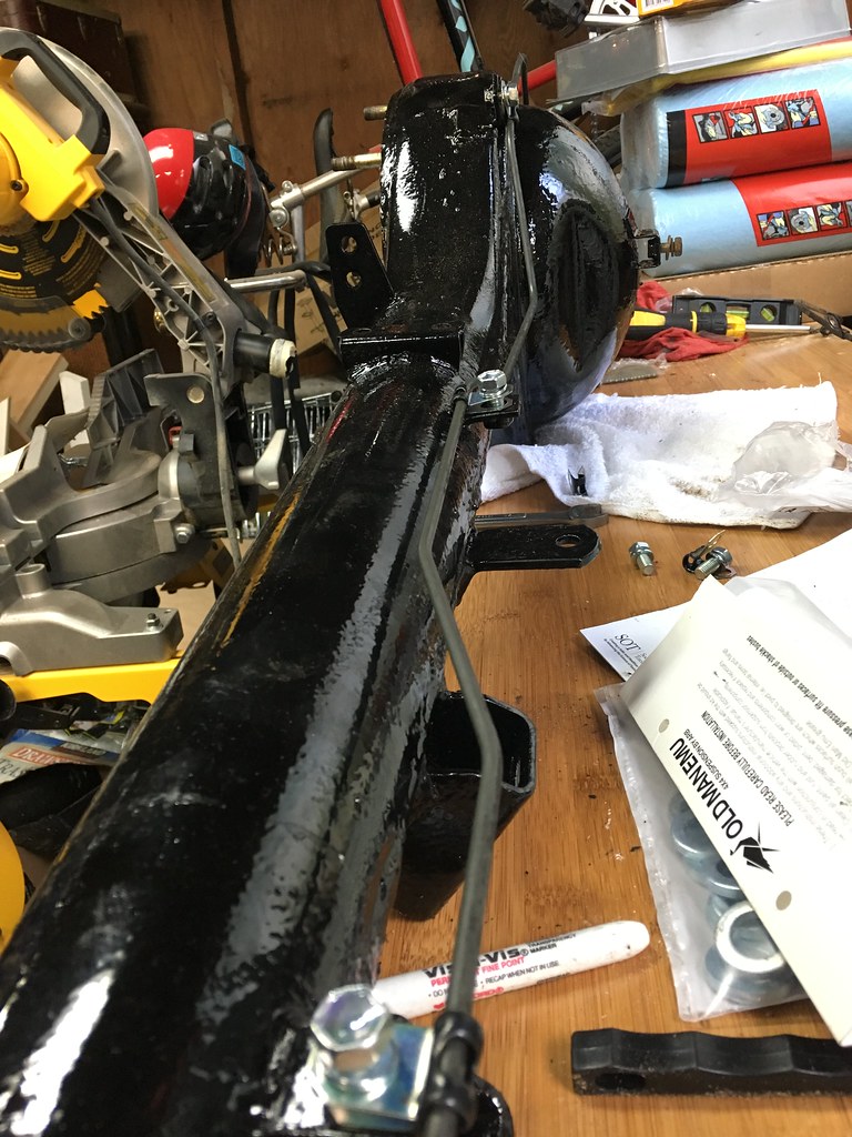

LSPV extension bracket.

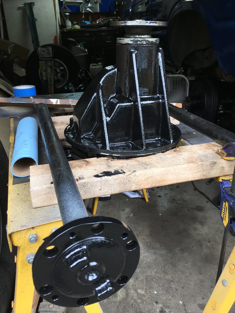

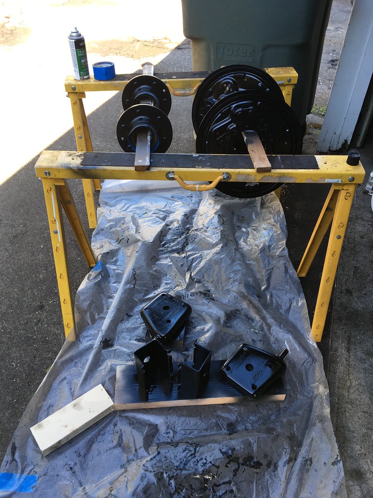

Got a lot done today. Took out the old 3rd member which was a good learning experience. Took me a bit to get those spider gears/washers,spacer and spindle all back in. hahaha Painted it with POR15 and It will be installed tomorrow. Painted the axle housing ends as well. Set the wheel bearing pre-load and installed the drums. Next I need to replace the u-joints in the drive shaft.

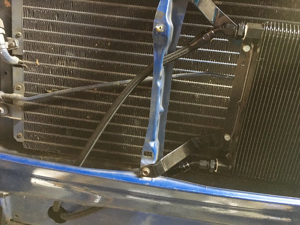

Almost done with the transmission cooler install. Need to get a couple hose clamps at the hardware store tomorrow. Lines will get an extra sheath of protection at every point they touch a surface.
