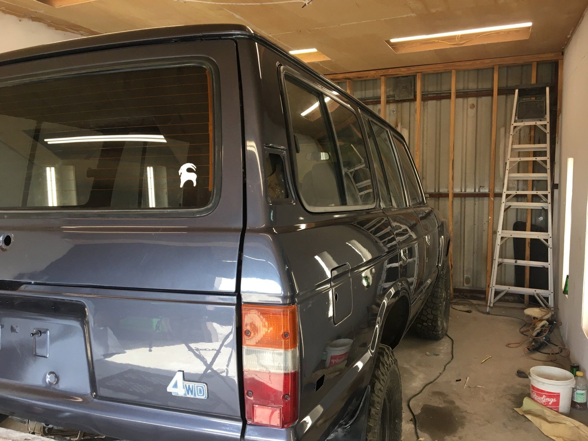

Hey all, so here is a long delayed post on my sliding window install. I bought them off ebay in 2015 and they came from Australia. They were in good condition but needed ALL new weatherstripping and a paint job. Thankfully @NookShneer also had a set so we had the frames powdered in black. Taking the windows apart was not that hard, but take pics and document where all the pieces are located and how the weatherstripping is applied. Taking the glass out is definitely a two person job and is outlined in the FSM.

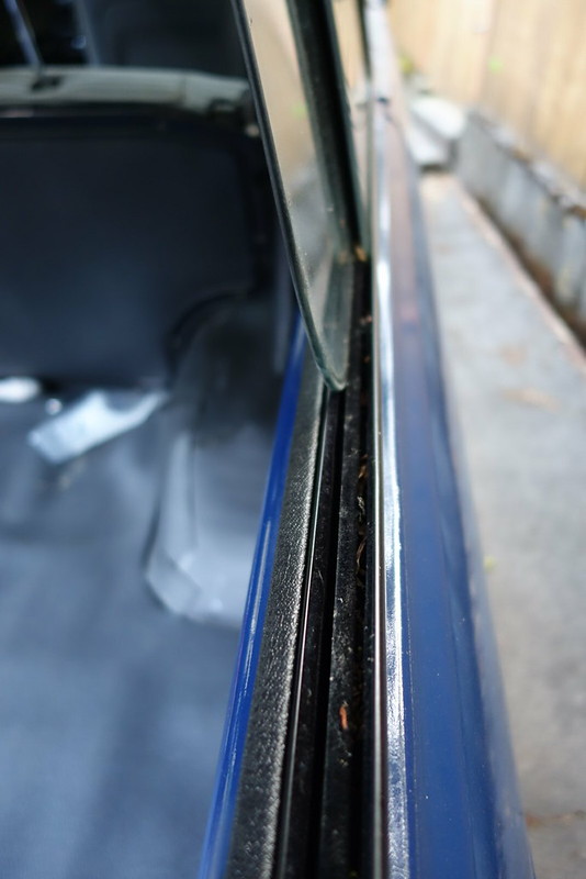

First you need new "bailey channel". This was the only non-toyota part I used. Those I got from Scott's old rubber in New Zealand. I ordered 5 meters of part # 350.117. You can email Scott at scott@scottsoldautorubber.com.au . There may be a similar part here in the US but Scott had been mentioned before in some AUS threads so I went with what I knew worked. You will have to cut the new channel drain holes and other details to match the OEM piece:
I glued them into the frame with 3M weatherstripping glue.

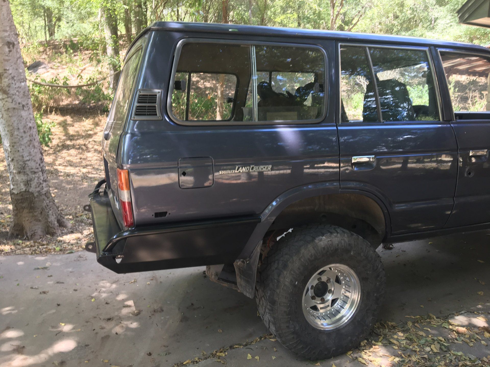

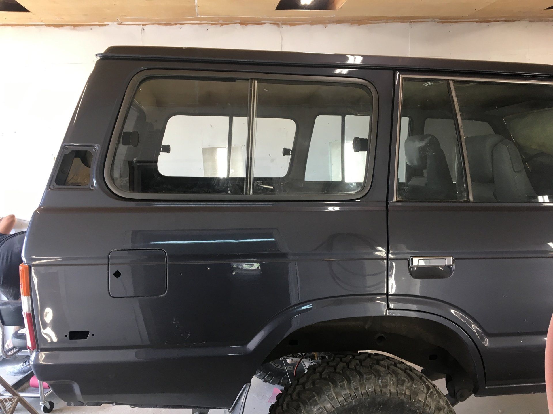

Its time to install. I had to repair some paint on the body since now was a good time while the windows were out. When the paint was ready I used 3M butyl tape to glue the windows in. "3M 08620 Window-Weld 1/4" x 15' Round Ribbon Sealer Roll" . Before I glued the windows in I peeled back the headliner so it wasn't between the body and the slider window. I didn't want any potential moisture to wick in from outside. Once the window was pressed into the body opening I used several strong clips to fully pinch the window agains the metal body lip to fully seal the butyl sealant.
After it was fully glued all around I installed the lock strip. Here are some pics of the interior and the lock strip I got from McMaster ( part# 24175K17 McMaster-Carr ). I wish I would have found dark grey but black works ok.
I know it may be a little hard to see in the phots but the lock-trim pinches the body window seam and the innermost lip of the slider window frame. It is really there to finish off the look, the butyl is what really holds the window in.
Fully Installed:
