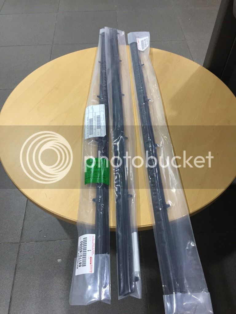

3. You can use the inner door window felts from a 75- or 79- series LC! They came from the factory with the partial door cards and use a similar setup:
75-series door-
I should note here that credit for this idea goes to @goldchaser who used this trick in his thread ( Hj61 sahara overhaul ). He was kind enough to tell me he got his felts from a 75-series LC. Furthermore, @boozewz recently demonstrated, in his amazing thread ( 1989 GCC Spec FJ62 G Trim ), that the inner window felts from a 79-series also work! He also showed that they can be easily glued in as well. EDIT: The 79 series felts are not available in the US market.
A thank you to @beno , I ordered my inner window felts for a 75-series LC from him (I am sure he knows the part numbers off the top of his head). A note of caution, when ordering the inner window felts, make sure you order them for the 75/79-series without the wing windows. The wing-windowed versions are too short to make this work.
Here is the method I used to attach them:
So once you get the inner window felts you will notice they are too long so you have to trim them and they come with thick clips, which are not compatible with the round holes on the inner door:
To make the clips fit into the round holes, I ground down the clip barbs to fit in the round holes (about 4.5mm wide):
It snapped in very nicely and securely:
Here it is mounted:

Very nice work Chase. Glad it worked out. I am happy to have a cool non-US solution.
:cheers:
Thank you! If anything, hopefully it buys us some time with respect to OEM parts availability since all the 60 stuff is drying up fast.
Great tech.
FWIW, I am pretty confident all 70 series models window felts would work, and not just limited to 75/79 series, provided as you mentioned they don't have the front window vents/wing windows.
Thanks for putting this together!
Thanks. And thank you for the tech as well. You should post your pics in this thread as well. I totally agree that other 70 series likely work as well but I'm not sure so I didn't want to say that.
Just wanted to update this to say that my balance 3 felts came in and we got them installed. This time we used the grounded down clips. We tried to take off the first test felt I installed earlier with the glue, so we could also use the clips, and it came right off. So, glue is not a workable solution for this mod.
Hope more people do this! Its super clean and fits perfectly.
Awesome! Always good to have secondary validation of a method. Thanks again for the idea! :cheers:
