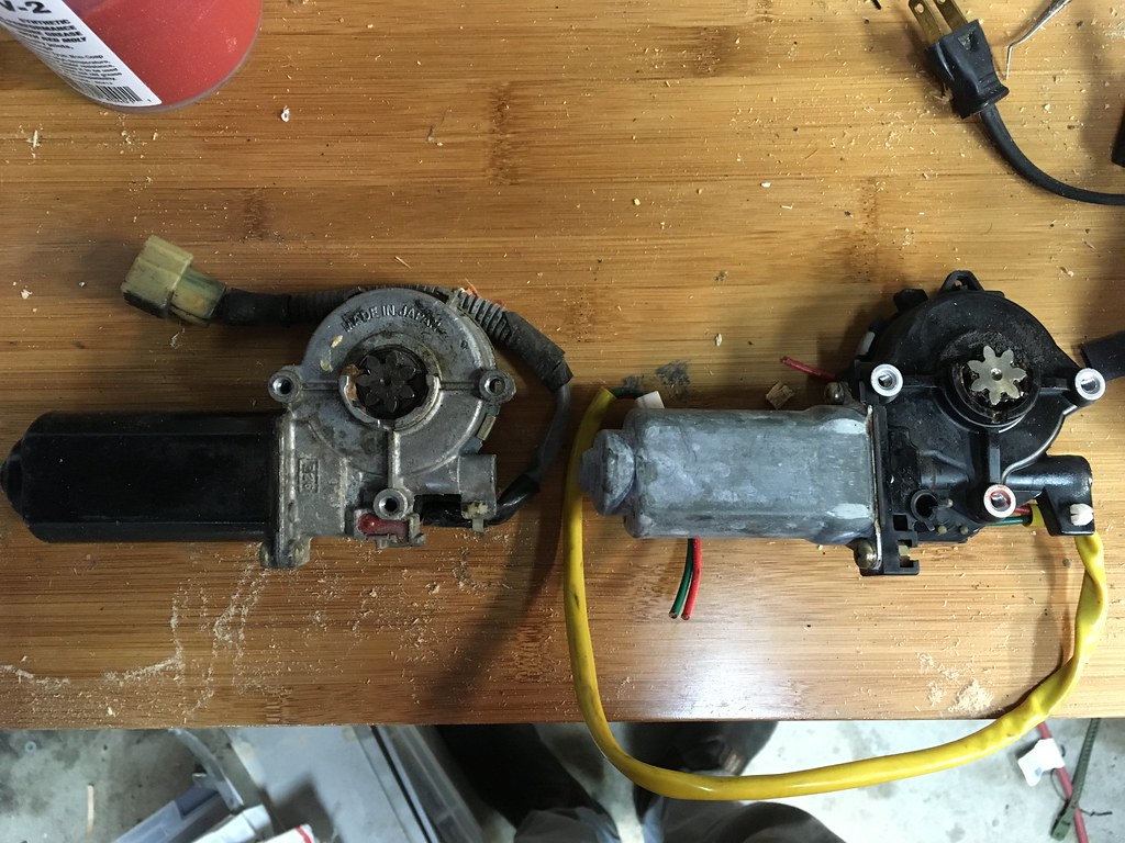

So I just got my hands on a used window motor from a 97-01 Toyota Camry (widely available and cheap used) and it looks almost identical to the FJ62 motor, except for the metal vs plastic gear case. FJ62 motor on the left, Camry on the right. Toyota kept the 3-mounting stud configuration and 7 tooth gear drive pretty much the same for a long time. I still need to make sure it bolts up to the cruiser regulator but I have no doubt it will. The next question is motor strength. I am not sure if they used different motors in the different cars, kinda doubt it, but you never know.

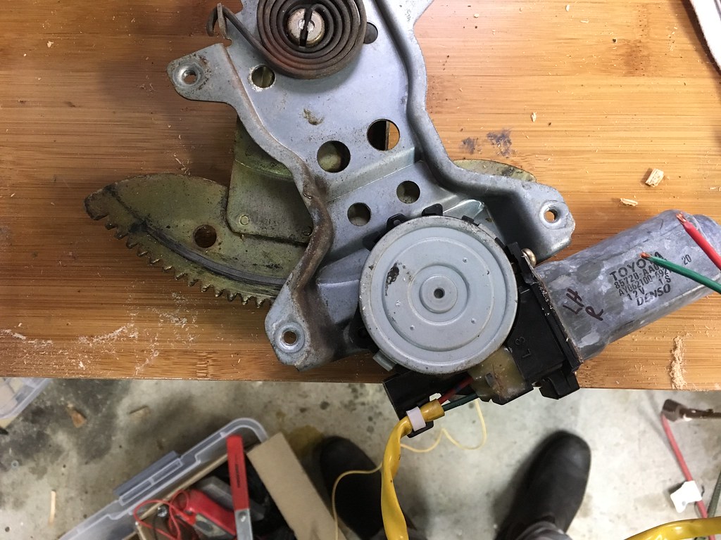

Ok so I had a little time to fiddle with it. Mounted to a spare regulator I have and when powered easily moved it. I wont have time for a while to actually install one and test it in the door so if someone wants to go for it please do and report back. I have a feeling it will work just fine. So the motors used in the 97-01 camry are used in several other Toyota models I believe and may be similar to the 4-runner. Someone should check ;)

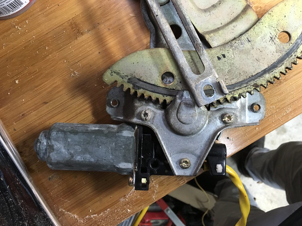

I just installed a window motor for a 1988 Toyota Cressida, Dorman# 742-600 in the driver rear window, Dorman# 742-601 for the right side. Perfect fit. Even came with the right plug! I think all the motors are the same, but the FJ specific motor never got cross referenced. I just ordered three (2 for the right, one more for the left). I'll post if they fit. I greased the regulator, silicon lubed the runs, and I have the fastest fj62 window EVER!
