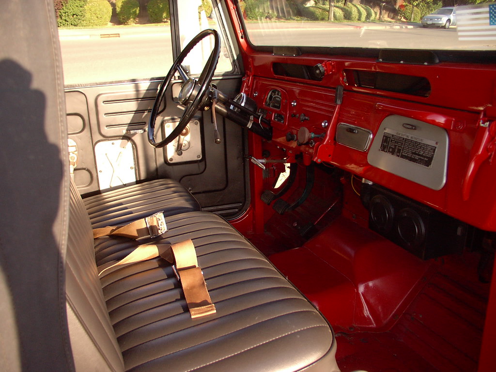

Pics of my old 65 FJ40 :(
Blood sweat and tears went into this cruiser. All I could eat was oatmeal to afford parts
Great looking 40 and 62

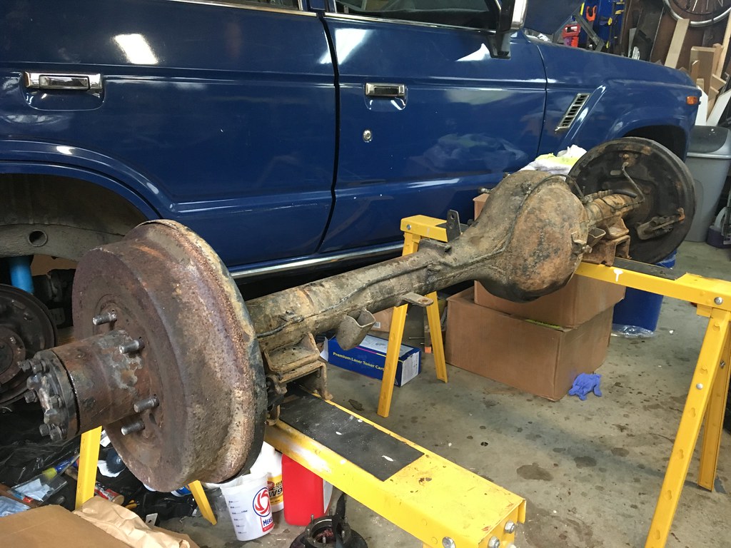

Headed up to BC this weekend with @NookShneer to pick up the FF rear for Blue Guy from @crawlin cruiser, and also deliver a 12ht engine to Tor-fab......... that engine might have to get "lost in transit" :poof: Just kidding Tor! :D
My Tough Dog lift kit will also be here soon and I plan on doing the axle swap and lift installation at the same time. Ordered up new u-joints from @reevesci

After a crazy trip into Canada (more on that later) the FF rear end is resting comfortably in the garage next to Blue Guy:

Better get your butt in gear on that axle Chase. Can't have that suspension sitting there. Plan a day you want to do the install and I'll come down and give you a hand. It may help keep you motivated!
Ha! Supplies are on the way to clean it up. Definitely going to take you up on the assistance!
Full float is one of my favorite upgrades!
