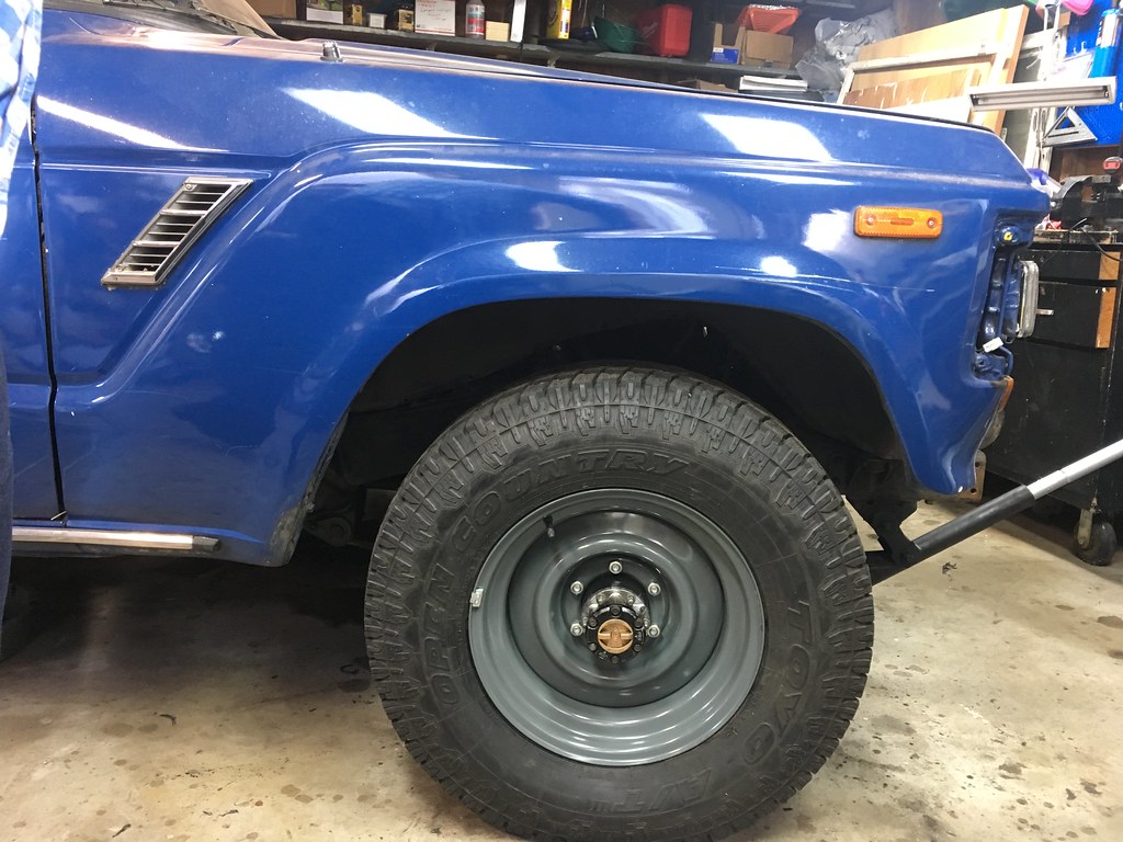

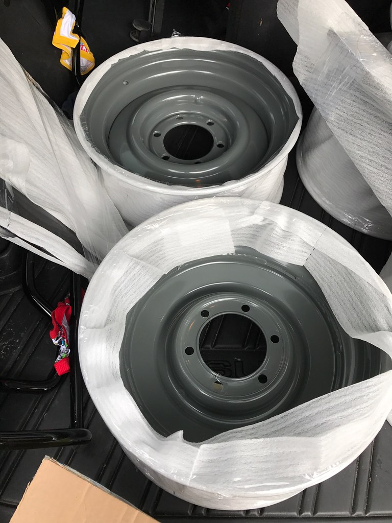

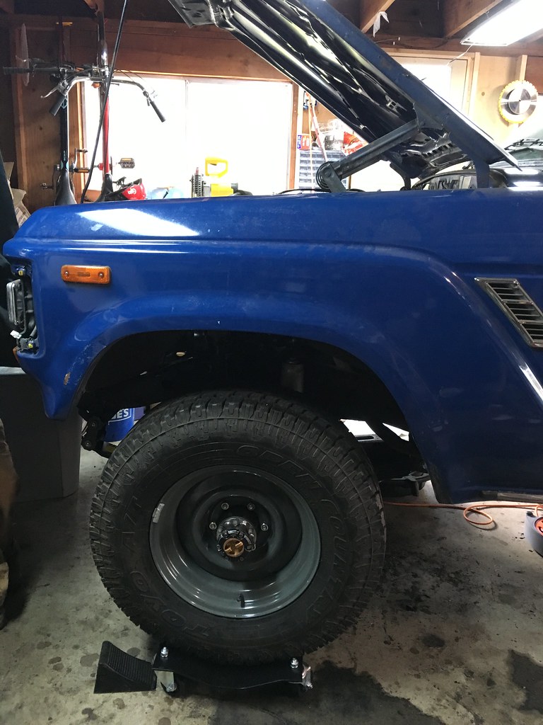

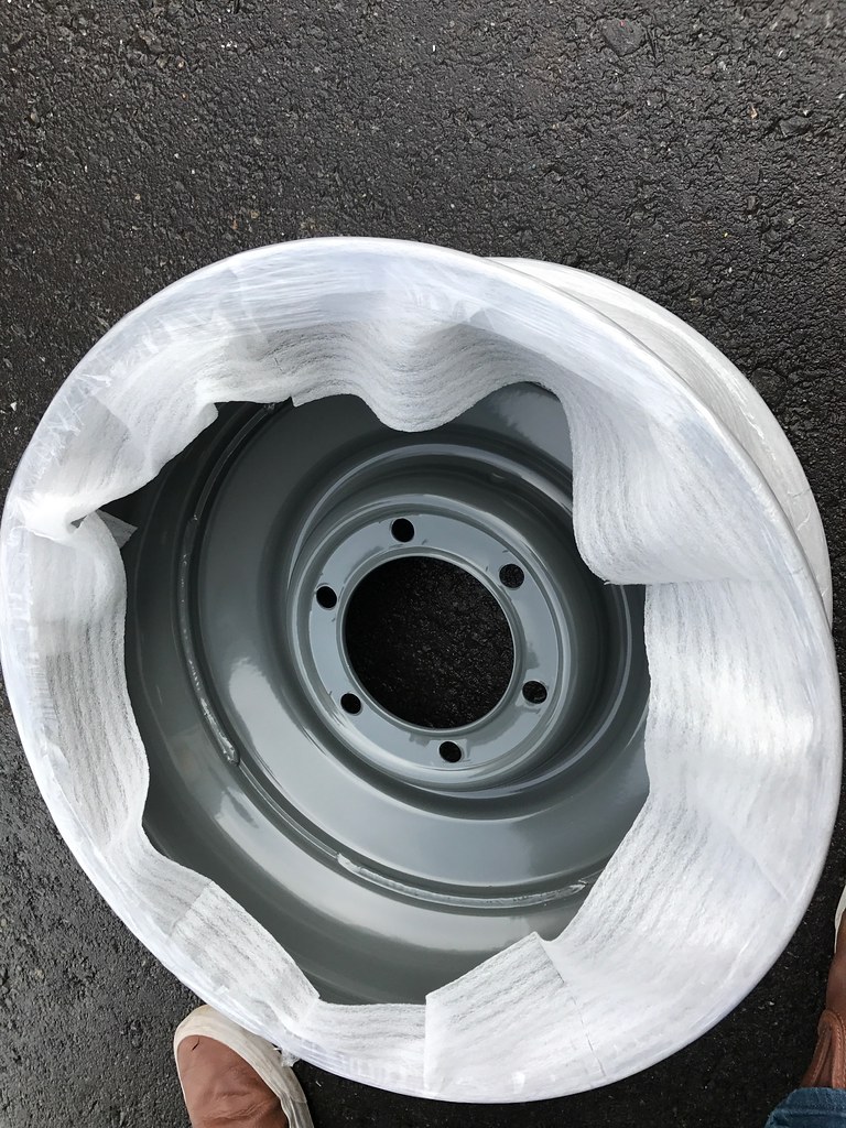

@NookShneer picked up some parts from the powder coaters. The wheel color came out great, excited to see them in person and get the tires mounted!

"Pay no attention to the small underwear between your sway bars"
Hahaha, you know you are a cruiser dad when you use your child's clothes to protect your newly powder coated parts. :D

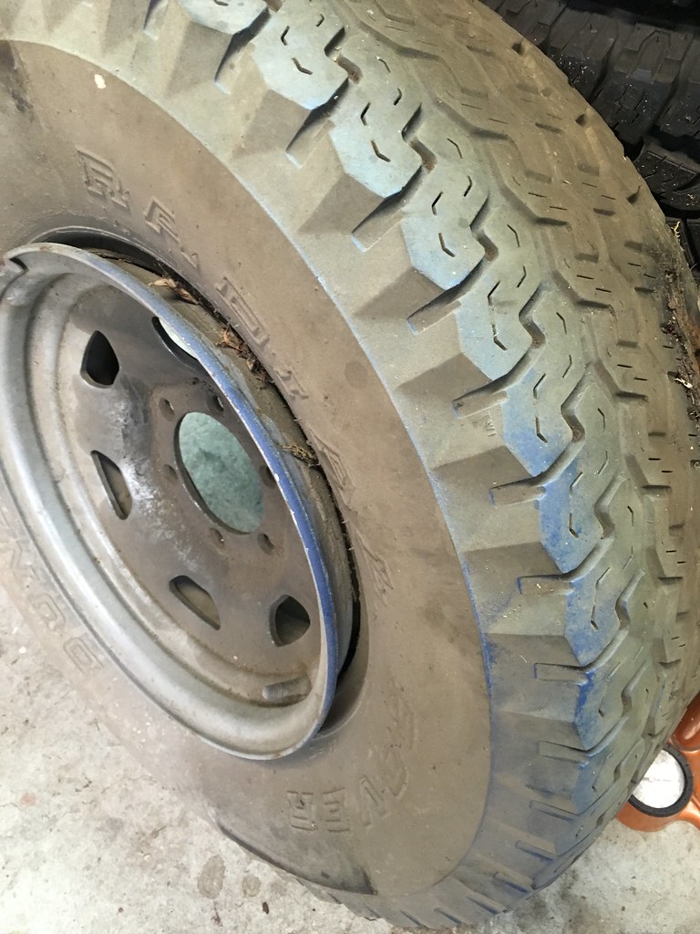

Finally got the spare tire down after soaking the mechanism in deep creep for a few days......looks like the spare is original? Yikes!
And when the PO had the rig painted, I guess they just painted the tire as well! :clap:

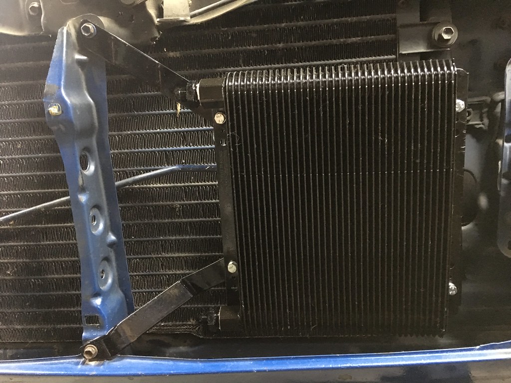

Got the Aux tranny cooler brackets back from the powder coaters. Looks good, now to finish the plumbing!

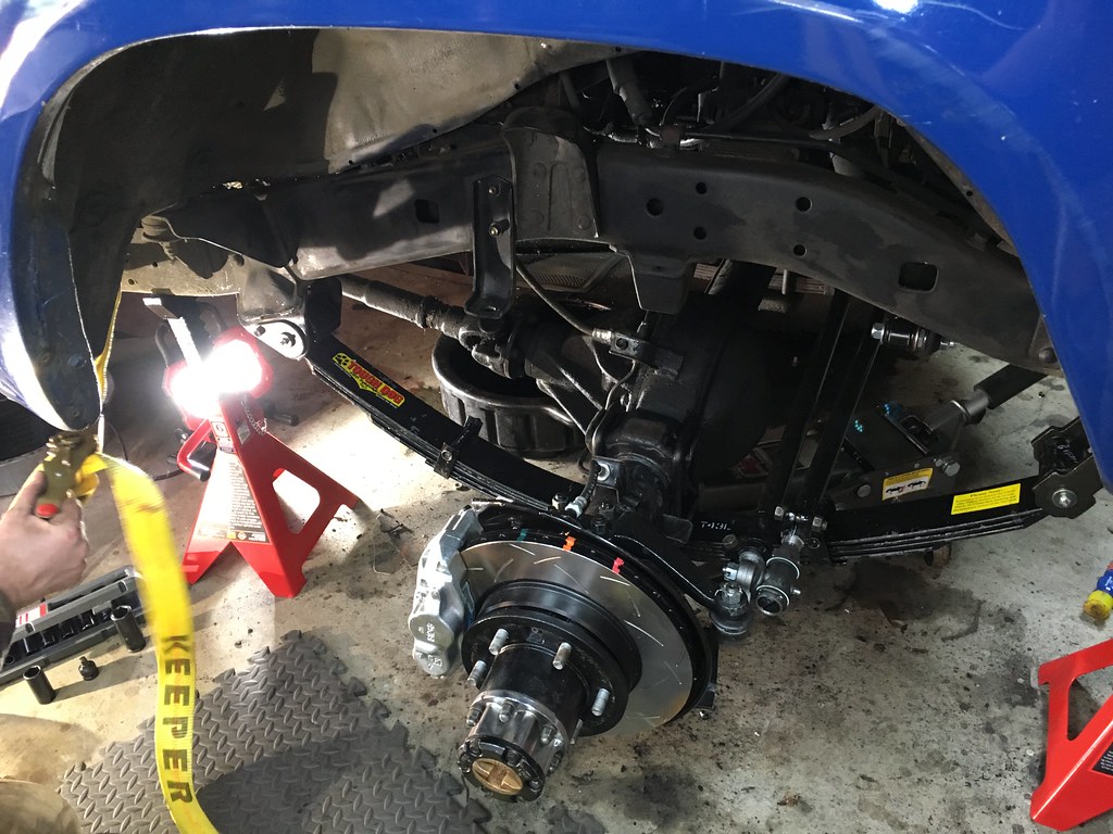

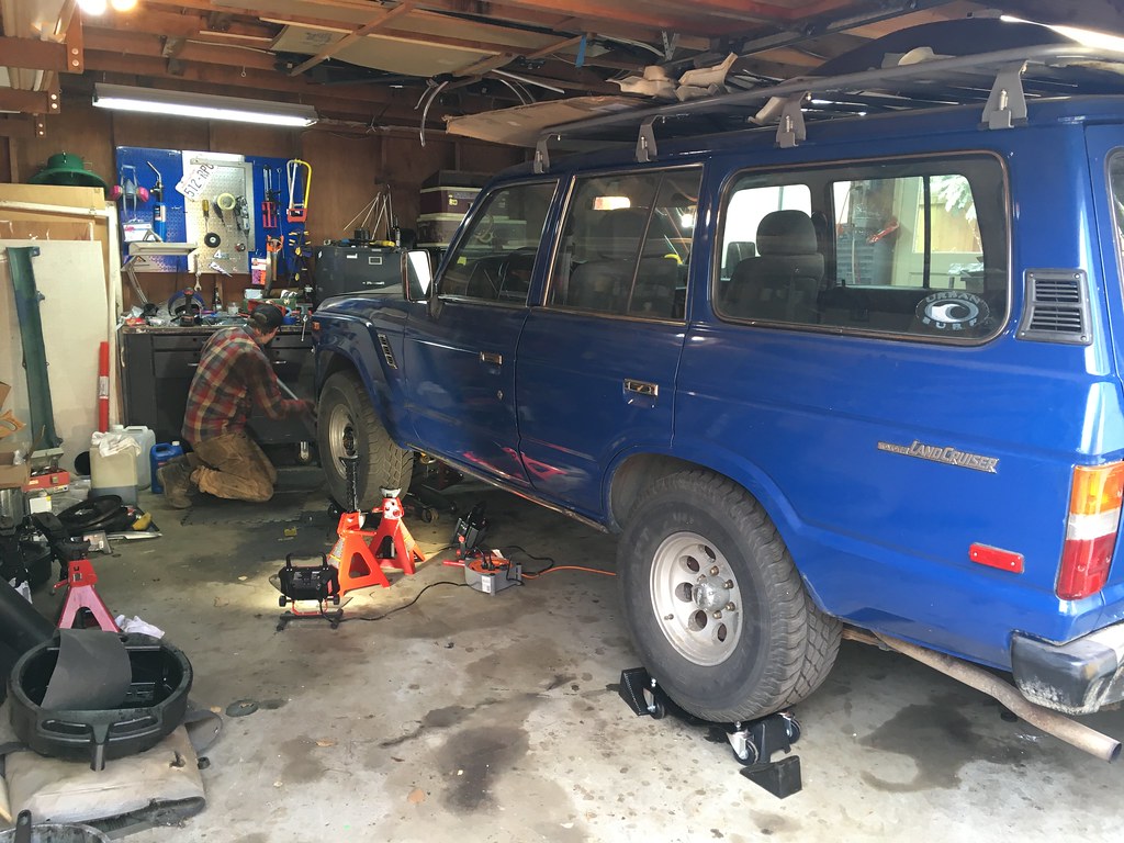

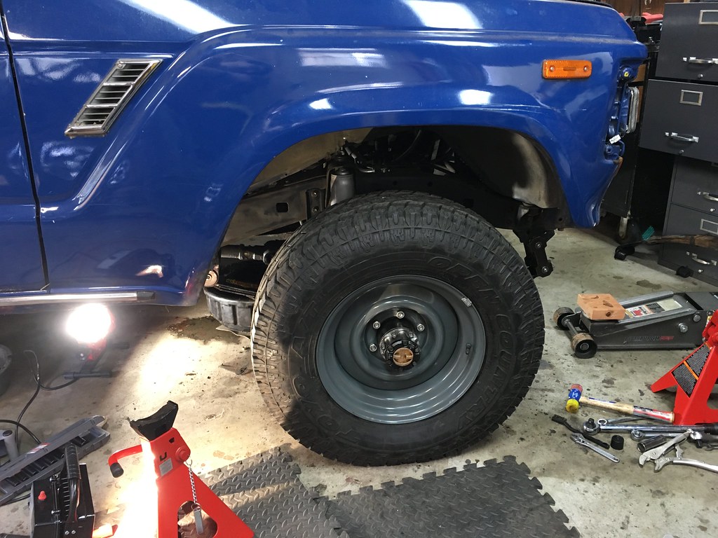

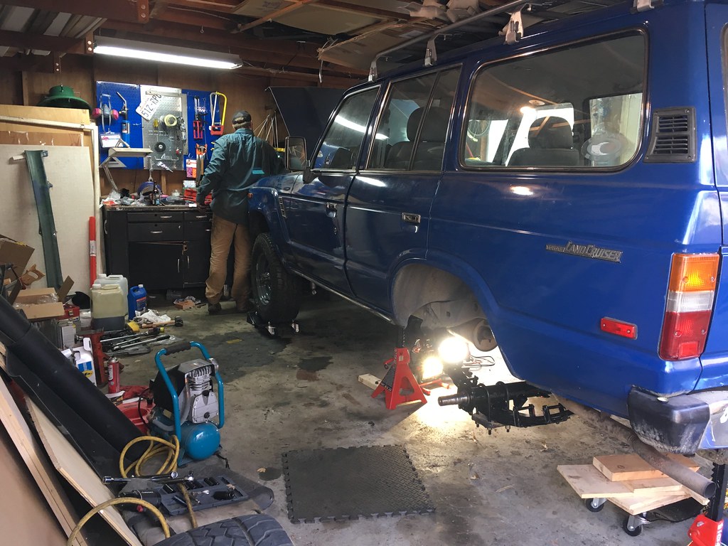

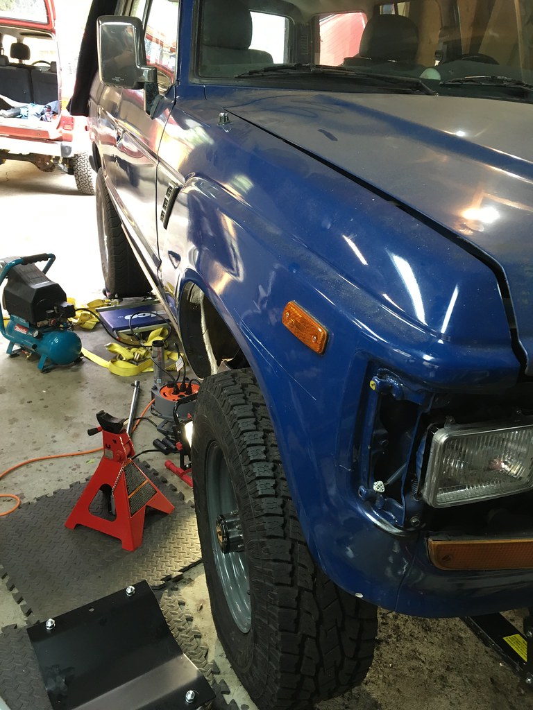

@NookShneer and I installed the Tough Dog suspension today. Went super smooth. At some point in the last 30 years, someone replaced the bushings so they were not originals thank god. I soaked all the bolts in deep creep for over a week. We needed nothing more than a small hammer, a pry bar and punches. We were only able to fully install the front suspension system. The rear will have to wait until I finish rebuilding the FF. We did install the springs though and the painted FF rear housing. Thankfully not much rust encountered, thanks oil leaks! Took us about 5 hours working at a leisurely pace.

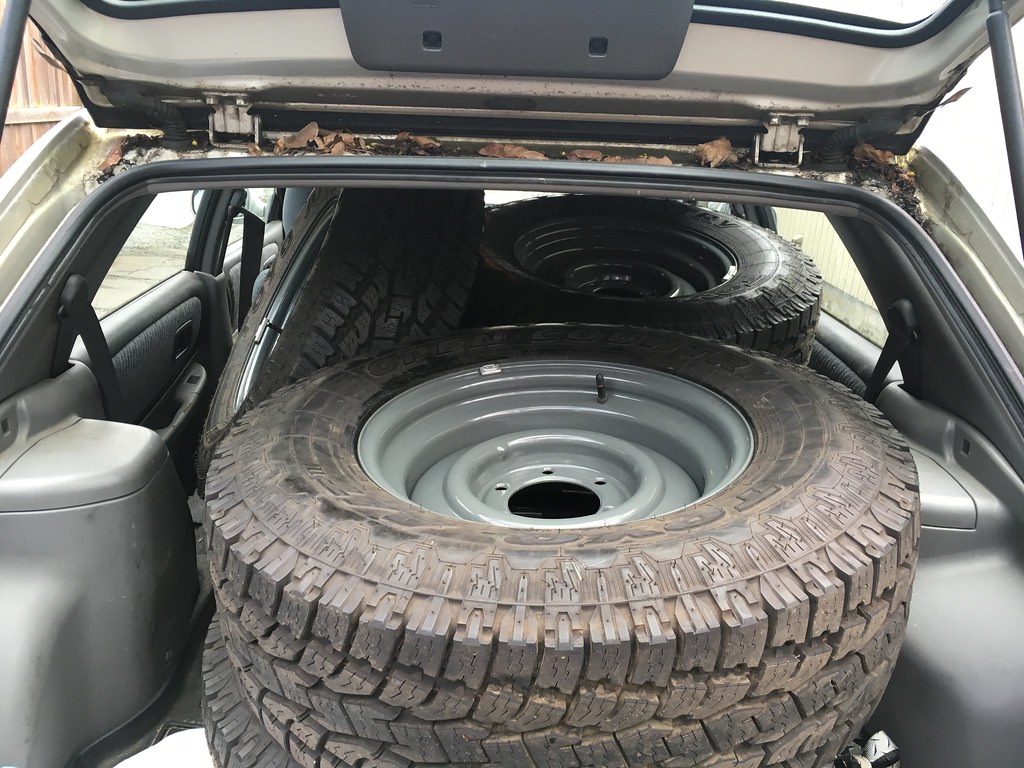

Tire tetris!
Pre-lift shot:

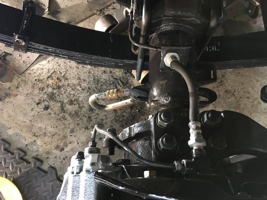

Clever carabiner attachment to pull the axle into position on the leaf spring
Dollies on each wheel made moving it around the garage super easy.

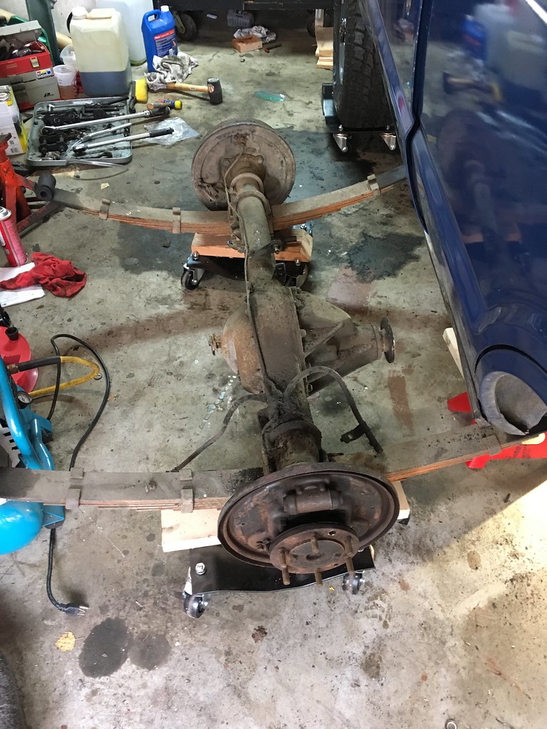

Out with the old!
In with the new rear springs and housing.
