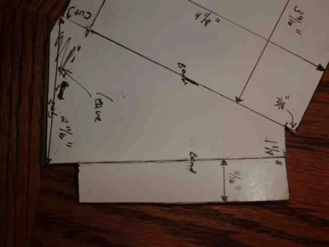

How do I change the file size of the pics that I want to upload? I have the plans to the body suports with dimensions and I cannot upload. Say that the files are too big.

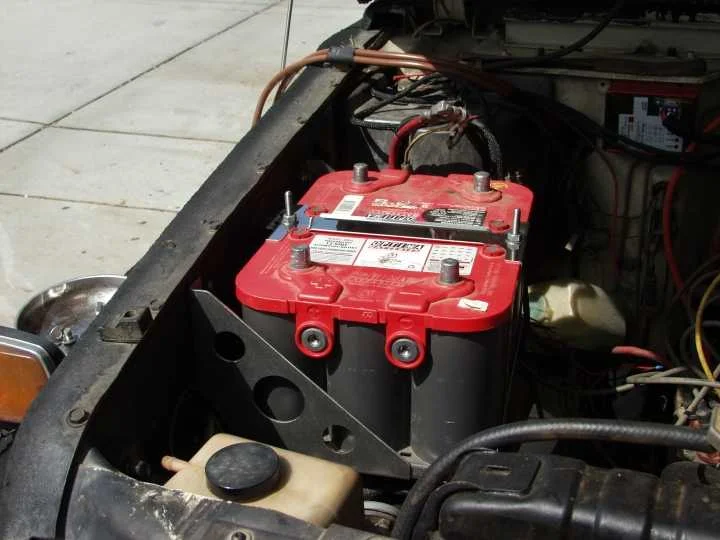

How 'bout a dual Optima battery box, that would bolt into a Pig using the stock mounting holes, and make it outa something that doesn't rust, like stainless steel?
Nice but there really isnt much sense to dual batteries unless you have like 20 lights and a winch and then some non essential stuff like amps and subs.
Gosh, Clemson, this whole Pigthing stopped making sense a long time ago.
But, I think that a pair of big MTX amplifiers (one just for the subwoofer) are essential. Adequate tunes are an absolute necessity for a DD.
The stock alternator couldn't match the draw, so I got a hi-output unit. It came with a matching voltage regulator (that red box with the LEDs, on the firewall in the first pic). Voltage regulator had a wire for a second battery. I had to get a second battery to put that wire onto. Makes perfect sense to me. I may not have 20 lights, yet, but I like laying the foundation for future mods, establishing an infrastructure so to speak, before need arises. Now, with a sh*tload of electricity at my disposal, I can contemplate other nonessential goodies like on-board air, a fridge, a welder, fan & maybe even an electrical water pump without worrying about supply and demand.
Makes perfect sense.
Two batteries may seem like overkill to you. Overkill is my Pigs middle name.
Well rock out Pighead I am all about extra goodies, I am completely opposed to extra weight though. So goodies usually lose out. I dont even have a radio right now. Course my old engine is struggling along so I dont want to make it any harder then I have to.

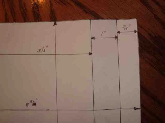

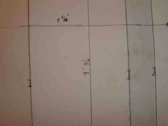

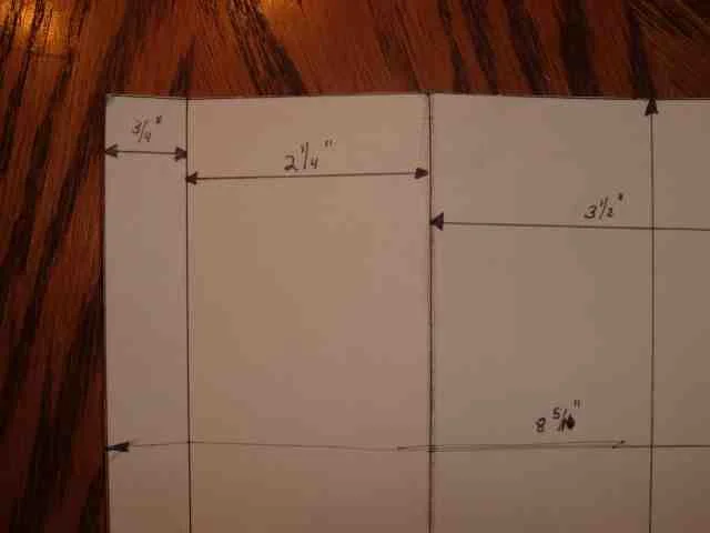

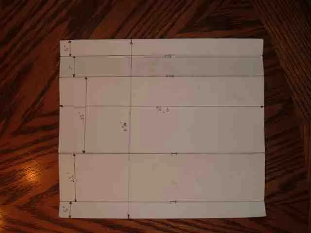

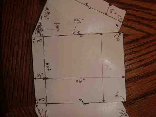

Here are the drawings to the mounts that I fabbed for my PIG. Double check my dimensions just in case I goofed.
