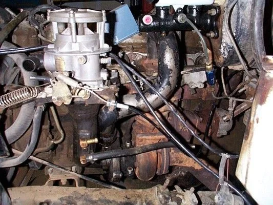

GLTHFJ60, I currently have a turbo 2F in my 40. It is a super easy swap.
here is a really bad pic of it.
"wet" system using a T04 and a single 3" exhaust sytem.. The thing flat out spanks..
attachment.php
Agreed, it is a bad pic. HAHA!!
That is a cool setup. I PM'd you.
Where did you buy that? Stock Manifolds? Hopefully? Fabrication? Total Cost? Smog Equipment?
attachment.php
you adapt this TBI inyection system from ..? and you adjust the Garret T04 to more psi ..?
