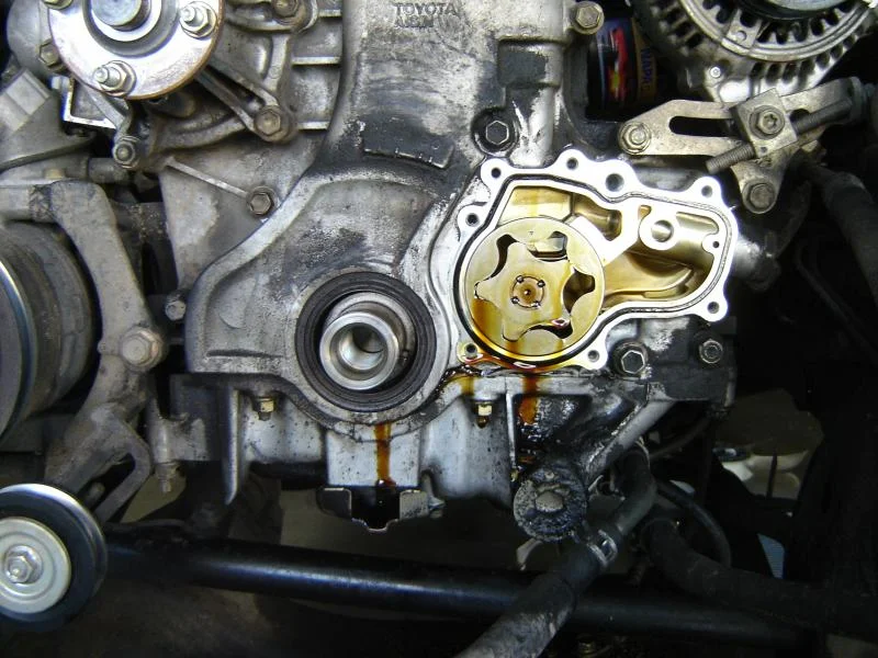

Got the CS pulley off today. Should have the new seal for it tomorrow. Hopefully the guys at reno toyota ordered the right one!
Hang in there Matt, YULE (Christmas humor) be back driving it in no time.
The CS bolt wasn't bad. I went to sears and bought a nice 3/4" breaker and some metric impacts at HF. Used the starter method to break it free.
Trying to make some progress on this thing.... BIG thanks to Ray (RAYJON) for all his help. Thank you jack for the oil pump goodies (and other parts) and thank you Will for letting me borrow the monster torque wrench!

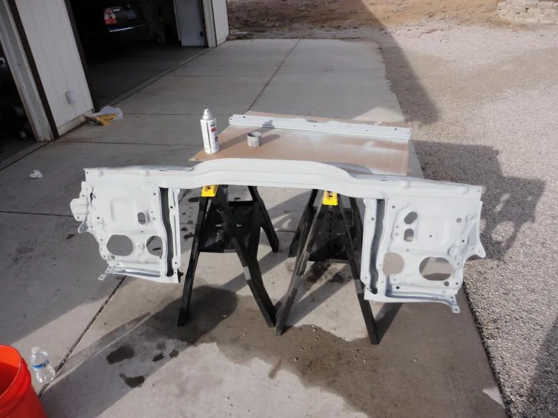

some progress pics. Cleaned the pieces, sanded them, primed, sanded again, and waiting to add another coat of primer.

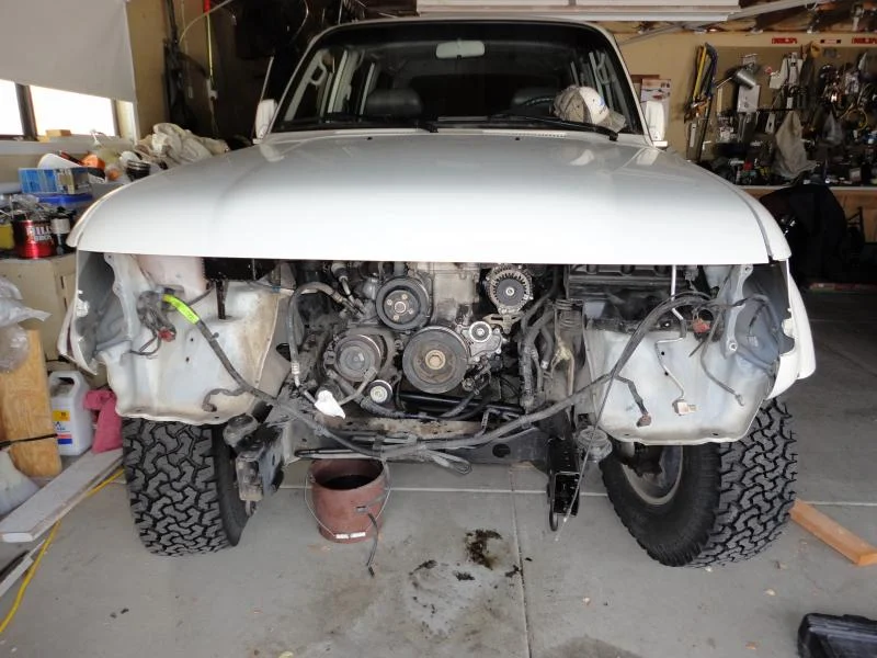

Went over to Rays house this saturday and painted the front support, knocked out the fender dent, and worked on the fender flare. Thanks again Ray!!:cheers:

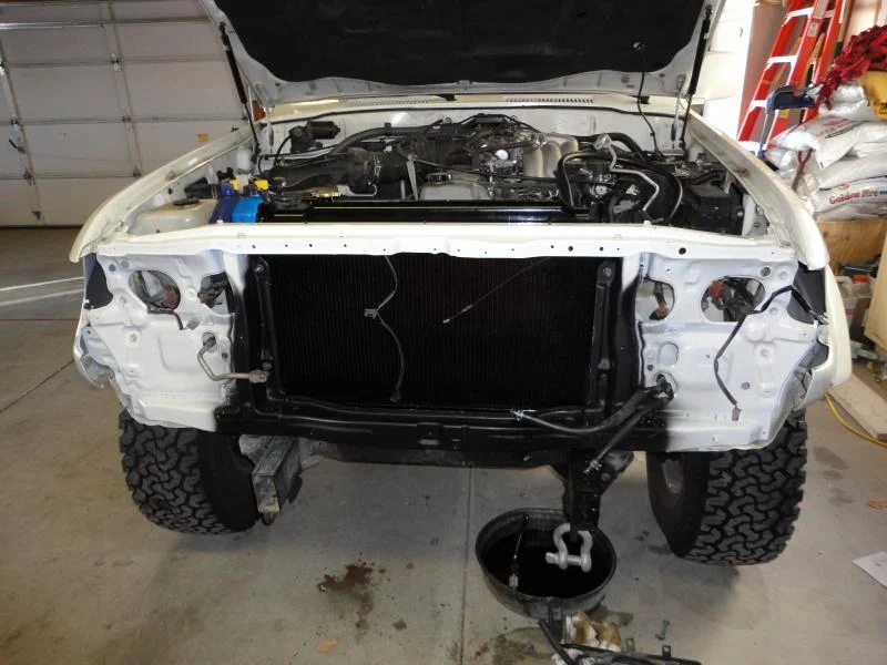

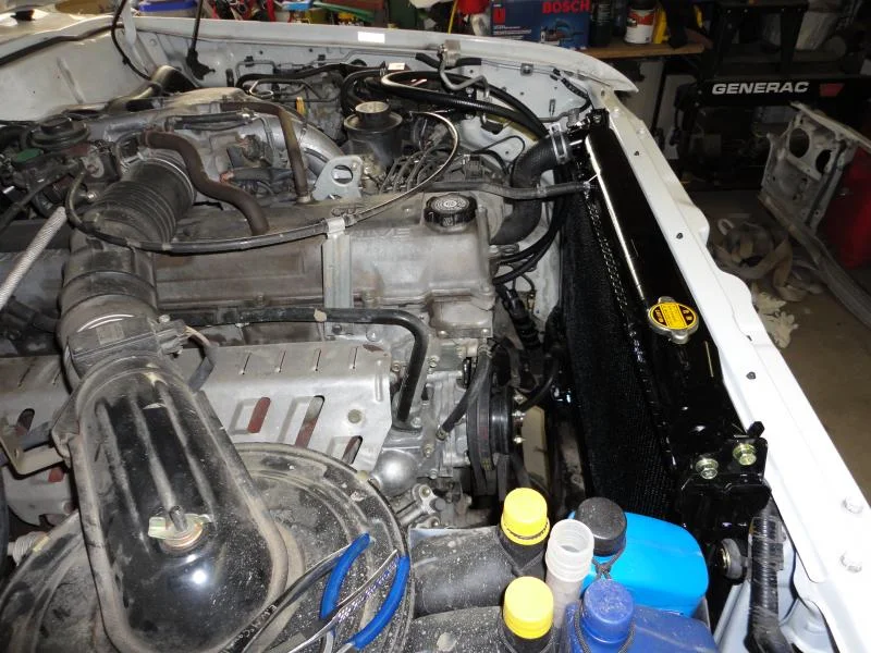

been making some progress this past day putting it all back together. Im kinda slow, but I want to make sure everything is in order...
The AC condenser is from an older truck, so the newer 80 fittings are too big. If anyone has a friend that is parting out a truck (maybe 95-97) then let me know! I'm going to check the classifieds...
