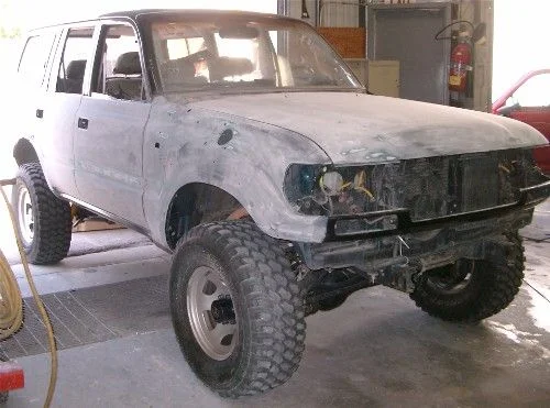

The old gal needed a bit of a nip-and-tuck so I spent ~11 hours on Sunday de-trimming her and prepping her for a trip to the paint shop for a tuneup.
Beno dropped by to lend a hand with slider and bumper/winch removal before he had to head off to work. I did the rest.
De-trimming and pulling armour off netted almost 2 additional inches in lift..:eek: In addition, it's pretty damn quick.....:hillbilly:
My body shop buddy says I'll have her back by a week from tomorrow so I can re-assemble.
Yes Beo, I KEPT IT 6M1!............:flipoff2:

305/70/16 Dunlop Radial Mud Rovers (33-12.00-16)
The lift is OME 864 and OME 850J with a 1 inch Tools-R-us 6061 spacer.

I left the headlamps and tail lamps in for the trip to the shop. Due to the extent of the stripage it only took a few minutes to get them out of the way upon arrival.

And BTW, I thought I was the only one who stripped all that stuff off the vehicle before I get it painted. It's the only way to avoid the peeling paint where they mask around lights and trim.

The only correct way to refinish a vehicle is to eliminate EVERYTHING that comes in contact with the panels that are to be refinished. I have operated under that procedure for over 30 years. I feel that you should be able to remove ANYTHING without revealing the fact that the panel(s) have been refinished. To do less is the same as taking a shower and putting your dirty shorts back on.
Cheap bastards mask, pros strip.
