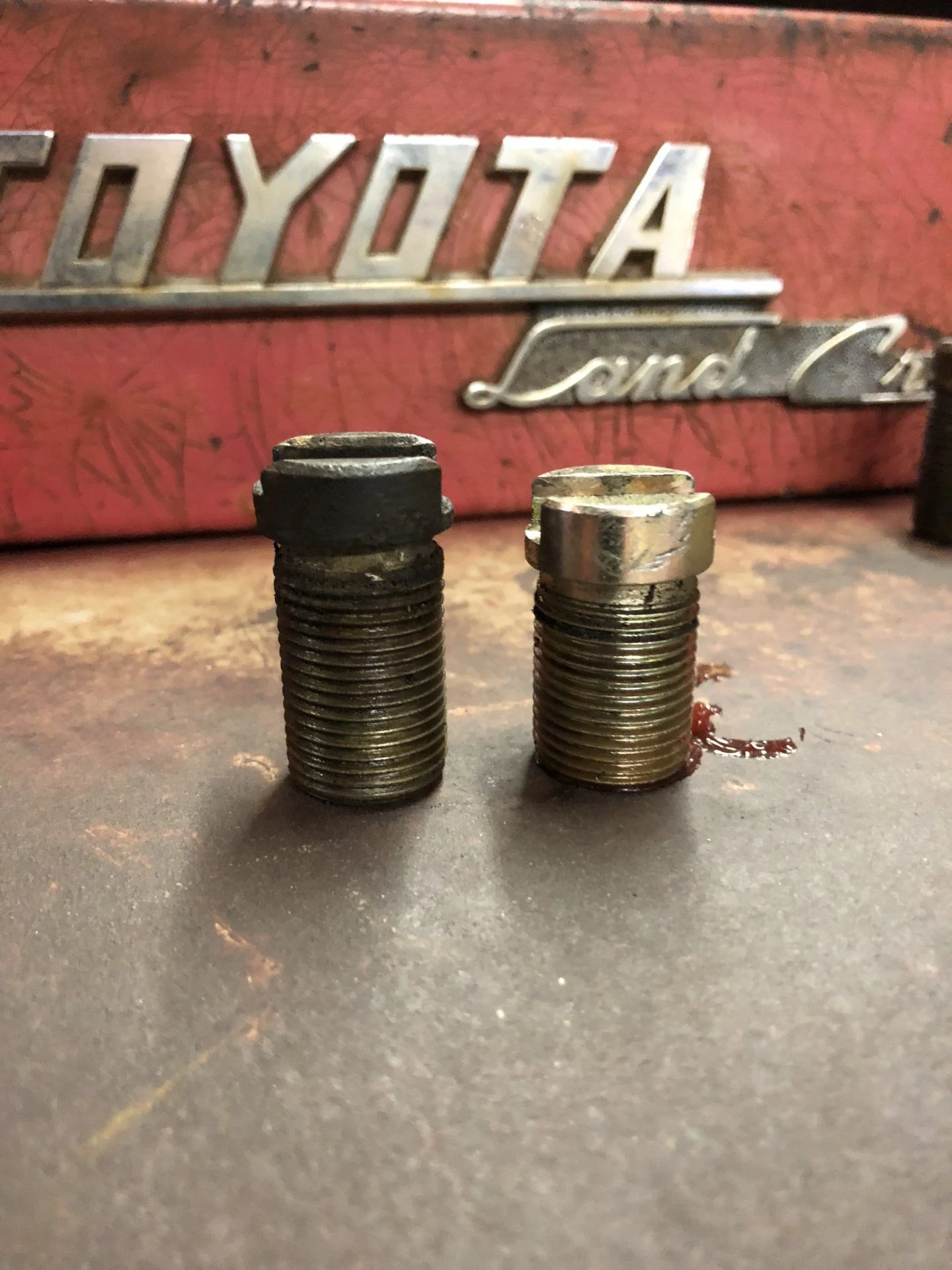

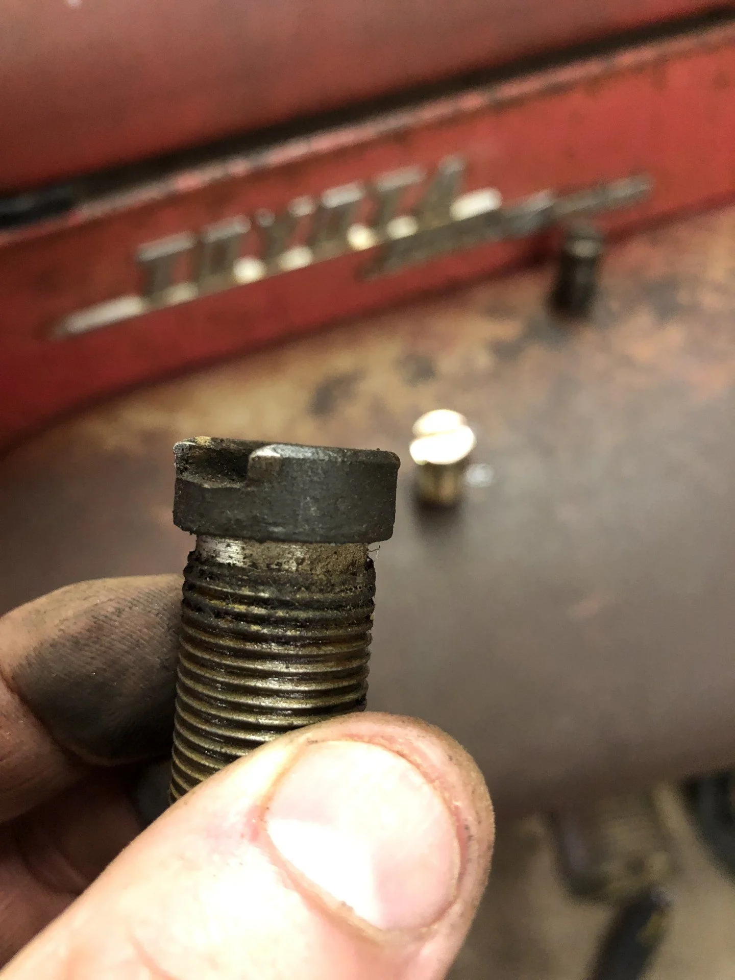

After a 10 day trip I was ready to try the ramped adjusters on the Goat.
I got in there are replaced them and snugged up the adjusters to where the fronts turned by hand but would free spin about 1/2 turn without stopping.
And took it out for a spin.
With the proportion valve fully open (which makes the rear brakes have less pressure) I have full 4 wheel, mostly straight lock up.
AFTER one pump still.

Figure 7-5 on page 7-8 of FSM shows both springs behind shoes. And I heard from many sage mechanics to put one in front and one behind. So of course there’s a lot of confusion and debate about this. :bang:
I think I have the answer here.
I’m not sure what year the brake nails came into play but in 1967 they were not used.
I also found that I had none in my box of Brake crap. I was going to add them this morning
Well, without nails , the shoes will not stay against the backing plate with one spring forward and one in back.
So. On the early, pre nail shoes, both spring to the back.
I’ll get motivated one day to get rid of this one-pump brake system and when I do I’m going to add pins and new springs and see if somehow that helps.
