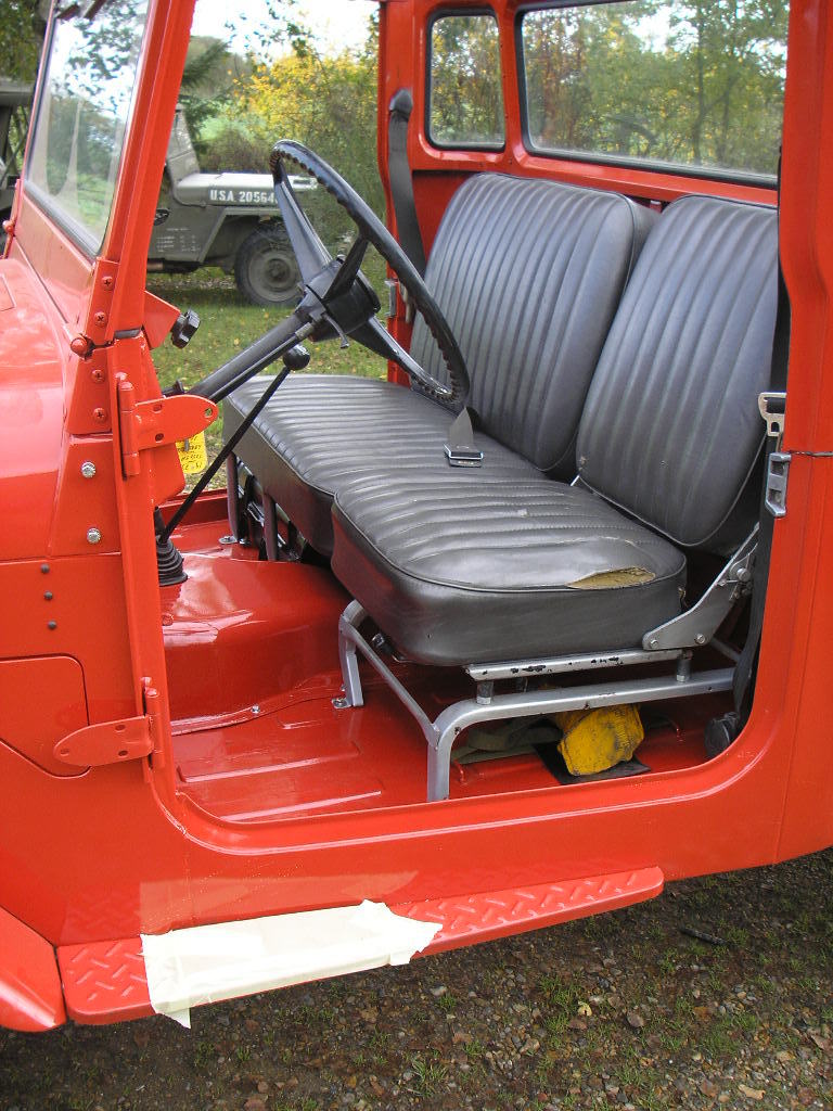

and my seat when I bought (Nov. 2006) the Red.
All I did... I taped a piece of grey leather on it and saved millions of bucks :)
meanwhile the seat got some grey tape at some scratches ...
Cheers Peter

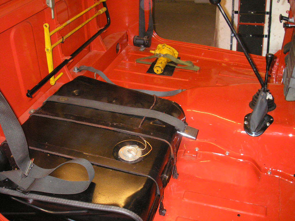

When I picked up the truck Tom said the fuel tank had a leak. I cleaned up all around it yesterday and found no sign.
Anyone that has dealt in these old tanks knows they are easy to remove but getting a petrified vent hose off without breaking always fails so I was pleased that the tank was not leaking as far as I could tell.
Last project of the day yesterday I popped the sending unit off to see if the tank had rust in it.
3 things.
First, there was no gas in it. None. I guess I’ve been driving around on the last sips of gas and what’s in the humongous glass bowl.
Second, the tank was beautiful inside. No rust. Simply remarkable.
Third and last, there was no sending unit gasket so maybe that was the gas smell @JasonH was reporting.
I dumped 3 gallons of non ethanol in it last night and put it to bed
This am there was a wet spot at the back corner of the tank. Bad? No, but let’s fix this while the seats will be away.
Now to get this all out without breaking anything
Nolan, yes these tanks always seem to leak. It's almost always on one of the seems. The lead that Toyota used to seal the seams was the old soft type. You will need some old time lead like we used to have in the barn or shop.
I have had SOME luck with re-sealing the seems with new lead in the affected areas. good prep and cleaning the area can't be understated. . It's just a trial and error.
When the tank is out look closely inside. I have found the gas cap chain in every tank I have cleaned. Just found this in my 66 FJ45. My tank is seeping as well. Im having it sealed this time.
View attachment 1601555 Nolan, yes these tanks always seem to leak. It's almost always on one of the seems. The lead that Toyota used to seal the seams was the old soft type. You will need some old time lead like we used to have in the barn or shop.
That’s so cool. Thanks. I’ll look.
I’m really happy about the leak becAuse I got in here and cleaned it up and will treat it all
Amazingly good condition under there. The tank looks good. Some surface stuff.
I’ll goop up the seam as good as I can with what I have. Thanks for the tips on the lead. I’ve got lead solder rods. May lay a bead of that first. Can’t even see the crack.

The tank is in unreal condition. Seam seep be damn. 50 years. Crazy.
I left the gas in to see if any of this leaks. Looks like surface only after I polished on it
Seems like this is where my seep is.

Funny, I'm in the same place you are with the tank. Mine was in good shape as well but got sent to the shop for coating. Thought I would try that this time around. All surface rust here as well. Mine had seatbelts so no... Plugs. I was able to get the vent tube off without cracking..... Just lucky....

Did you have any padding under your tank? I had three pieces of closed cell rubber type material under mine. Not sure what to re-use when I install the tank... I'm not sure what was stock but I would assume what I had was original.

No on the pads. I guess it survived this long without them so I’ll leave them off on reassembly.
It does have the OEM rear pads which is crazy they survived. Rust inhibitor has cured.

I think the tank hold straps had a dense felt material as pads. I think. Mine does FWIW.
And I’m thinking of using the Eastwood fuel tank seal kit in mine. Cleans, converts and seals from the inside. My tank has dried chunks of ethanol in it, other than that I think it’s solid. Will need a new gasket for fuel sender (thanks for number Mark) and a new float (I’m going to use one from another sender, not brass though like original). Need to check ohmage first though for functionality.
