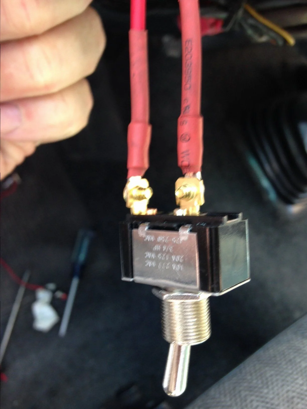

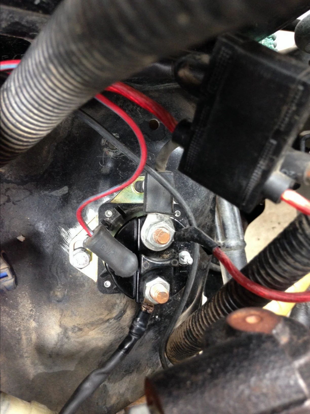

This is a pretty straight forward modification. Some people call it a "Wilson Switch"... Basically, go get a FORD starter relay (that some folks call a starter solenoid) from the salvage yard or NAPA or wherever. Get a Painless switch that is spring loaded to the OFF Position (Momentary Switch; Part#80501). Wire this up on its own circuit. Works Fine & Lasts a long time. You'll be glad you did it.

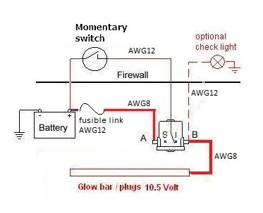

@NickPapagiorgio, pretty much yes to all of the above. Here is a diagram I stole from someone else. Starter Relay body grounds to the wheel well or wherever you mount it. Just sand off some paint from the body to get a good ground. Just by-pass the entire super-glow system. Your left finger will control everything now. About a 4 second hold on the Intermittent switch should do it on all but the coldest days. Then I do about (2) 4 second holds about 30 seconds apart.

If you used a Ford Sarter Relay, sand a bit of paint off of the wheel well or where you bolted it too. That is where it grounds. That could be the issue if you don’t hear a click.
