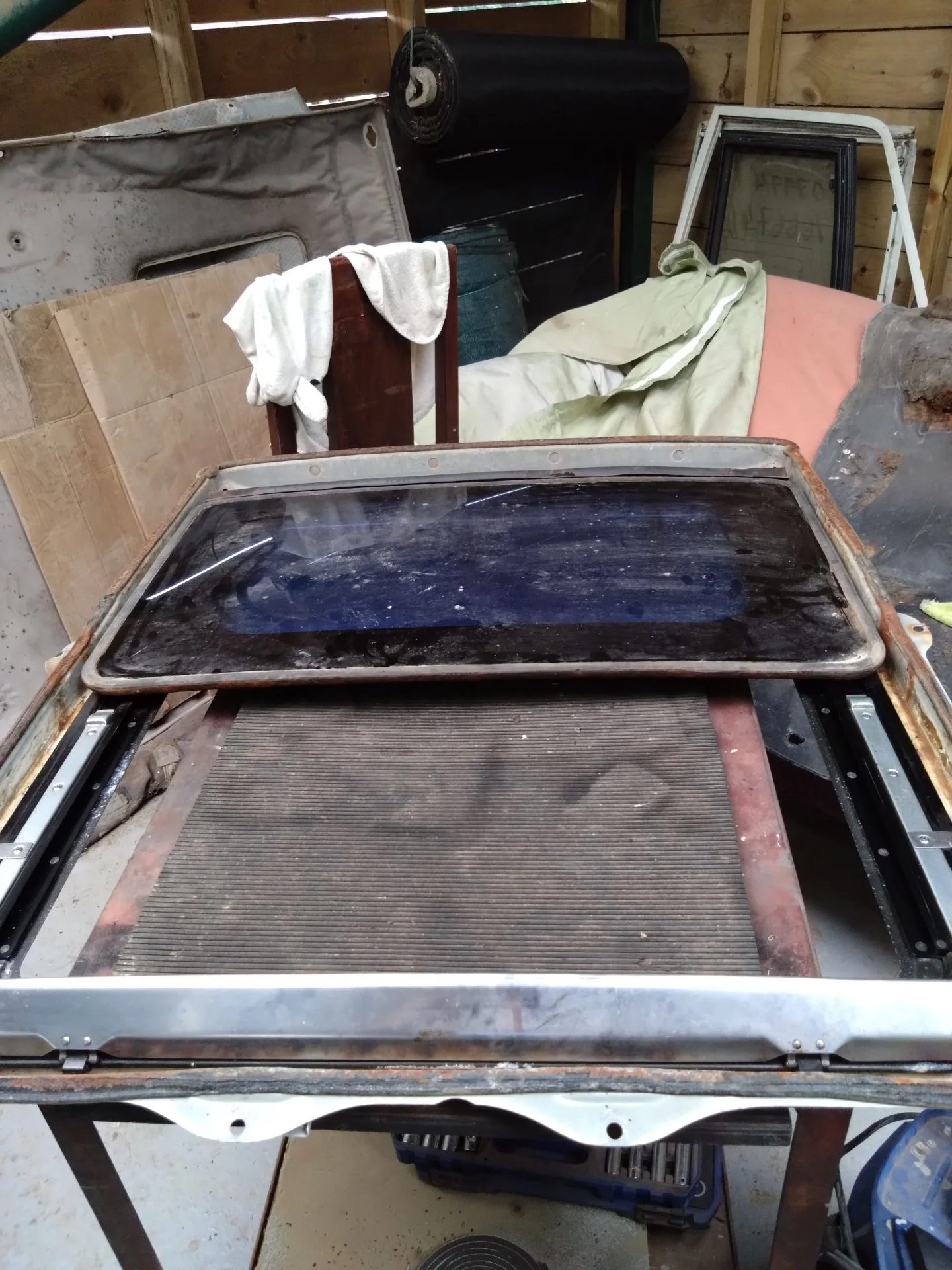

glass sunroof rubber seal (1 Viewer)
It looks like a big job but at least the outer seal is still available. 63252-60010
Thanks Ill have a look see if that fits
its out of the donor car so may as well do it now.

That number 63252-60010 looks to be the weather strip for the metal frame that supports the sunroof, im looking for the seal that goes on the glass . like the dude did in the link above

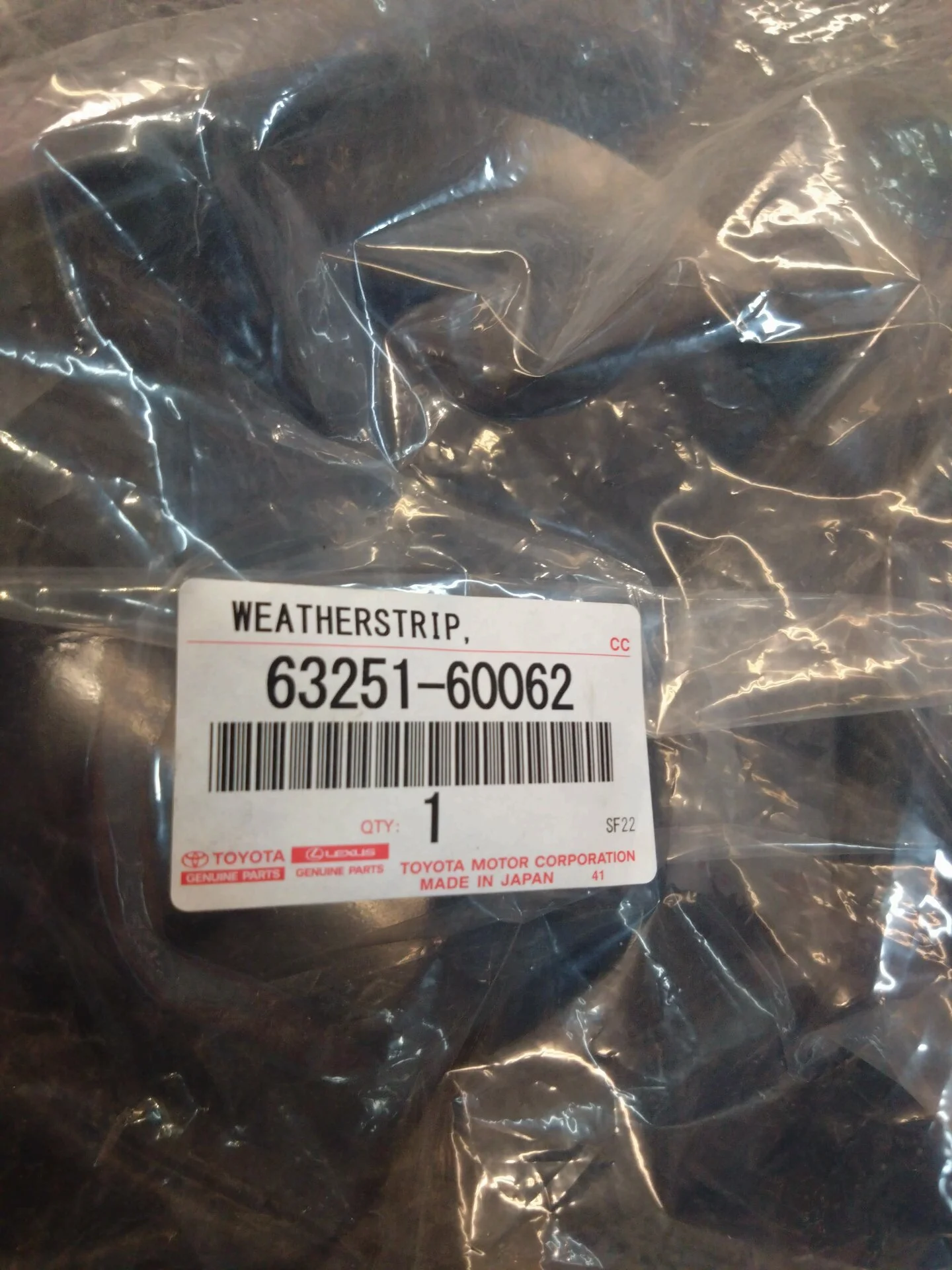

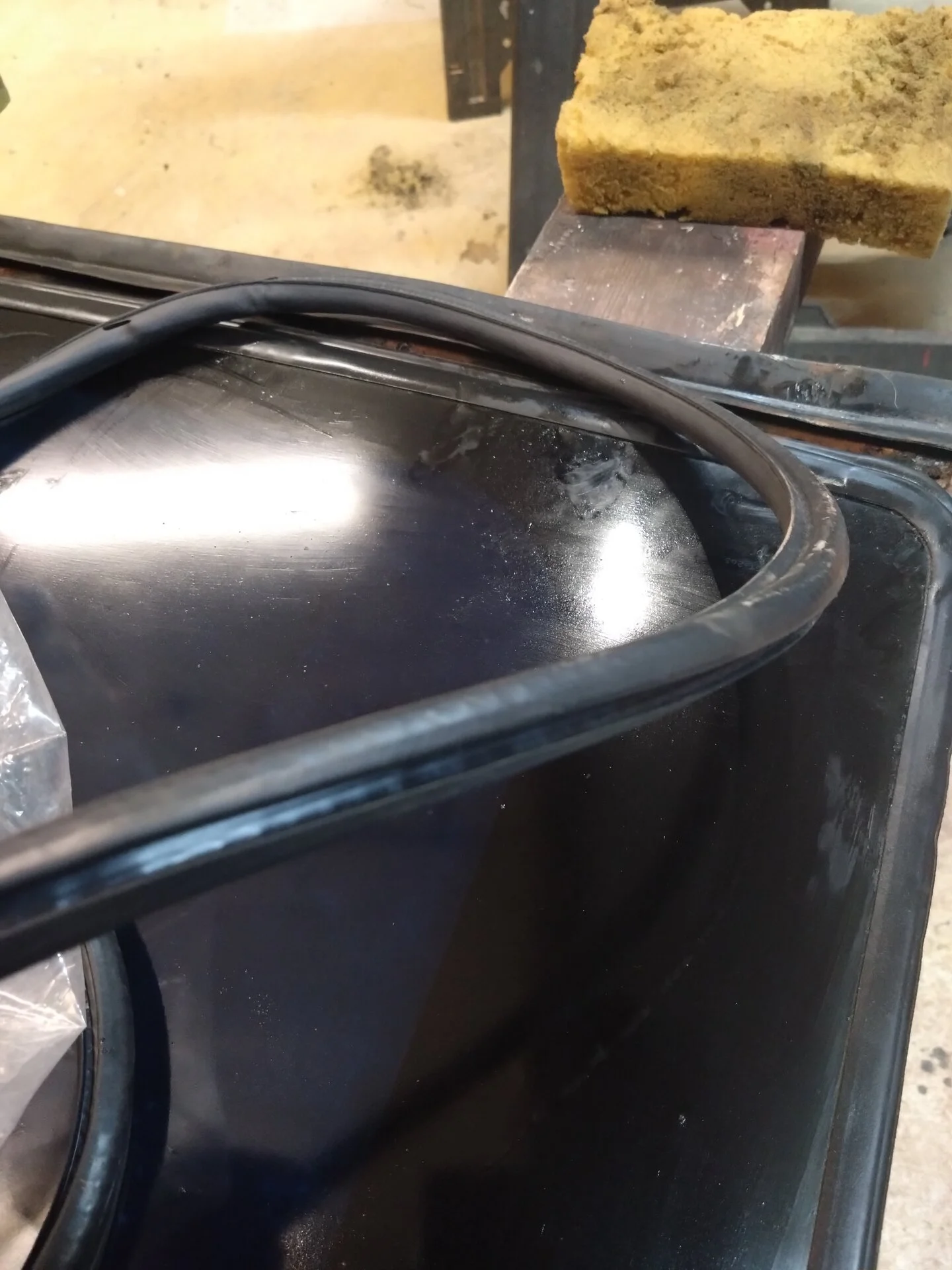

So here it is.... I Ordered 63251-60062 and it doesnt fit!
Looks like the original seal has this rear flap attached to it and the new seal is a different profile and doesnt have the flap .
Dammit!
