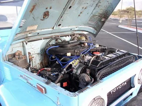

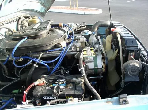

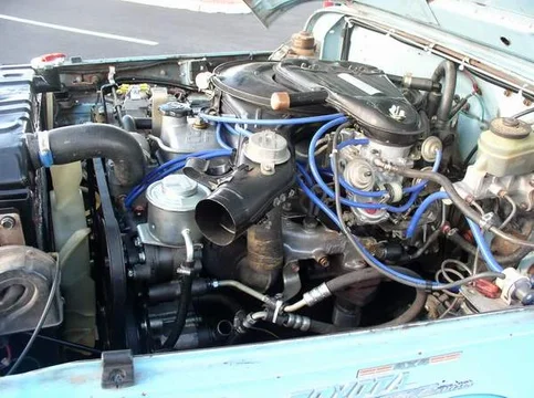

Getting Close to Done (For A While) - 2F in & FJ-60 PS Mod
Sep 16, 2002
134
1,773
Tucson, AZ
Finally seeing the light at the end of the tunnel...
Here's the PS Install - Links...
IH8MUD.com - View Single Post - FJ60 Power Steering Conversion for FJ40 while keeping air pump
Hope to see you guys out on the trail soon...
Chuck

Looks good! Nothing like a new 2F in a older FJ40, and the power steering is great, I agree. Any issues with the install? Are you running a 4-speed?
Only problem I had on the install was dull Harbor Freight taps (resulting in 2 broken tap handles). It pays to go with good steel on your taps, and a problem fitting the Intermediate shaft to the FJ-55 steering column.
Other than that - it was just labor, with no technical challenges. My buddy is the master of "fab", so I brought the beer, and he did the skilled work.
My truck is a '74, so it came with the F-1.5 motor, and the 4 Speed stock.
