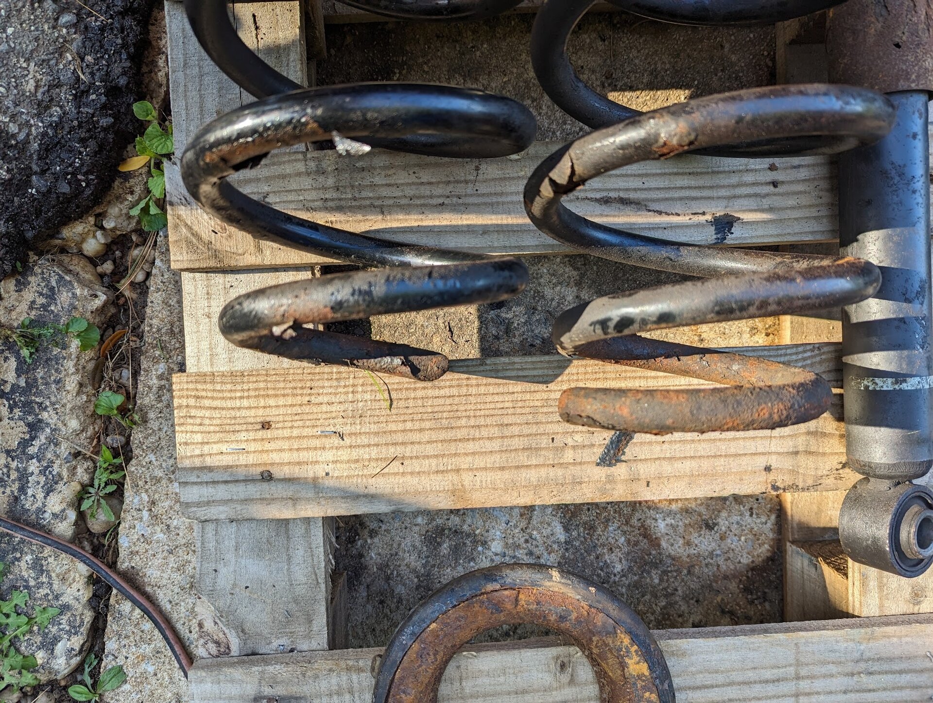

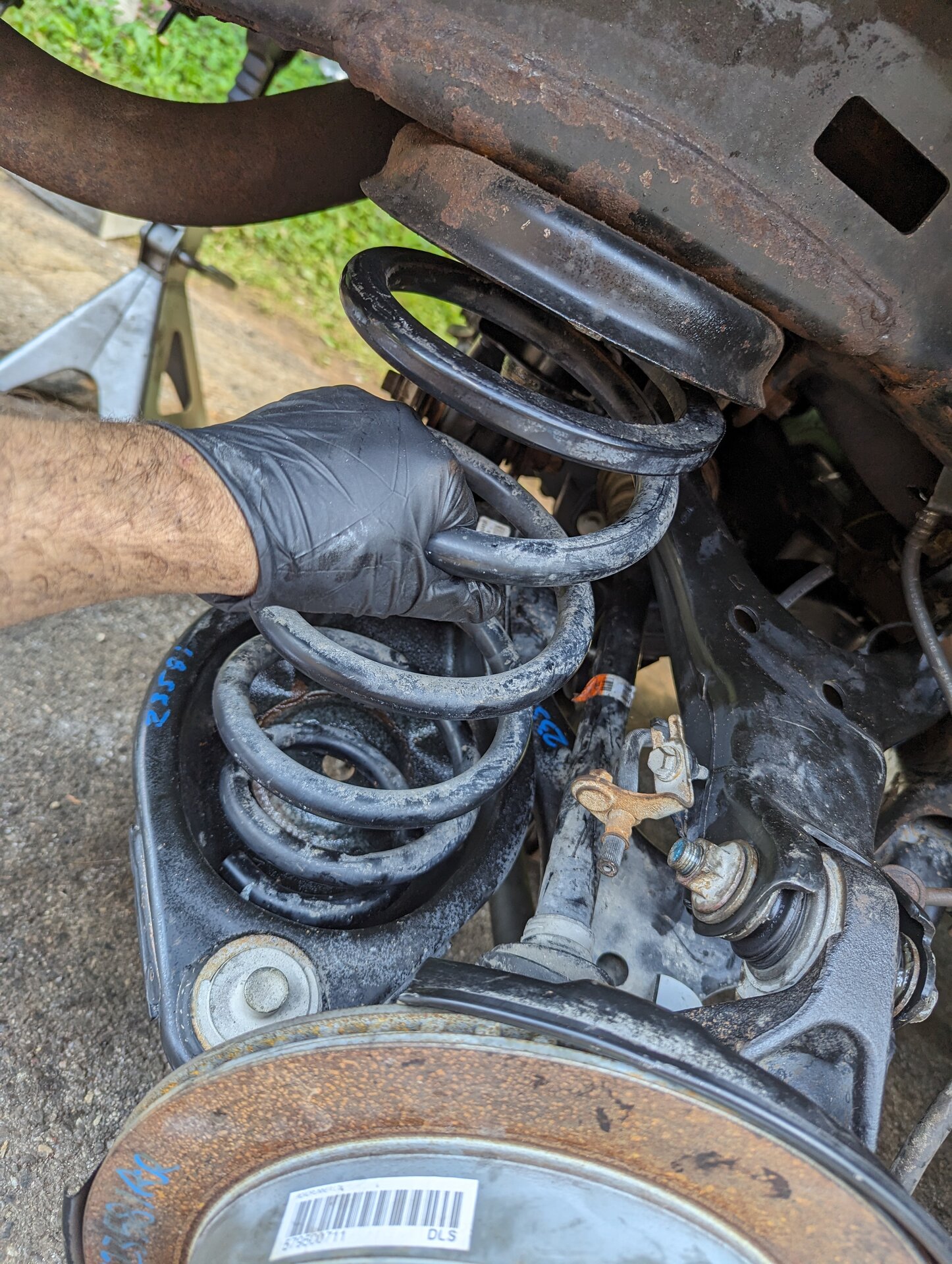

I forgot to buy one of the nice spring compressors before this project and I saw your post on using the rental spring compressor from autozone. After a accident using a floor jack as a compressor on my first car as a teenager am terrified of springs. I was able to get one side off using the autozone compressor and the other side just fell off when i cut off the shock because it was broken just like yours. My long term plan is to put dobinson 2.5 springs in the back so I invested in one of the heavy duty side mount compressors that should be here for reassembly next weekend.

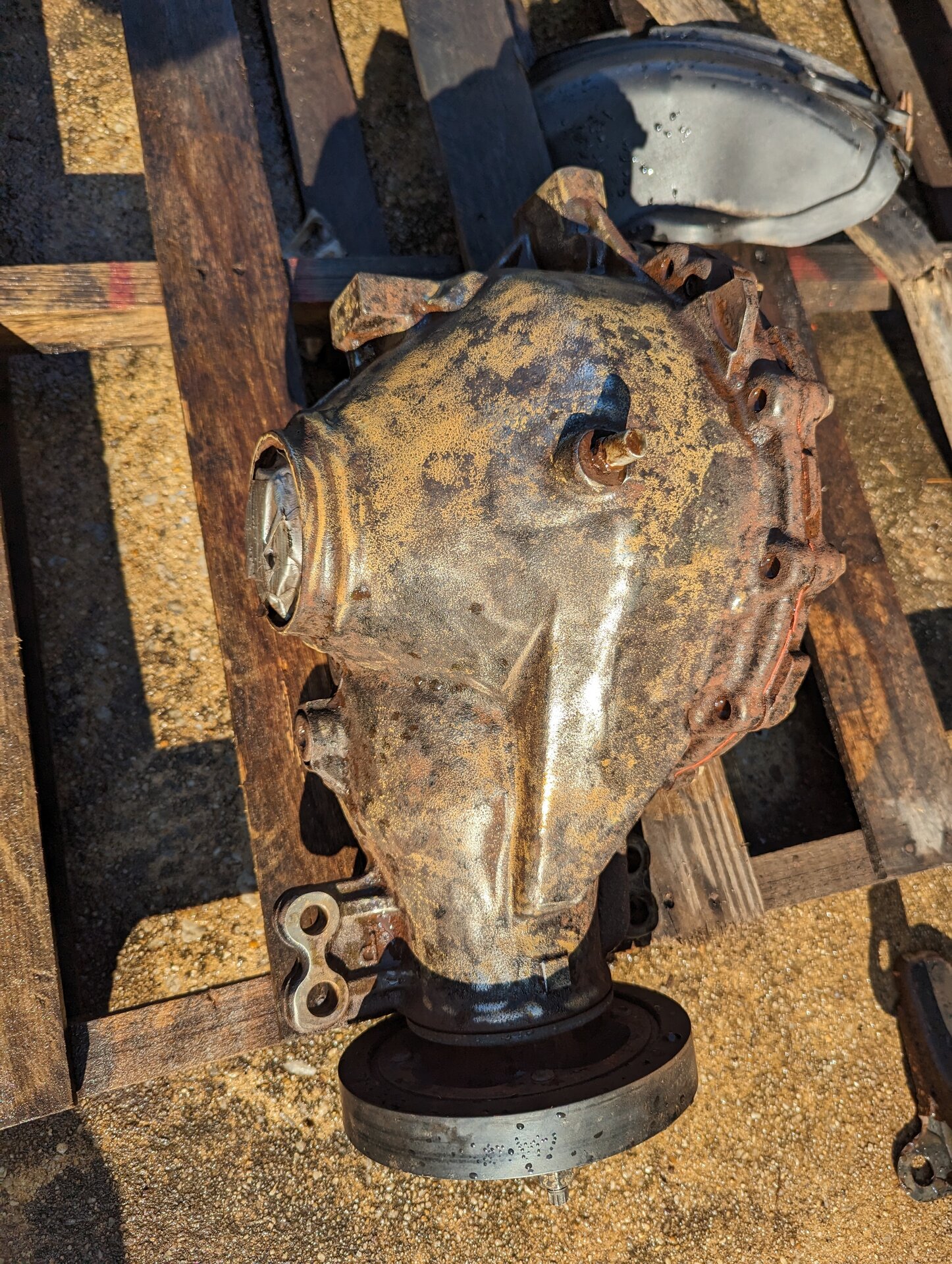

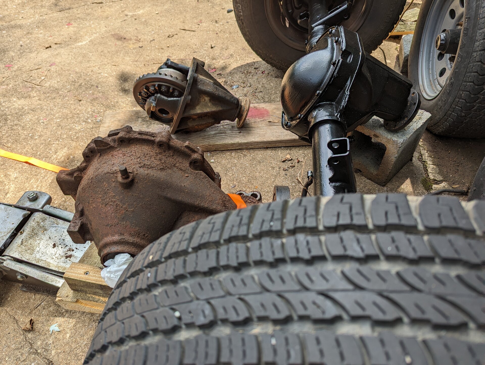

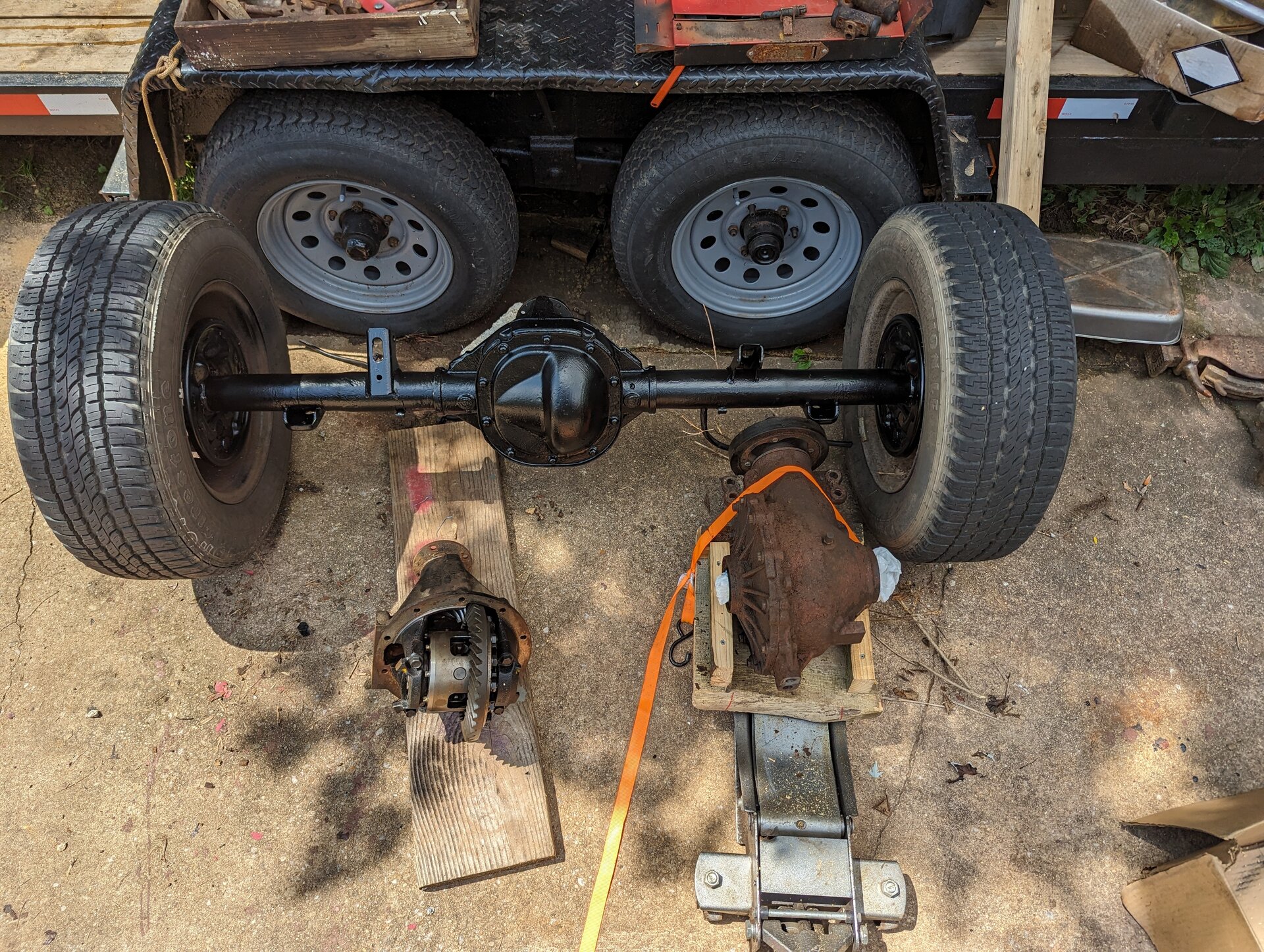

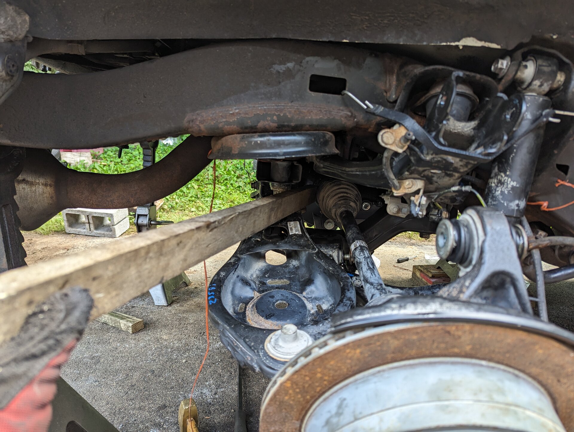

First thing yesterday I set out to remove the diff and it came out without any fuss. I dont have a tranny jack so I made a custom one! The diff was missing one of the front 4 mounting bolts which has me a little concerned that someone has been in here before. I just happen to have an extra locking rear diff from an 1994 80 and a ford 8.8 axle in my driveway to compare against. Hard to tell from the pictures but it dwarfs the 80 series diff and is noticeably bigger than a ford 8.8. The sequoia diff will get new CV seals, breather, and a paint job before getting reinstalled.
The 4 bolts holding on the subframe... WOW. It is almost as if toyota did not design this to be taken off with the body still on the frame. On the drivers side you have very little clearance and the nut flanked by the fuel filler neck and vent. Same deal on the pass side except there is an exhaust and the rear AC lines. You also have to remove the fuel pump controller ECU and the EVAP system valve thing and charcoal canister. All the bots looked nice and rusty so I have been spraying these daily with PB Blaster for 2 weeks. The first nut started rounding off with a 12 point box end on top and a m18 high torque impact on the bottom. Switched to a 6 point socket and spent 20 min trying to find a combination of extensions and wrenches that would fit between the fuel lines. Ended up using a short 1/2" to 3/8 adapter in a flexhead 3/8 socket. A 12" 3/8 breaker bar would have been nice here but apparently I do not have one. The nut would not turn at all and I was ready to just cut the whole subframe off. But then I remembered about the $$$ Mini-Ductor Venom HP and this is it's big redemption. 2" from a gas line i was able to hit a bolt for 3x 20 second bursts and the line didnt even get warm. I hit it while hot with PB Blaster and it came right off like butter! Easily saved me 2-3 hours of cutting.

"Gen2 Sequoia Solid Axle Swap" was the first search I did when starting this project :). And after this project I dont think I will ever willingly own another IRS AWD.
With the subframe removed there is a ton of space under there to fit a tundra axle. I think the issue is going to be that the frame is the wrong shape to mount leaf springs without a lot of fabrication. There is a significant height difference between the middle and rear frame rails. It would need a lot of custom fabrication that is beyond my abilities without buying a kit with directions. However the 2023 tundra and sequoia are about the same width and come with a trailing arm coil spring suspension that looks just like a LC. I would think it wouldnt be that bad to clone that geometry.

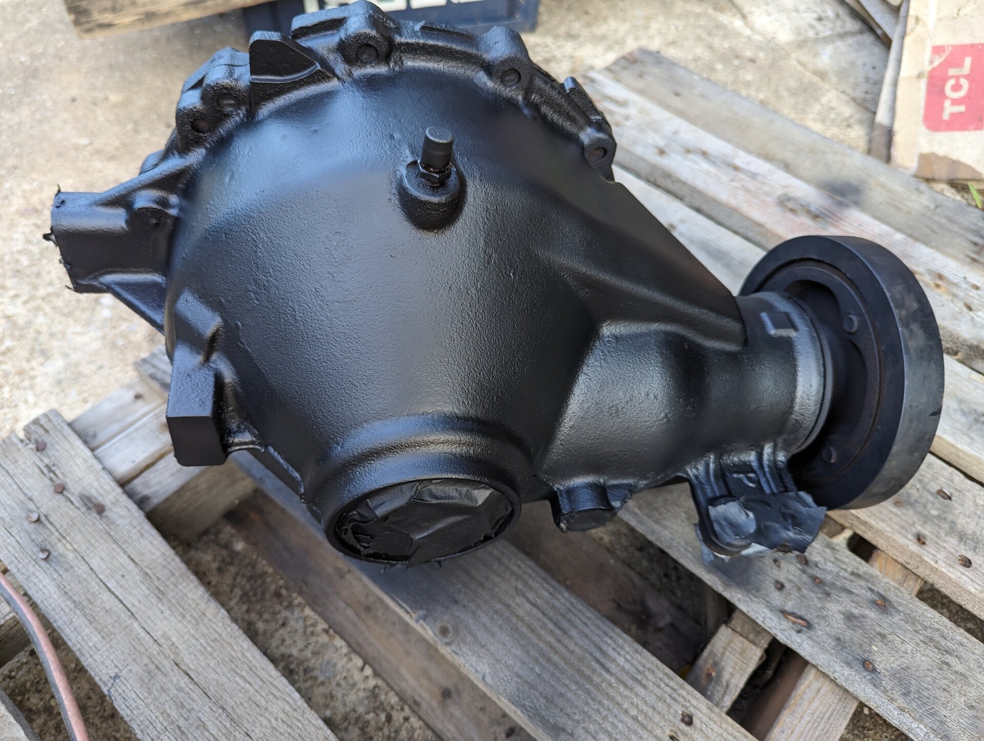

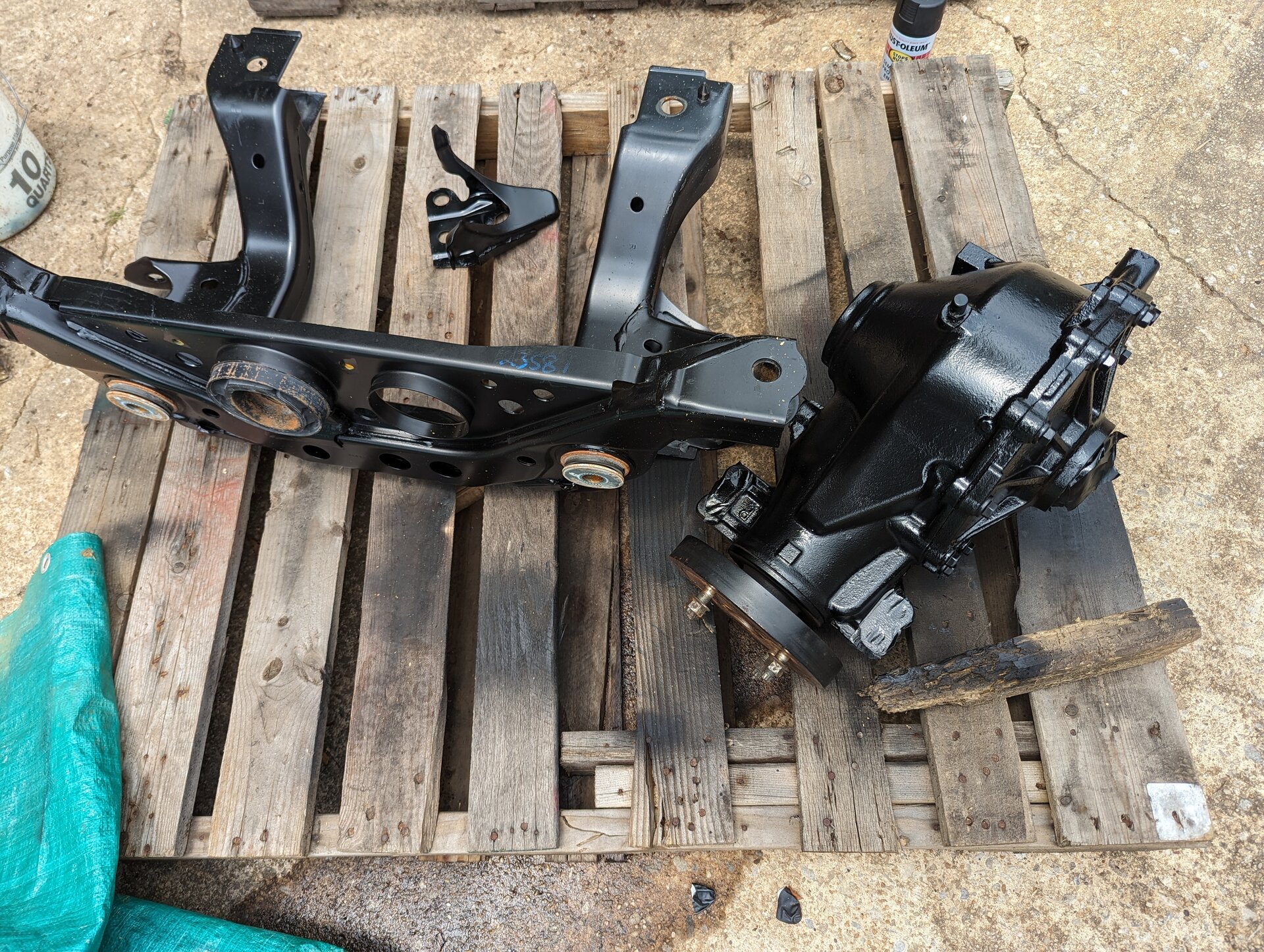

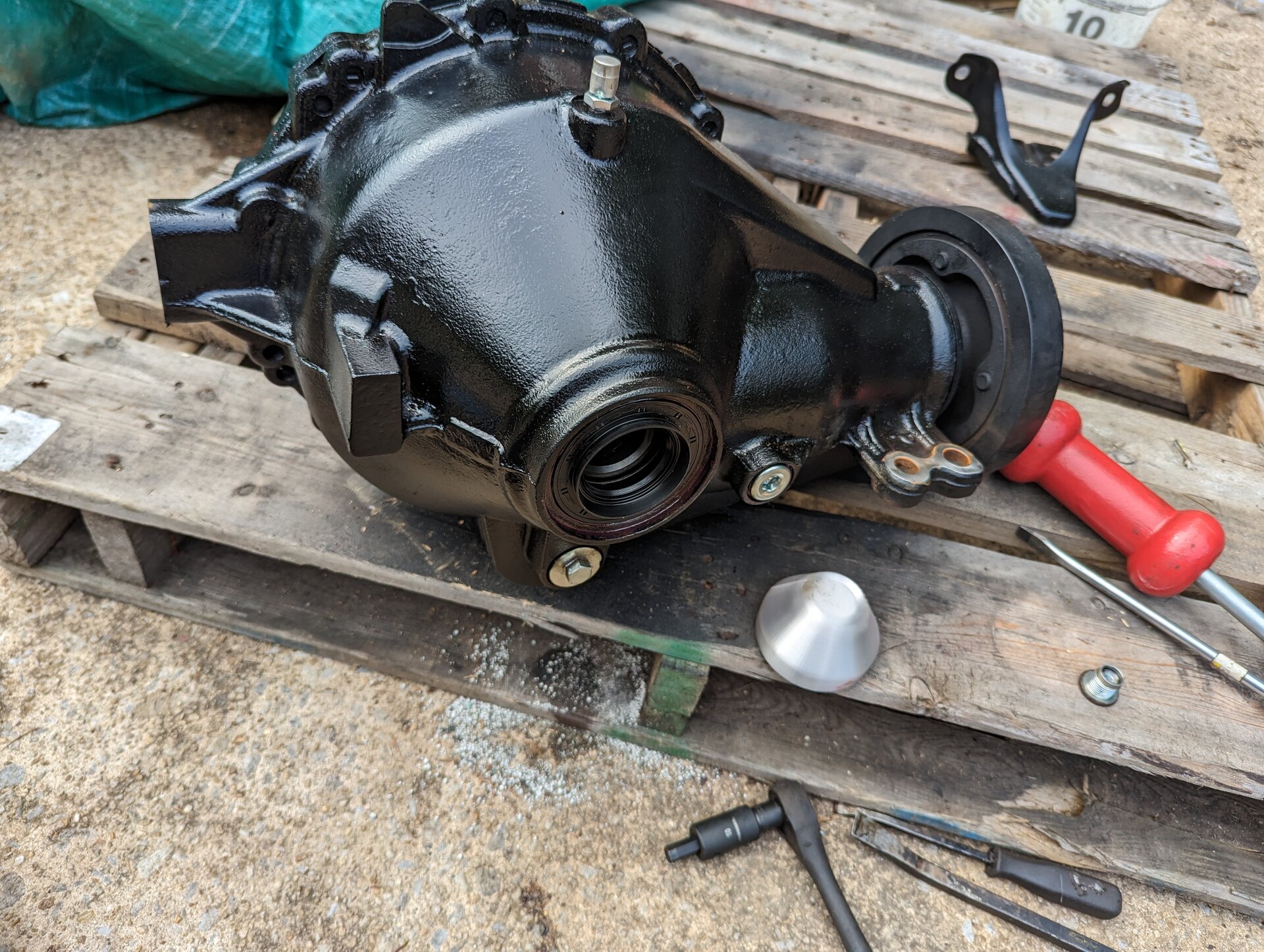

Pressure washed the rear diff, then went over it with some amazon knock off rotoloc sanding discs. Then painted it with the finest rust primer and semi gloss spray paint walmart has to offer. I installed new seals and new breather. I was able to use my custom 3d printed seal press that I am very proud of. The rear seals are the same as the front seals on the 100 series which I already had a spare set of.
Installing the subframe went great using my custom wooden transmission jack. The 4 nuts on top did not want to spin when torquing from the bolt heads on the bottom so that made things a lot easier. 239ft lbs is quite a bit and I could not get my trusty CDI wrench to click. For fathers day with the 20% coupon I picked up the Harbor Freight Icon 56683 digital torque wrench so I decided to use that for the first time. This is the most amazing torque wrench that I have ever used. While pulling on it there are little stoplight colored LED status indicators of how close you are to the set torque value.

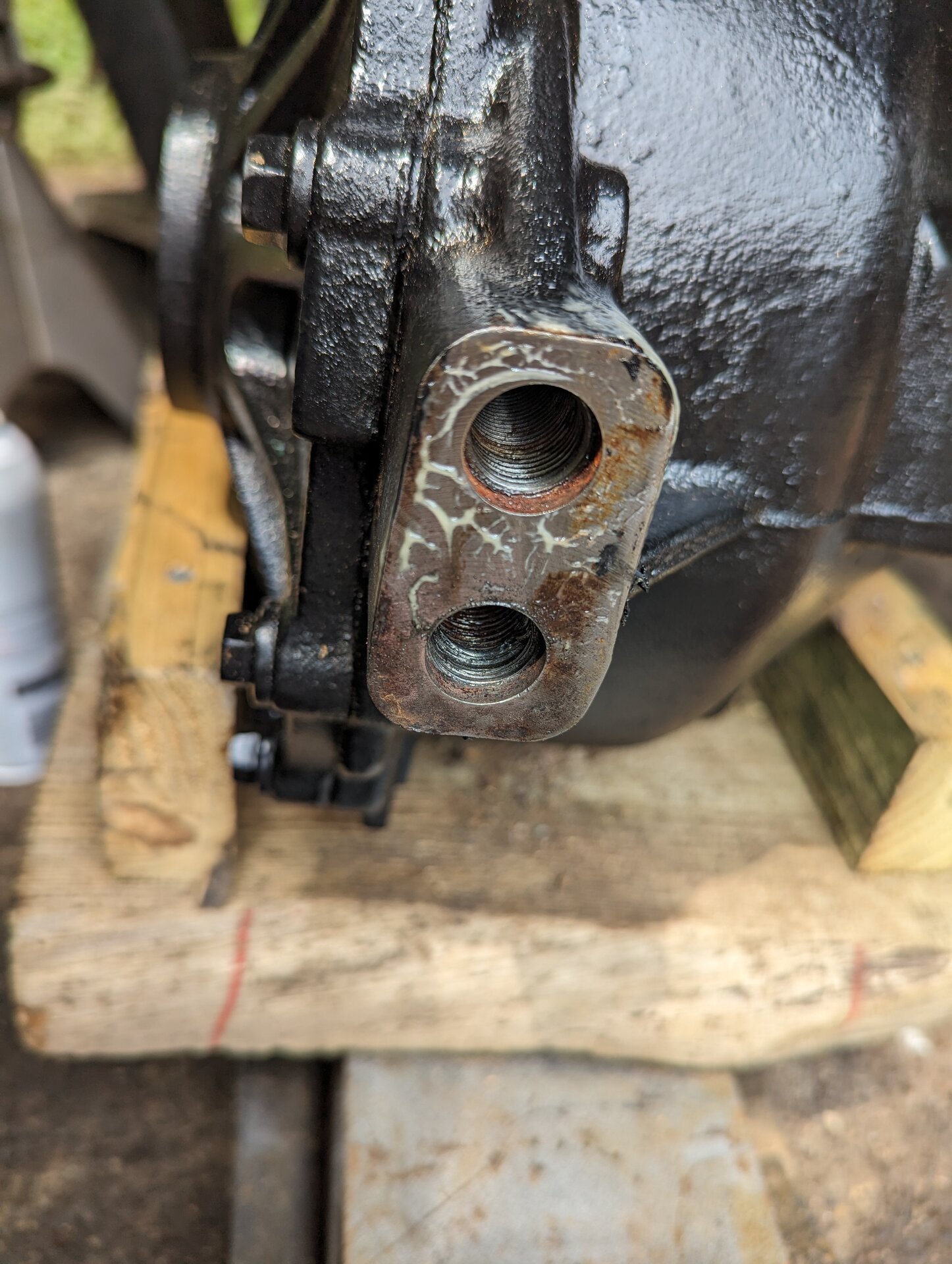

Then when installing the diff, on the last freaking bolt, disaster struck. I hand tightened a few turns then switched over to a m12 3/8 ratchet. It made it 5ish more turns then stopped. After pulling it out i see that there was a bent over thread midway up the bolt which had chewed up the first 1/2" of the threads in the soft cast diff. I measured the bolt as m16-1.5mm which I do not have a tap and die for. Luckily I found the top knuckle bolt on one of my extra knuckles was the right size. I was able make a thread chaser with a file and a rotary tool and it worked great. I was able to clean up the diff bolt with a file then chased it with the knuckle nut. Assembled it like it was made of glass and it was able to hold the 148ftlbs of torque. The front diff bolts are 89ft lbs.

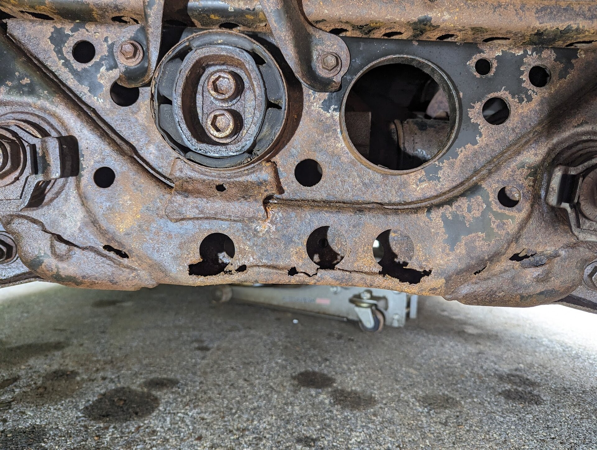

I was looking over the old subframe and found some more weak spots. Drivers side lower control arm mount was barely holding on. I am very happy that I made the call to do this project.

Based on the lift threads I was expecting a fight with the springs. However with all the bushings freed up and the bushing bolts loose and the top knuckle bolt out there was plenty of space to slide the spring in without using a compressor. There were not any bad angles and it was not sketchy at all to compress the spring using a floor jack. After doing this part of the job I fell like any one that lifts should be loosening all the rear bushing mounts to reclock them.

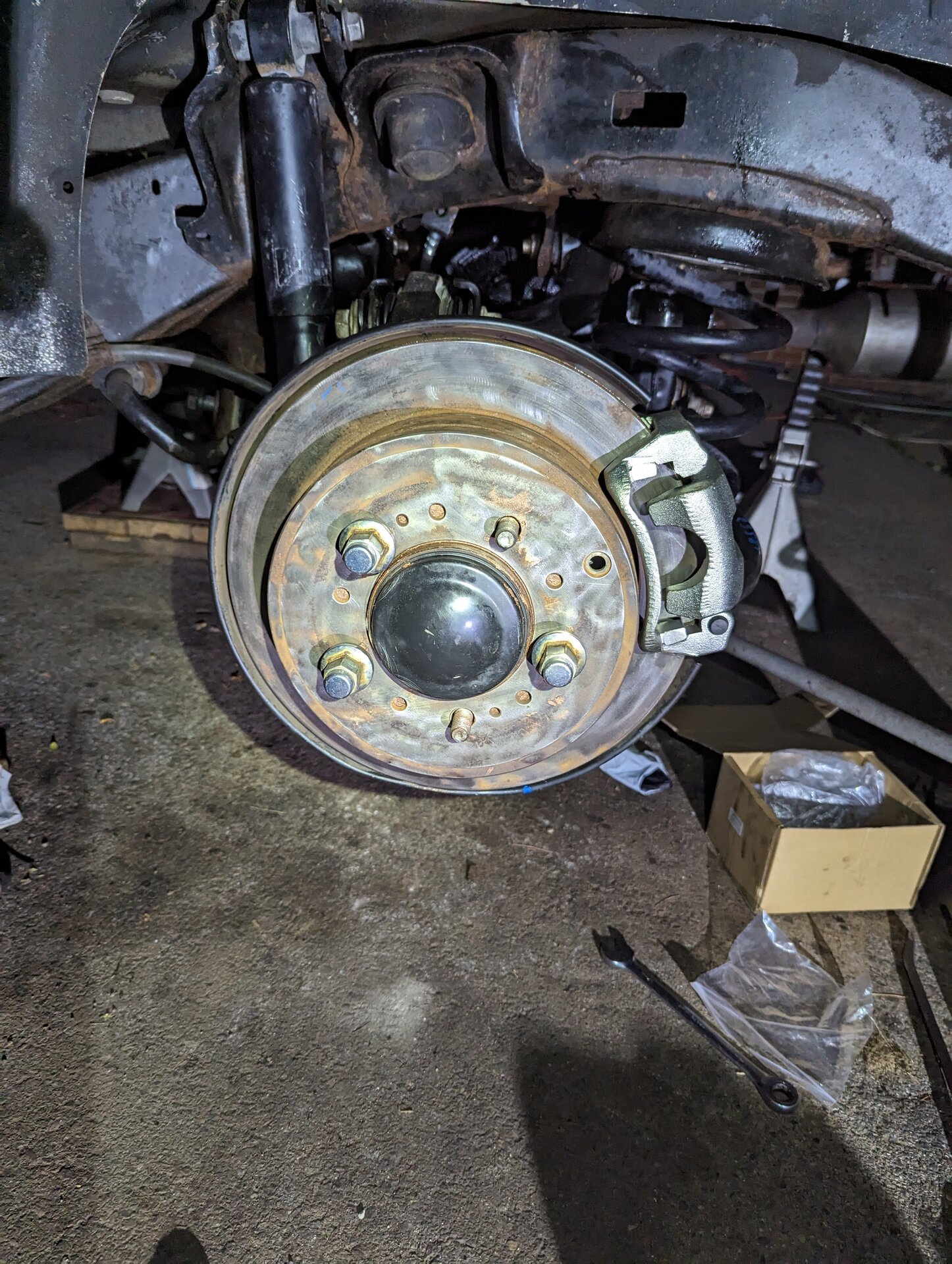

Most of the rear brakes went great... I picked out the 2 best rotors out of the 4 I have, cleaned them up and checked the runout. Funny little tidbit, in maryland when a rotor rusts to the hub it is usually a really horrible job that destroys the rotor. One of the junk yard rotors fell right off and the other one took a few seconds with the threaded holes to press off. I have never actually had success with those holes on any other seized rotor. Normally I have to resort to silly removal methods (see pic of an 80 axle). Replaced the parking brake hardware and adjusted. Then on the absolute last bolt of the job, the 4th slider pin, the threads came right out while torque to the FSM specified 65ft/lbs. I am not dealing with a helicoil on a caliper and did not have time to wait for rock auto so I picked up a replacement set from napa the next day for twice the rock auto price. Then again on the 4th slider bolt stripped out even easier than the first one. My digital torque wrench didnt even register so it was under 12.5ft/lbs. Napa took it back and replaced it the next day and the replacement took the proper torque. I assume the rebuilders don't check the threads which sucks. So I ended up spending 4 days waiting on brakes which is funny considering the scope of what I am doing here. This was a very very frustrating part of the job.
