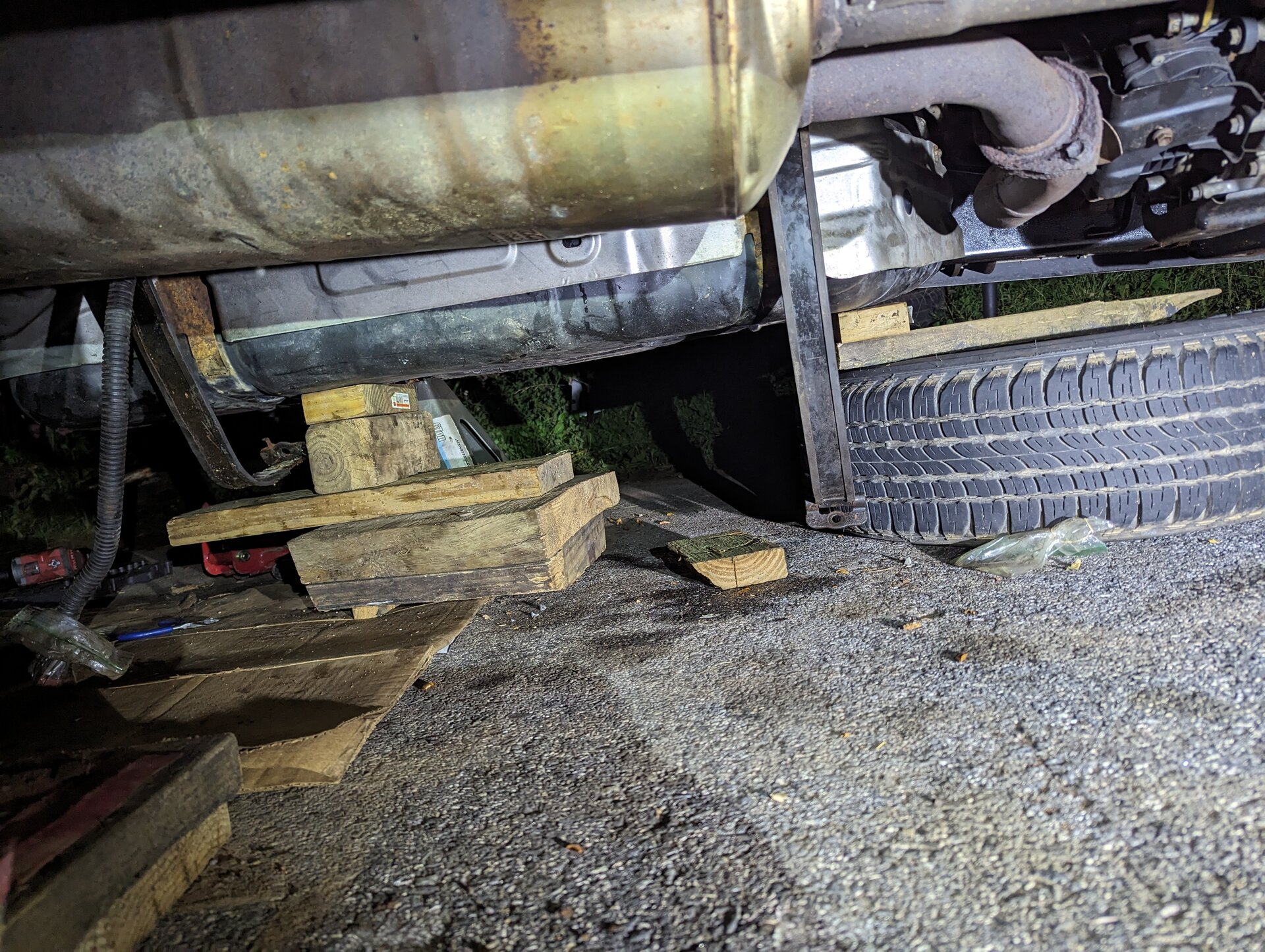

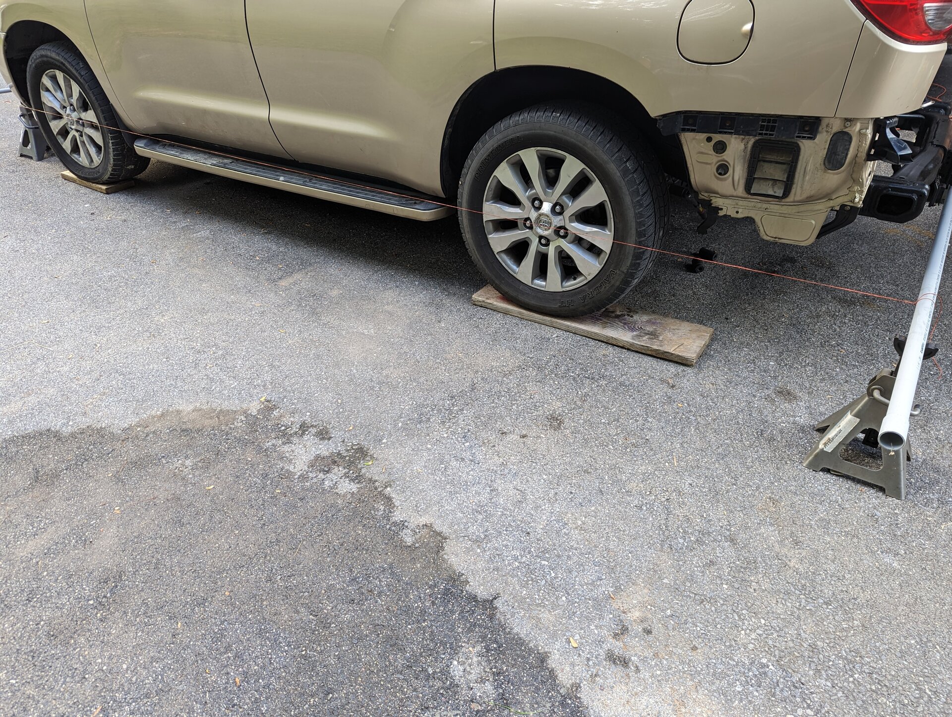

Last part was mounting the fuel tank torquing everything and giving it a driveway alignment. Mounting the fuel tank from the ground sucked bad and impossible to line it up using two floor jacks by yourself. I ended up just stacking scrap wood and tires under it. I am really worried about all the evap hoses, they are not cheap.
I was able to wiggle under the car and torque everything with it on the ground. It was not fun and I felt it the next day, but it is possible if you have a decent selection of extensions and wobbles. There were so many bolts that I had to make a checklist to make sure I didnt miss any.

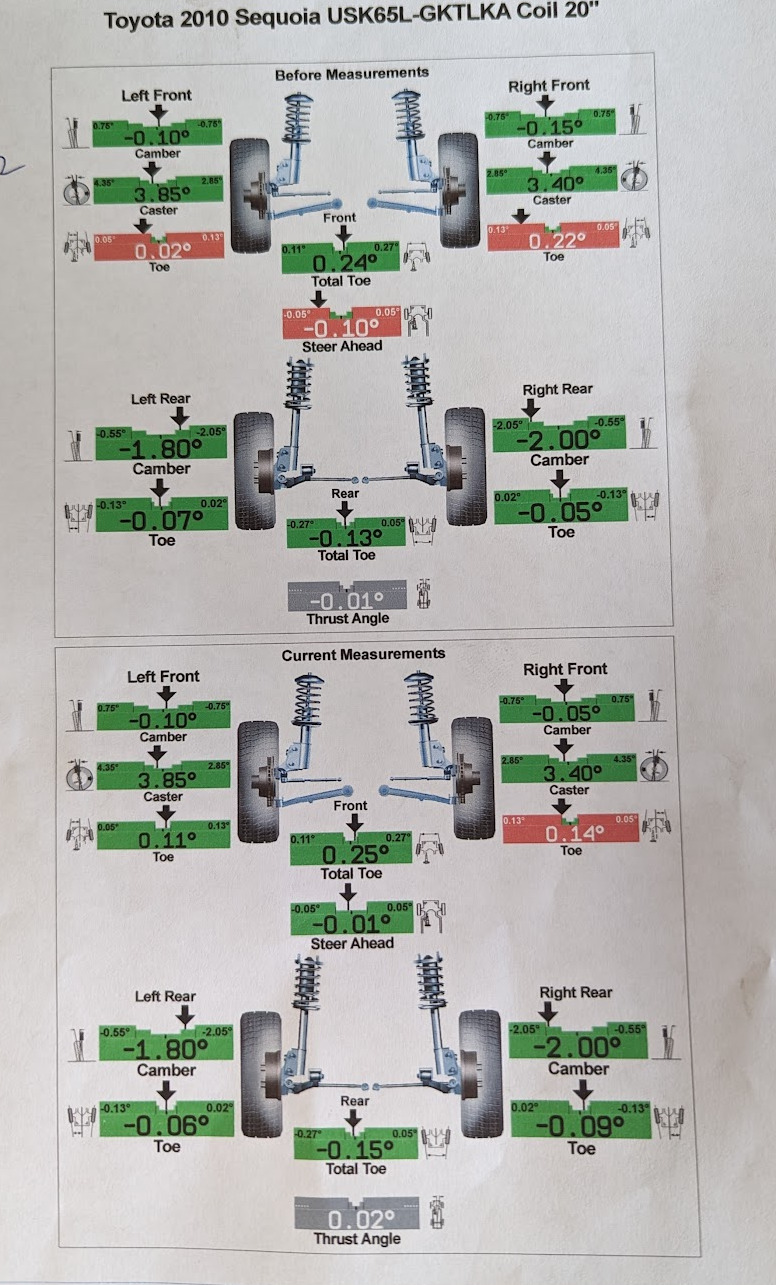

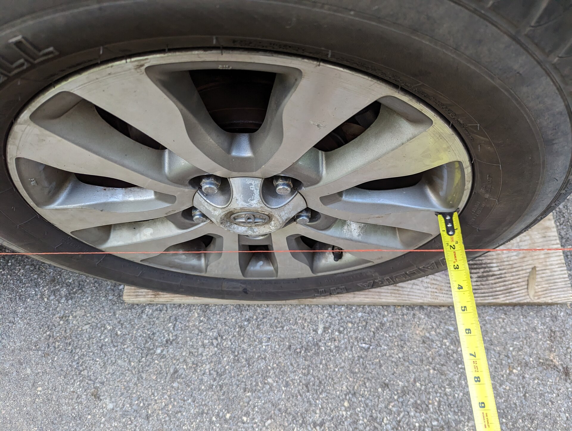

Rear adjustment cams are a 19mm socket on the bolt and a deep 30mm socket to adjust. I adjusted it for -1 degree camber and zero toe. Hopefully the alignment shop agrees with my settings.

On the front of the car I was able to free up the front most two bolts. The front-rear bolts would not move and I didnt try the tie rods. Car aligned good enough for me considering all the work I did and I have much more confidence in my driveway alignment skills. The tech said the tie rods would only move a little and they should be replaced. I am planning on doing the dobinsons 2" lift after my body and mind recover from this project so I will get another alignment this fall after doing tie rods and lower front control arms. Tonight or tomorrow i am going to put 2-3 gallons of thick fluid film inside and outside the frame.
