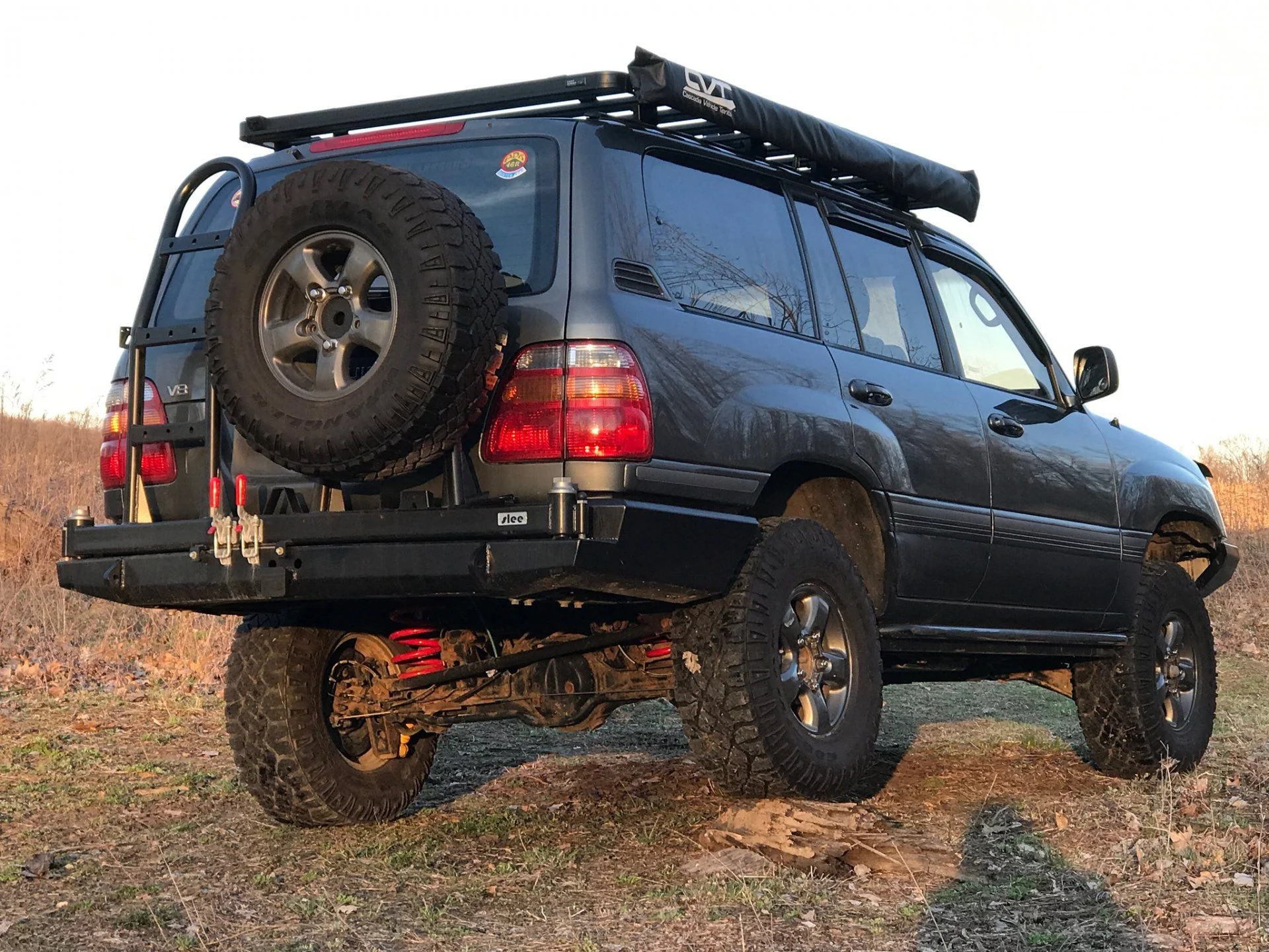

My original build plan included 35 inch tires so I re-geared to 4.88s. Later realizing that 35s were overkill for my needs I went with 33s.
My concerns that the truck would be over geared with this combination (high revs and poor mpg on the highway) have proven to be unfounded. I could not be happier with the highway power, off road gearing, and, surprisingly the mileage. I've seen 17 mpg when religiously sticking to 65 mph on the highway. If I recall correctly the revs are like 2200 at 65 and the speedo is off by about 7 mph. The truck is heavy with typical build stuff including bumpers, sliders, winch, drawers full of stuff...

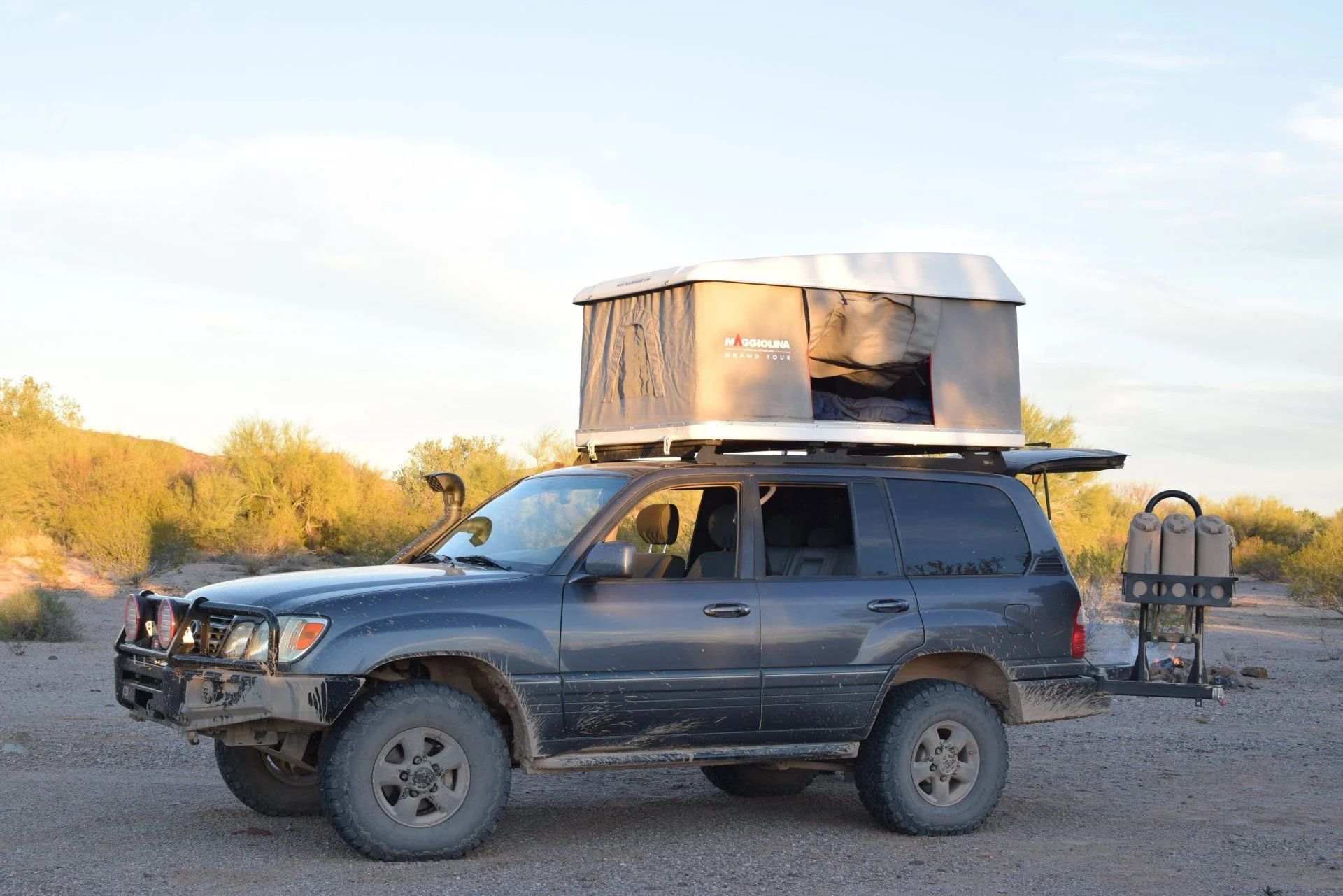

my 99 with a 4 speed is re geared to 4:88's, my tires are 295's which is a 34.5'' tall tire. I previously ran 33's without re gearing and it was ok, but definitely lacked power from a start off the line and when driving up steep grades it would downshift and just need more. I re geared when I broke my front diff gears rock crawling and once I did that, it felt really peppy off the line, but was running out of gear on the hiway. This made me make the jump to larger tires. The truck really felt balanced once I did this all around. @ 80 mph I am at about 2900 RPMs. 85-90 mph is about 3100 RPM. I try not to drive faster than that, but in some states like Utah the speed limit is 80 on the open hi ways and seems like everyone is doing 85-90. The truck is ok at 3000K RPM for an extended period of hi-way, but you will notice the gas really starts going fast. gears are a hefty cost at around $2600-3k, but if you can afford it, do it. But once you are working in the diffs, you might as well get lockers, add another $2500? I probably could have saved $700 in labor if I did it all at once, but I could afford to do it that way.
So sounds like if I stay in the 295-315 that 4.88s will net me what I am wanting off road but not kill the truck on road. also with the 5spd trans I am probably looking at closer to 2400-2500 RPMS. It will be very similarly build to @juane cruiser pictured above. Just want to make sure I don't end up with no power and super high RPMs like my 80. I was climbing mountain passes in colorado doing 35-40 in 1st at 4800rpms... building the hundred to not have to deal with that strain.

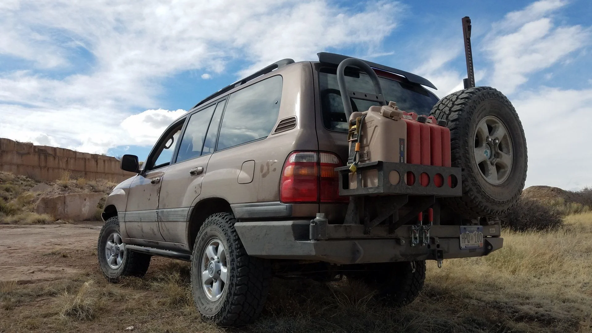

Expo built '04 (heavy) does great with 295 KO2s (34s) and stock R&P.
On the highway it has no problem pulling grades and off road I'm normally in low range manually shifting (2nd start).
I wouldn't change anything.

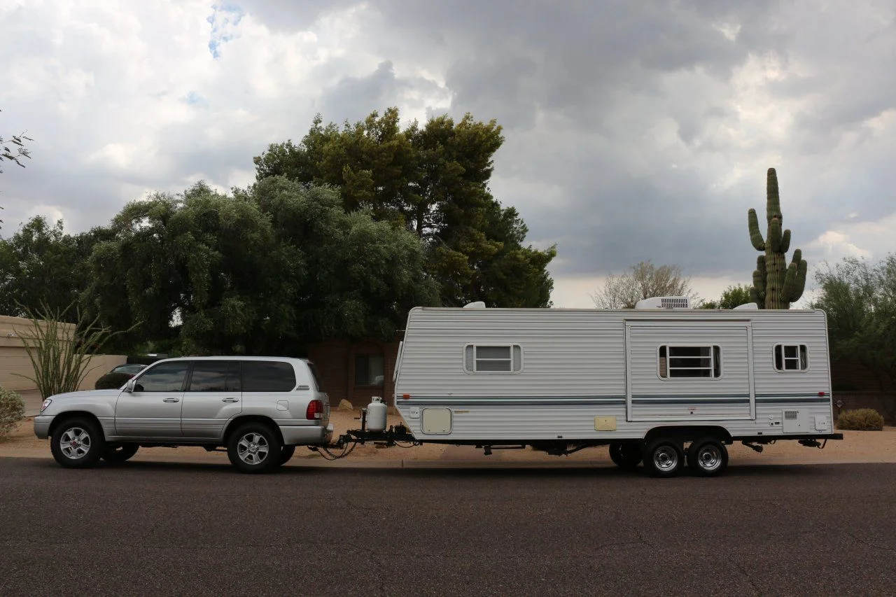

@TEC3 You are set and lucky having a 5sp and VVTi IMO. I have the same year and pull 5000# all summer long with no issue using stock gears and 34's.
I have also been known to pull stupid stuff also using stock gears.:grinpimp:
