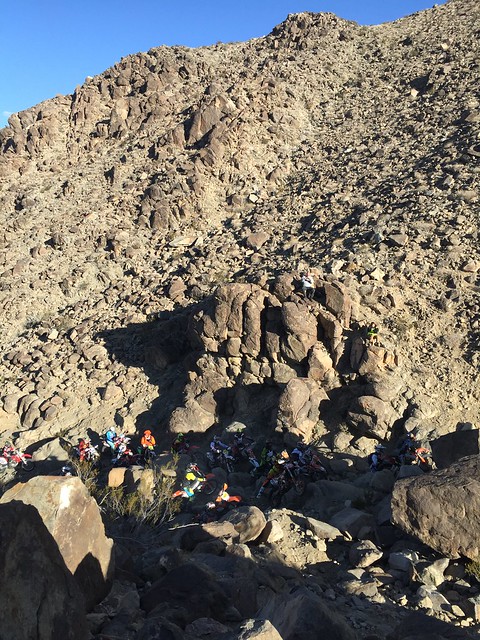

It was a two-wheel log jam as the bikes stacked up as there where only
two chutes that the riders where able to make it up.
I know these guys had to be sweating up a storm in their gear!

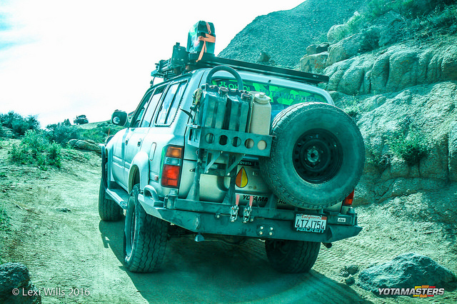

Chris Schutt in his Yotamasters sponsored #4611 stock mod Toyota.
He has a MASSIVE build thread for this rig!
http://www.pirate4x4.com/forum/toyota-truck-4runner/1015770-toyota-racer-4611-koh-stock-class-build.html

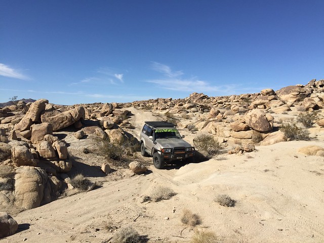

The area was is supercool! Rocks littered all around and paths cutting through everything starts to
look the same and navigation can be a bit challenging. As long as I was on the tops I could see the
general direction I need to be headed in. So I would take that path.

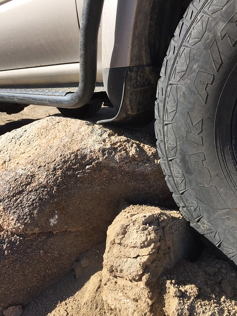

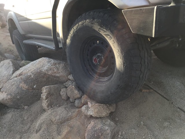

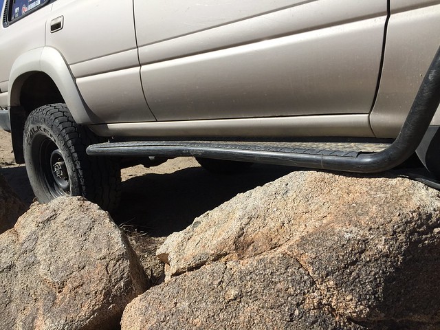

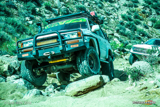

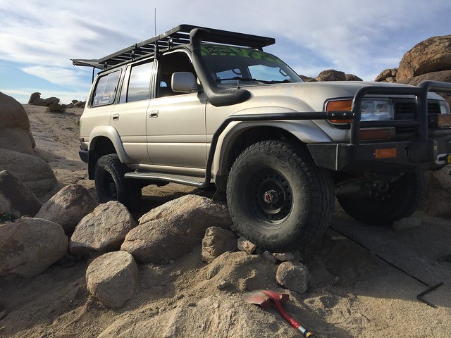

What looked like a small rock and looked so easy, was not! What looks like proper sliders, they are NOT.
I did try to push forward, only to have the rear slide to the right as this is a side-sloping hill. With
the rear sliding downward, that was only going to make things worse! I tried reversing and that made
it slide down a little more.

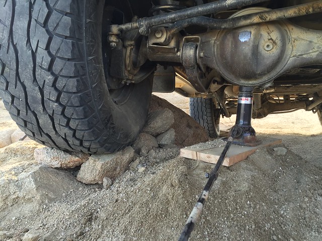

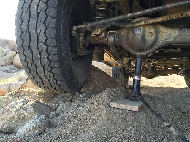

Time to get this l'trusty dawg out! I bought this around 1990'ish when I
built my first 2WD Toyota Pre-Runner and kept it every since, even when I
didn't own a offload rig, i kept it.

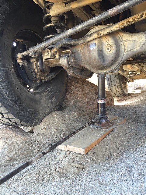

Jacked up the front tire and got some rocks stacked underneath.
All that work netted about 2-inches. OK, lets pop this sucker off this rock!
But the p-gravel under the rear tires does not care.
I need to get the front tire hight up so it came roll back easier.
I exceeded the reach of the old 48" HighLift Jack. I guess that is why they
make the 60" version now. I think I have gotten un-stuck more times with
the factory bottle jack... well, maybe a come-a-long, but you get the point.
USE ALL YOUR TOOLS!
I got the second layer of rocks under the tire. Now I build up the mound for the bottle jack. Yes, that
little flat piece of wood is usually in the rig just for this purpose! Looks like I will have to upgrade it
as I put a crack in it with this loose surface jacking.
I dealing with inches at a time.
Whats the deal with the straps hanging from the face of the wheel?
You know what I tried to do....
Yea, I tried to lift the wheel with straps and the Hi-Lift. Another item to add
to the list as Hi-Lift make the proper apparatus for this situation.
Check this out:
http://www.hi-lift.com/accessories/lift-mate.html
I'm making progress! Just taking my time and being very patent. This is why you bring extra water
any time you are in the desert. It can be freezing at night and mid-80's during the day.
You hate when you put all the effort in only to have the mound go south. No progress on this
attempt. Pull it down, build more mound, go again.
Now we are getting somewhere now that I've built "Jack Mountain!"
I think I might have it now!
And the ADV80 is OFF the ROCK!!!

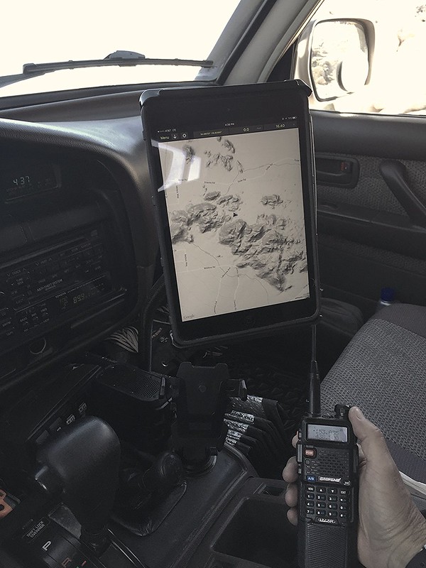

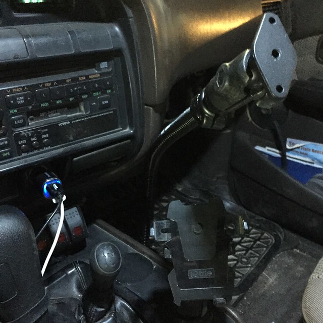

NAVIGATION IN THE ADV80 - FINALLY:
I'm sure you expected one of the "big dawg" systems from either Lowrance or Magellan, but I guess I've yet to have a good user experience with either of those systems. The fact that I've had this rig since 2008, have been exploring in it since 2008 and its just 2016... some 8-years later and the ADV80 is just now finally getting some type of digital Navigation system... has not been a major priority.
But here we are and here we go! And I am going with an Apple iPad mini. SAY WHAT?!
Sorry, I've been an Apple fan since my first computer, the Quadra 650. Not that it was know for navigation... hehehe just saying... But yea, this is how I am going to start. Who knows what system will come later.

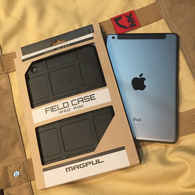

MAGPUL, don't think you should have any questions there... other than what color,
https://www.magpul.com/products/electronic-cases

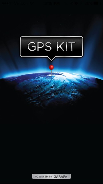

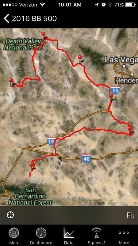

Luckily, Apple fans have a neat app option for navigation called
GPSkit. I learned about this app from my Yotamasters / B&B Crew as they use it for plotting upcoming trips. They plot and share, I download and know where we will meet up and tag along. I also use GPSkit app when I am out exploring, if I find something cool and want to mark it and know how to get back to the location.
The
Ram Mount company has been around for quite some time as evident by this old catalog i've
had for a few years from my car audio days.
With my recent introduction to GPSkit navigation (for iPhone only) I wanted to use an iPad mini
for in vehicle navigation.

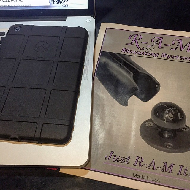

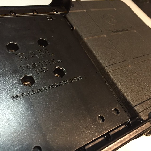

I purchased the
RAM® Universal Tab-Tite™ Backplate for the iPad mini (part Number RAM-HOL-ACU). With RAM, you
purchase your backplate then choose your end caps according to what device you have, so please
make sure you thoroughly read through all their info and make sure you get what you need!
Then comes the spring-loaded end pieces that actually hold the iPad in place on the backplate.
I purchased the
RAM Tab-Tite™ Cradle (2 qty) Cup Ends for the Apple iPad 1-4 WITH OR WITHOUT LIGHT DUTY CASE
The big question is will it hold the iPad wrapped with the MAGPUL protective case? I knew I was risking proper
fitment but I wanted to see if it would work.
I also purchased the
RAM POD I Universal No-Drill™ Vehicle Mount with 18" Rigid Aluminum Rod & Round Adapter Base
(part number RAM-B-316-1-202U) to hold the iPad up where I can easily see it. This is the most
expensive piece as it has metal base plates and the post is aluminum. Its a solid piece under that
plastic cover.
Quick list of RAM parts:
BACK PLATE - RAM-HOL-ACU $21.99 - http://www.rammount.com/part/RAM-HOL-ACU
END CAPS - RAM-HOL-TAB3-CUPSU $13.49 - http://www.rammount.com/part/RAM-HOL-TAB3-CUPSU
STAND - RAM-B-316-1-202U $37.49 - http://www.rammount.com/part/RAM-B-316-1-202U
Total: $72.97 + shipping (or Amazon Prime)
HOW DOES IT WORK & DO I LIKE IT?
I works great and does everything I wanted it to do.
However, it does move or vibrate in rough terrain. But at the same time, you should not
be looking at your screen during that time. If you have a co-pilot trying to navigate for
you it might be better to hand-hold it or opt for the
RAM POD HD, but I did not want to
invest that much on something that I was not sure would be my total solution.
Knowing what I know now, I do not have any plans to upgrade it as
it works fine for my needs.
I could work on my mounting location and making a secondary mounting point from the post
to the dash somewhere. I'm very satisfied with this solution.

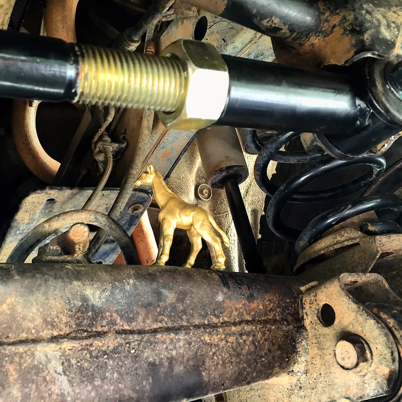

I upgraded to the "Gold Giraffe" standard! Slee Offroad Front Panhard Rod - Part: SOF1074
www.sleeoffroad.com/products/suspension_pieces_arms.htm

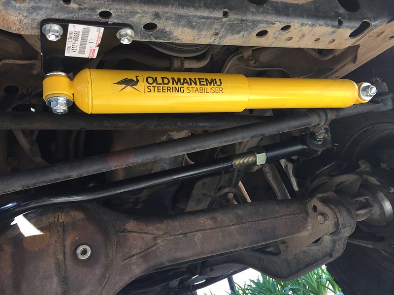

The ADV80 also received some stabilization with the OLD MAN EMU STEERING STABILIZER as well!
Magnetic drain plug is from Yotamasters, but that has been in when the gears and lockers went in.
The ADV80 feels like a WHOLE NEW vehicle! Like the first day I bought it!

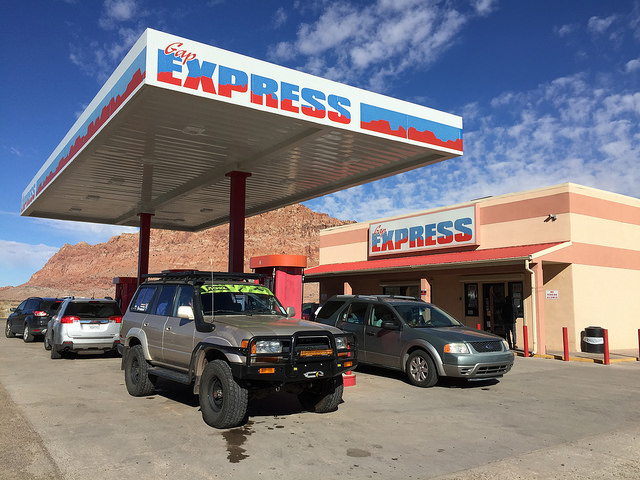

At this Gap Express 525 gas station in Cameron, Arizona has to be the slowest pumps on the planet,
but it is what it is and when your way out here, you just deal with it. Bathroom break, oil check,
window clean, soda-restock, carpet and floor mat cleaning, you name it, you will have plenty of time to do it!

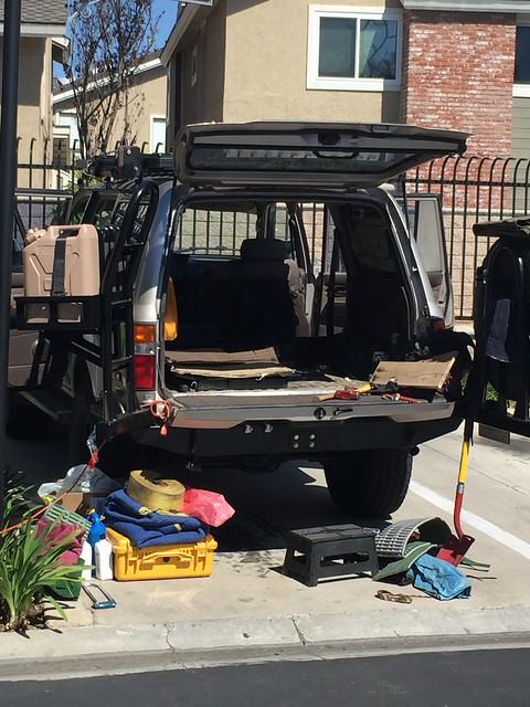

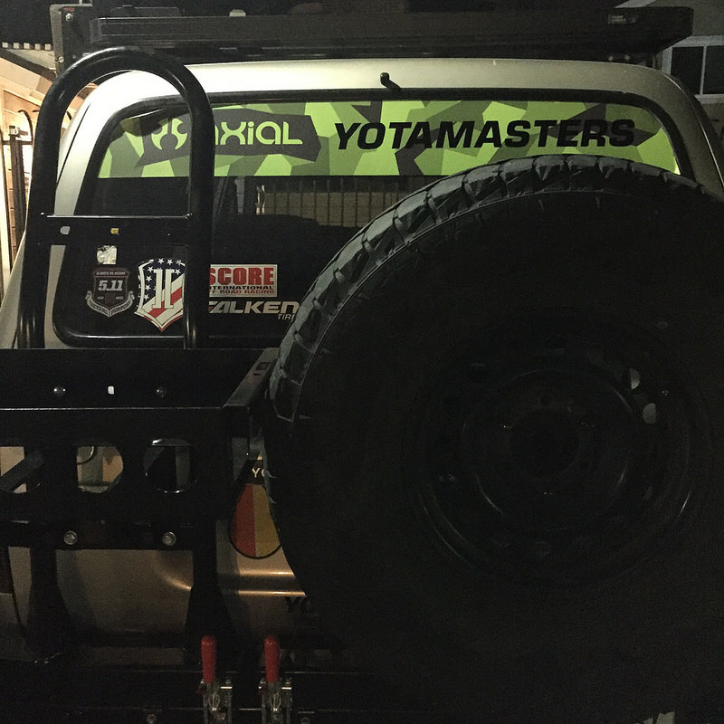

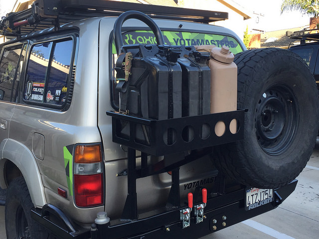

The ADV80 has taken on more payload in the form of the
SLEE OffRoad 80-Series Rear bumper with dual swing-out carriers!!
With the trip coming up its time to re-arrange the rear of the ADV80! The
spare tire was previously strapped inside and took up so much valuable
interior space. Now I have so much interior space back, I have to re-configure
my whole layout.
Remember the gas cans mounted inside? They get to come out too!
The
Front Runner Outfitters metal gas cans work perfectly along with the LC Industries water can.
I will want to work out a lockable-security measure for the gas cans, but that will come later.
Lets go put 500-offoroad miles on this new bumper and lets see how it works in the field!

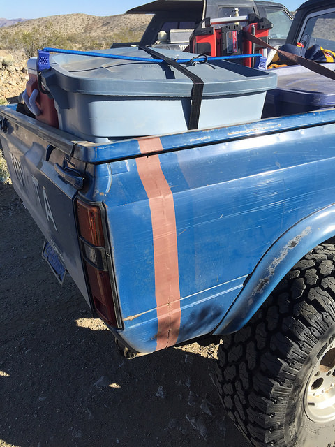

This is one of the two first get Toyota's on this trip. This one has been bobbed,
well prepped and ran great all weekend. It was a cool conversation to listen
in on the two owners as they discussed who had the oldest of the two, beating
the other 1979 Toyota by only a few months.
Inside the Toyota is all business office!

So how is the ADV80 riding with the new bumper?
The ADV80 does have a different feel. You can tell it has some weight out back, but that is all for the better as the suspension
needed some weight. The big concern was rattle-noise with all the "stuff" hanging out back, but that was quickly put to rest!
The massive tire out back is not flopping around as I have seen on so many rigs with tires mounted on swing-out!
I'm very impressed and VERY HAPPY with the SLEE bumper!

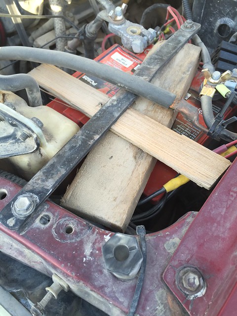

BATTERIES ARE HEAVY! Factory straps are WEAK!
Field repairs prove function but will not collect car show points!
Maybe MacGyver points though!!!

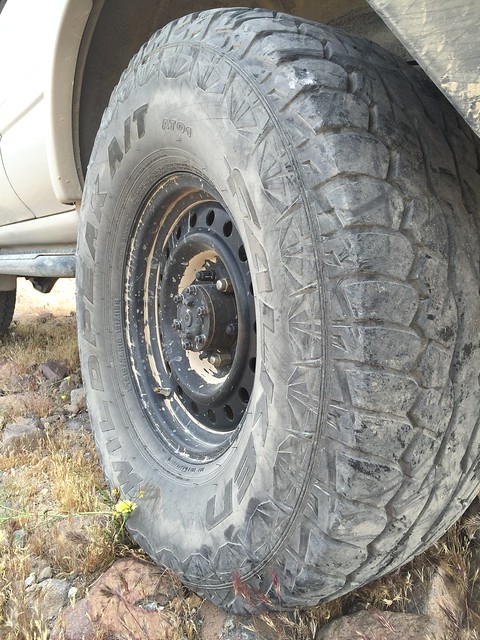

The Falken Wild Peaks have been ever-performing!

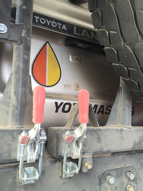

Two full desert days and the Slee rear bumper with dual swing-outs have performed
flawless!!! What does a bumper have to do? Swing-out as usually supporting
a lot of weight and can flop around and vibrate itself apart especially with the
added weight of a big heavy tire and three 5-gallon jerrycans.

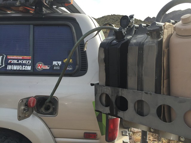

Jiggler hose in action. This just makes it so easy! No more holding gas cans up over the fuel inlet!
