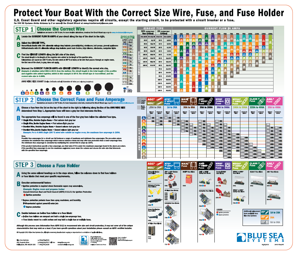

12v wiring size is pretty much determined by the amount of amps and the length of the wire. Figure out what the factory BMW fuse size was and go from there.
Here's a really good and detailed guided on wiring and fuses from Blue Sea Systems, based off of the USCG boating wiring requirements/standards.

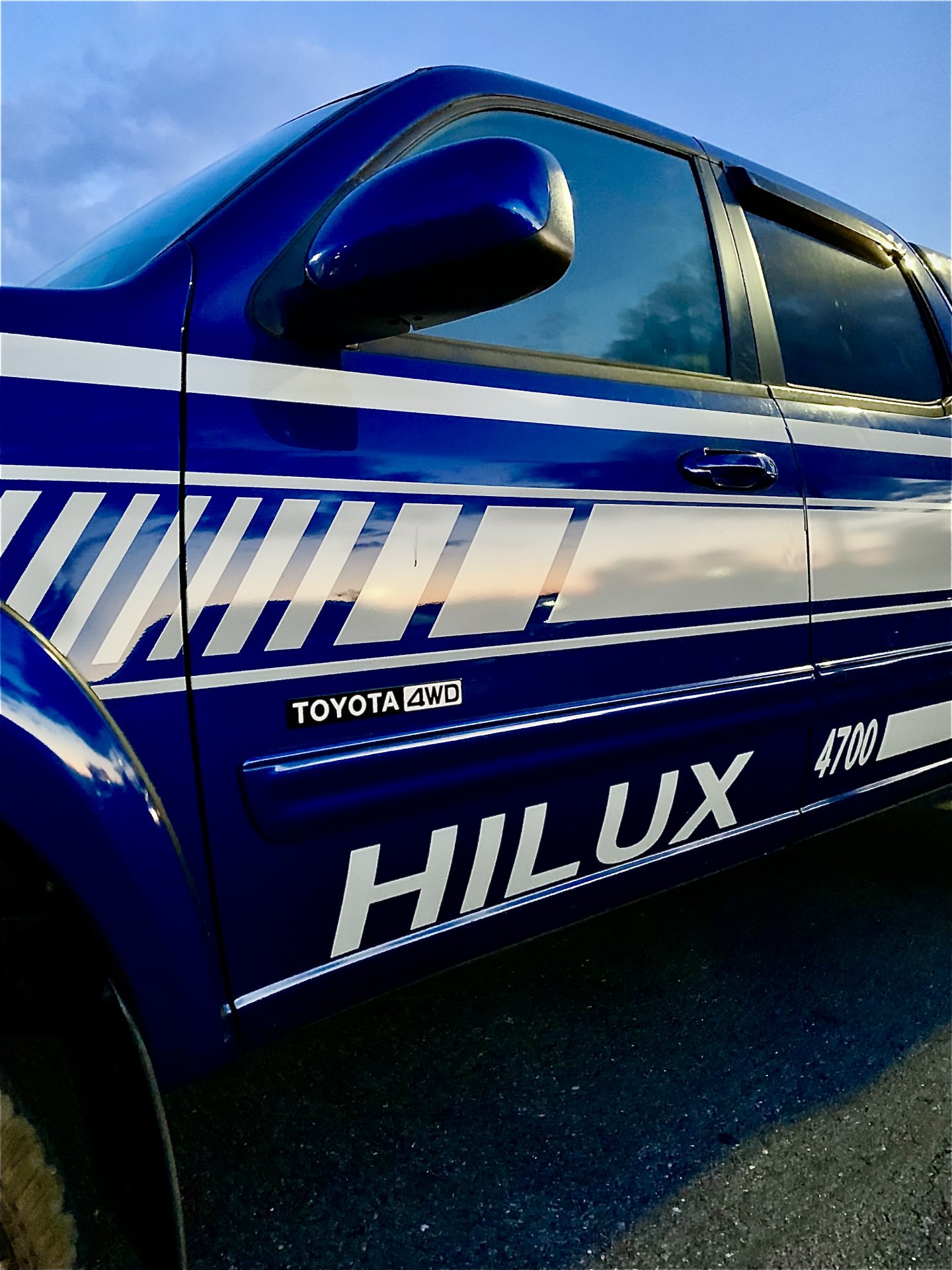

im looking for updated OEM Toyota seats from a totally different TOYOTA vehicle modle then
SUPER HILUX entirely below ?
made in JAPAN TOYOTA seats are built entirely different then any USA spec. TOYOTA ones made here ...
