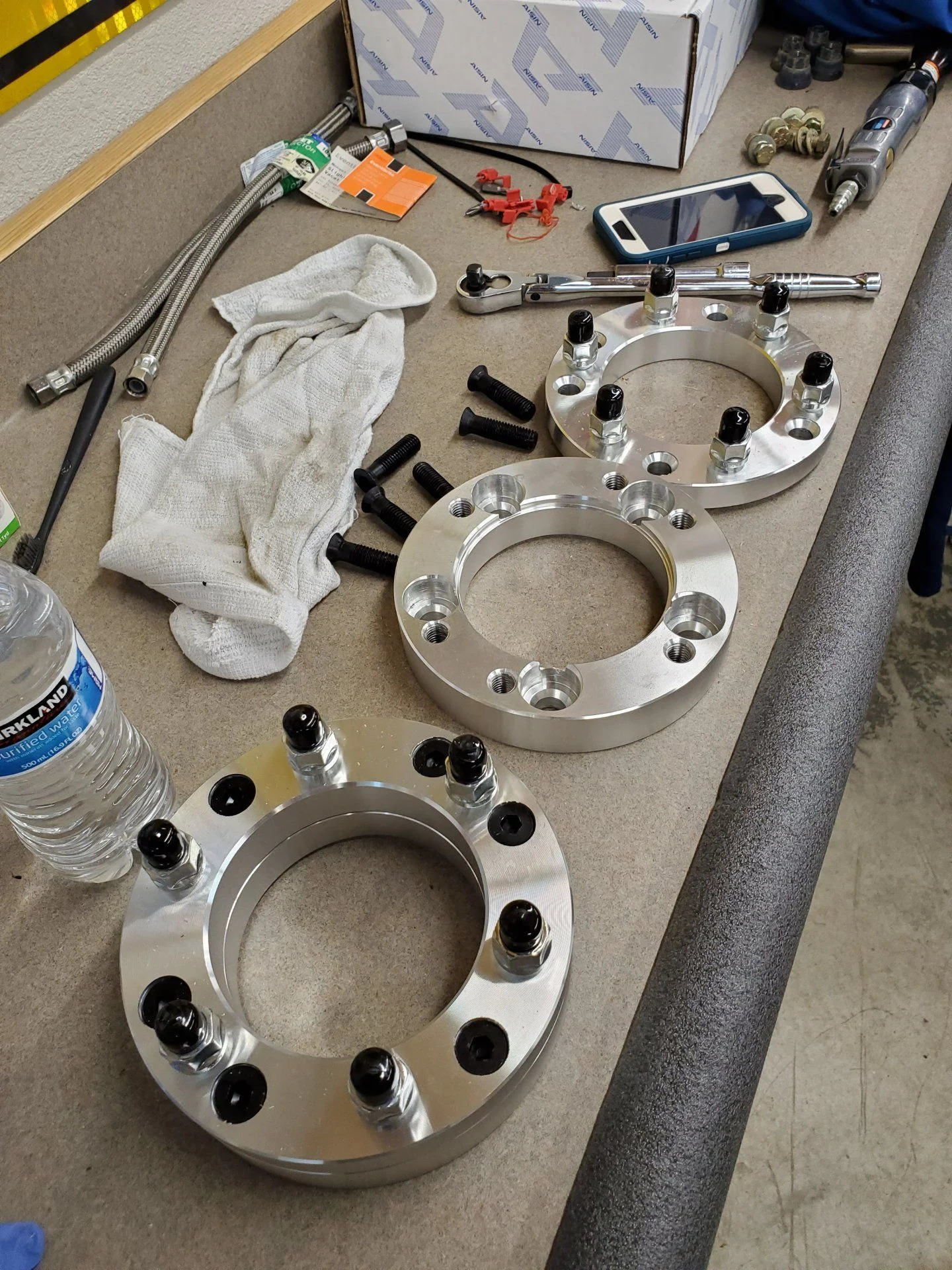

Decided to widen the stance of the trailer with wheel spacers/adapters and switched to the Toyota 6 on 5.5. Bought new tires "same ones" and used 2 of the older ones for the trailer and kept the other 2 for spares. Went with 5th gen Runner take offs for $50 each for the trailer. Will use another one when my rear bumper is done for the spare for the Runner and trailer.

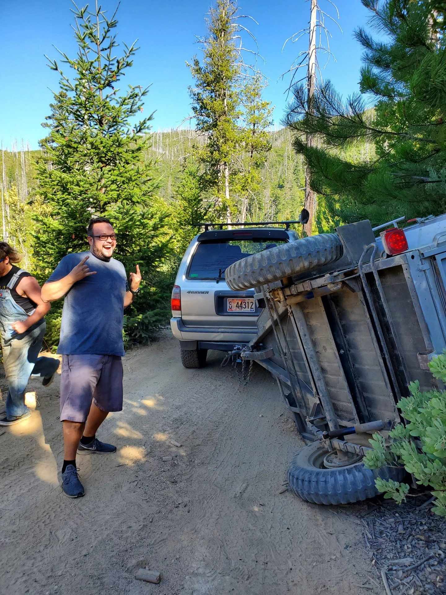

OK, now MattT flopped his on the last run while running my "old" trailer tires. He says they are cursed and that's why his trailer flopped!!!

As a preventative to flipping is there anyway to add stops to the rotating tongue of the trailer? Have it stop at 75 degrees? Its not like you need a full 360 degrees of articulation. Just seems like an easy fix.
