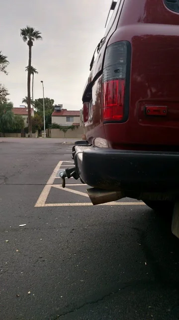

I was out at Charouleau Gap over the weekend with a couple of friends (great trail, if you haven't been I recommend it!) and while waiting for a Jeep with a broken front propshaft to get moved out of the way, a Jeep in our group rolled down the hill a bit and bumped into the rear of other friend's FZJ80 with a pintle receiver. His cross member got twisted down from this.
If this were my FJ80 I wouldn't be fazed, but his Cruiser is near perfect and this was to be its last run before it goes to the new owner. What's the best way to fix this? Can I safely bend it back, or would it be best to have the entire piece replaced since the structural integrity might be a bit compromised?

F'in Jeeps:bang:. Part number for a replacement cross member 51209-60111, a little spendy but available through Camelback Toyota at a nice discount. You could also post up to see if someone will sell you theirs. Many folks cut their crossmember out to install aftermarket bumpers from 4x4 labs. Put tow strap on pintle and pull it back out?
pulling it out or putting a jack under it and pushing up were my initial thoughts. There are 3 80's in Prescott being parted out right now, so I know I could get a cheap replacement, but I can't weld it back on.
we were on a bit of a slope, Jeep probably rolled 10ft maybe? Just put a small dimple in his plastic bumper.

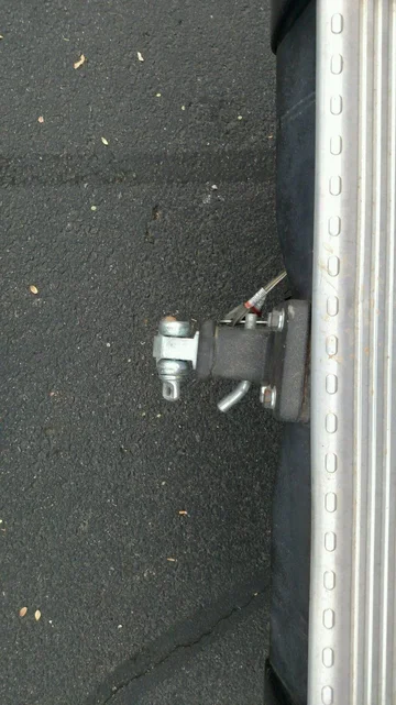

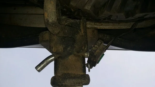

After taking a closer look, I think trying to straighten it out will not be a feasible solution.

Just be glad it was pushed in and not pulled out. Much easier to straighten. I not a fan of any type of hitch that uses the four holes for a pintle hook and mounts something below the frame member. PO of my 79 had one that hanged down then drove it like a rental car. The frame member is pulled out which will be tricker to repair.
