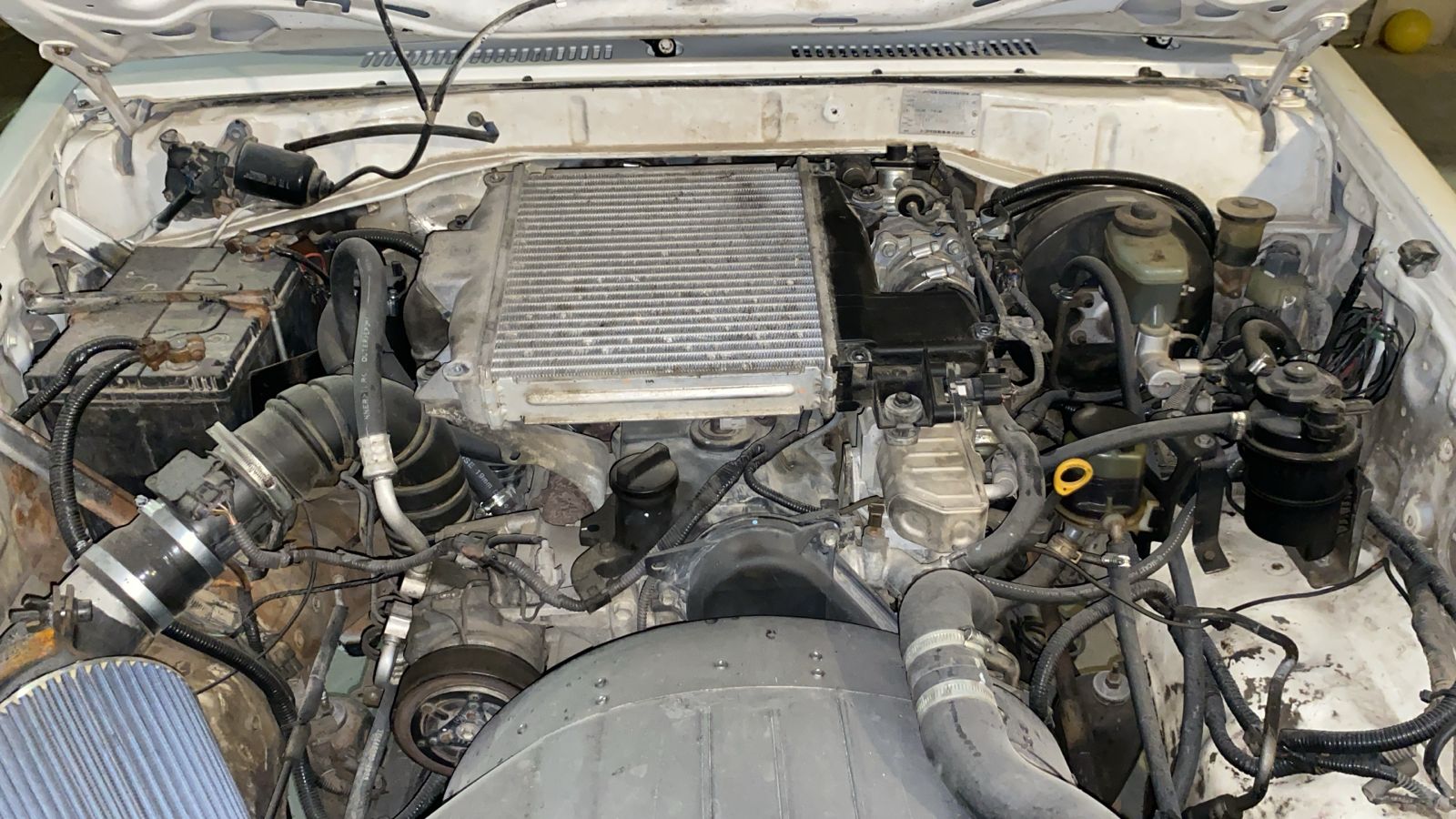

I recently swapped my fzj71’s 1fz carbed version to 2014 1kd-ftv out of a hilux 3 plug injector driver model.

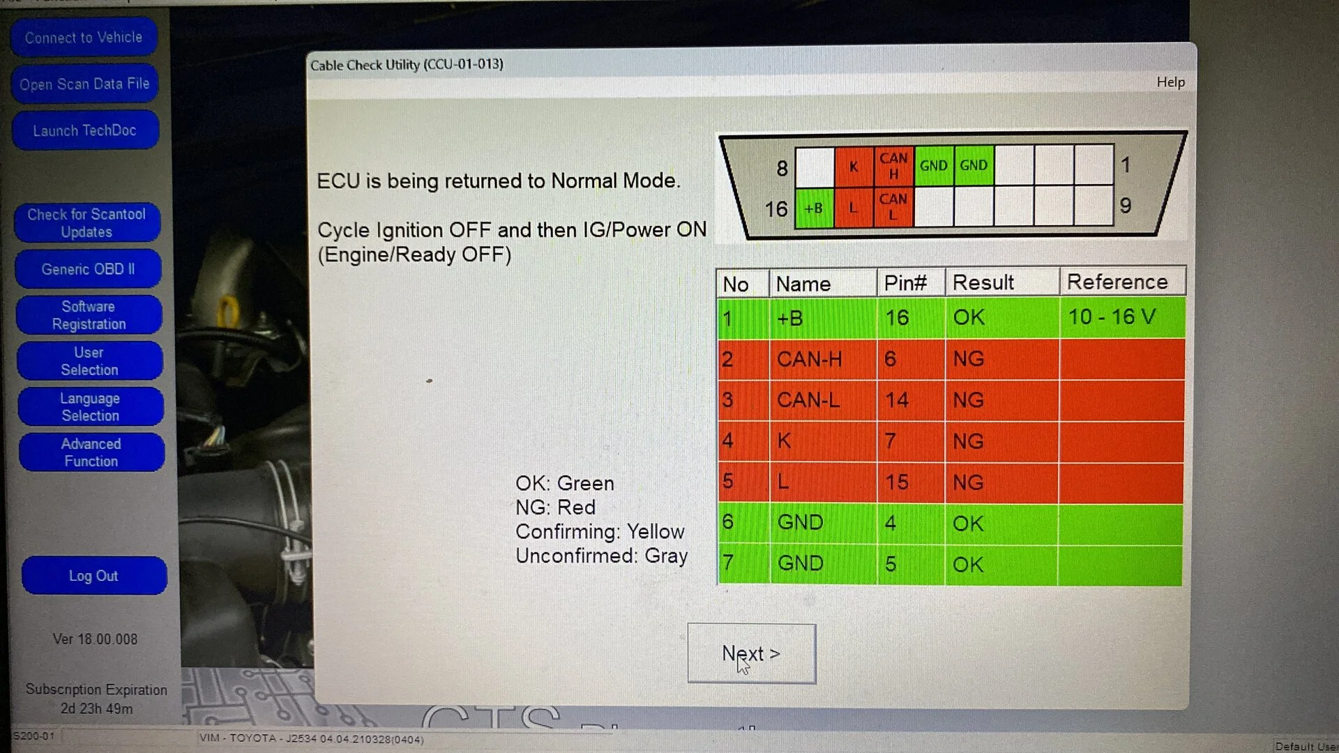

I’m having trouble connecting to techstreem (tested and working on 2020 camry/2004 lc100)

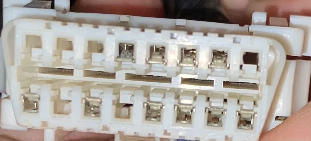

The issue seems to be from Can-H Can-L pins #6&#14(see dlc3 check attached) i also checked the resistance using a multi meter, the circuit is open.
what is my best approach to tackling this. I went through the electrical wiring diagram it did not show which wires go into pin #6&#14. Also, how can I know which pins from the ECU are responsible for pins 6&14

Update, I found the solution it working great now.
Obd2 pin#6 red goes to e5 pin#24 black
Obd2 pin#14 white goes to e5 pin#23 white
