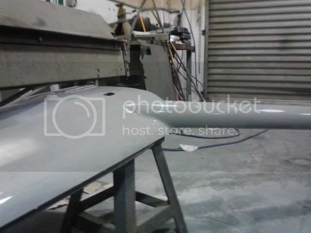

It's going to be interesting to if the snorkel will be restricting on the dyno.
