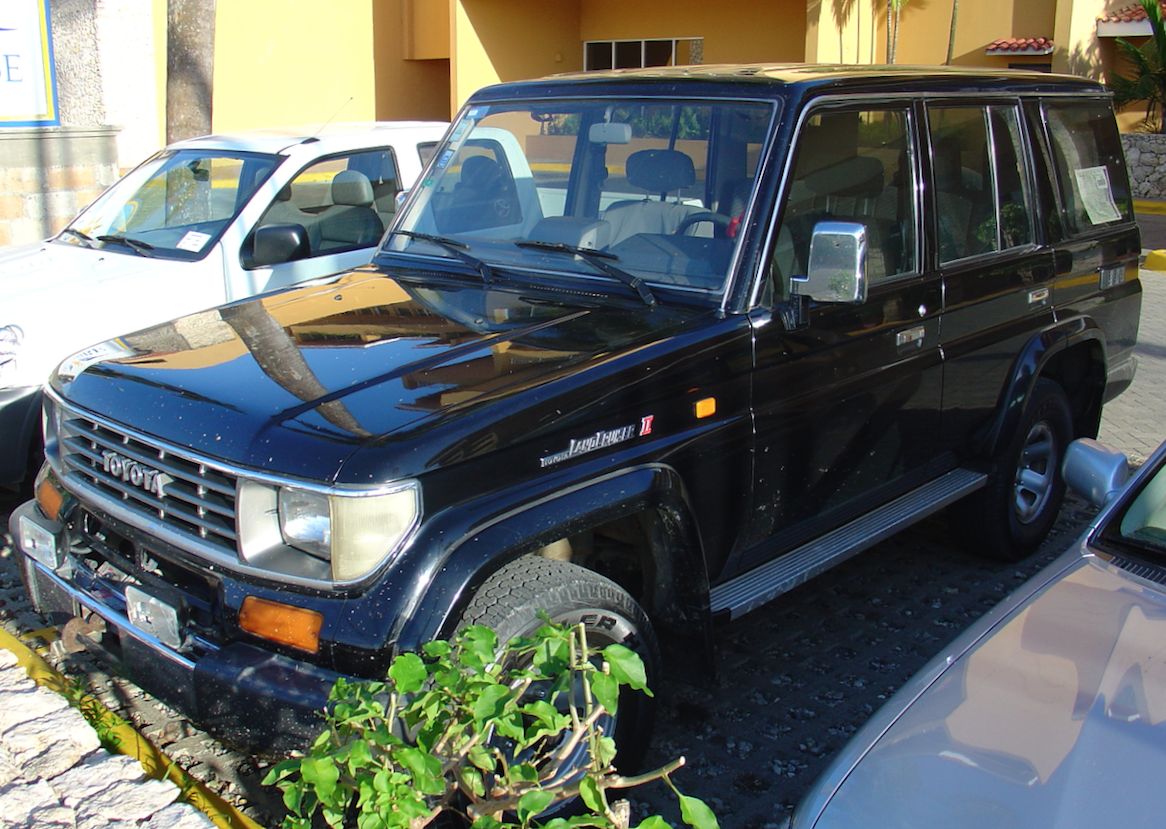

Greetings 70 series enthusiasts! I'm in the USA (Idaho) and in the hunt for a 1FZ-FE J70. Growing up over seas, our family car that I learned to drive on was a TD LC-II (attached photo) and I have wanted a SWB version to adventure around in since. I realize the 4.5 EFI may seem like an odd request for an ADV toy but diesel is a deal breaker for me and so are carburetors. I need the car to be as quiet and free of fuel smells as possible. I'd go electric if there was a long range way to do it.
