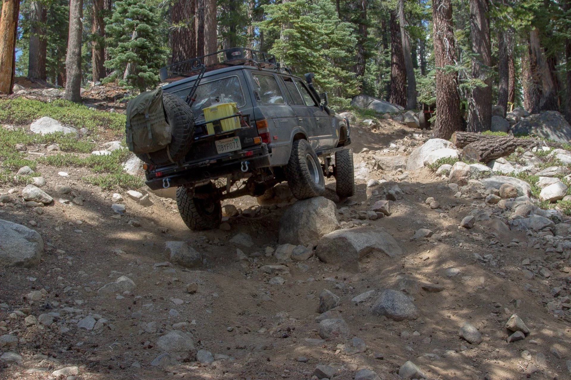

I run a 1997 FF FZJ80 rear in my 62. The rear is wider than the front and it tracks fine on the freeway at 90mph and wheels fine. I used a kit from Rough Stuff Specialties and chevy leafs. I have a spare 4.11 ring and pinion gear (no diff) that you can have cheap to regear your front if you need to match. I run 4.88's with my 35's right now.
So on your FJ62 in that shot, how are the rear wheels at stuffing in the fender wells? Looks tight.
I don't rub in the rears at all. I used to but I went with Interco Bird Dog rims which have a lot of backspacing or whatever the proper term is which keeps the wheels out away from the body. I assume this makes my scrub radius on the front a bit rough but no failures or issues.
