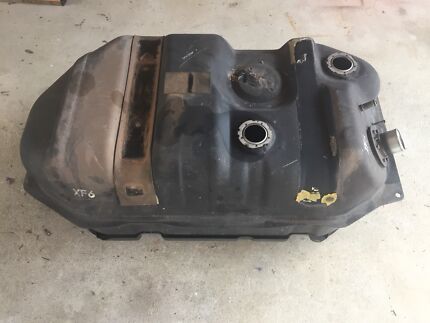

One of my sources in Europe just offered me a brand new stainless steel tank from a new LC 76,I was wondering if this would fit a troopy since some of the older troopys are at that age where swapping it out makes sense.

Is it stock capacity? Be interested in a bigger capacity one
Troopy rear tanks are 90 liters. 76 tanks are 130 liters. The tank shown above appears to be an enlarged aftermarket tank.
It looks like an aftermarket tank. This a 2010 VDJ76 tank which has the same part number as the HZJ76.
The HZJ78 has different part numbers to the 76 tank, not to say it wouldn't fit though.
Yes it is an aftermarket tank for sure,Toyota does not offer tanks in stainless
The ARL VDJ76 has the 130 litre tank but other markets kept the 90 litre tank if they had the 1HZ.
This one below is the larger tank for sale on ebay. They have it listed as post 2013 tank 145? litre for a dual cab VDJ76. I think they at trying to say it fits either the dual cab or the 76. I haven't heard of a 145 litre, maybe you can squeeze it in to a 130 tank.
