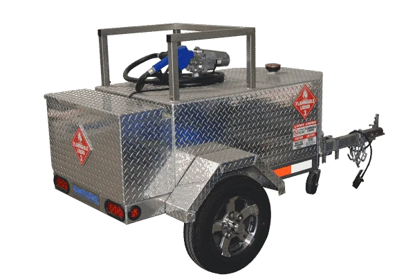

If you really want to go big
But it requires moving the spare. It replaces the 46 litre sub tank we have
I have one of their 180l tanks in my diesel. Gives me a total of 270 litres. Amazing range and allows me to fill up at the cheaper places when I'm travelling outback.
Freight may be a bit of a killer though
Let me know if there's anything else I can help you with. :)
No joke. You asked for a solution, I gave you one. haha.
