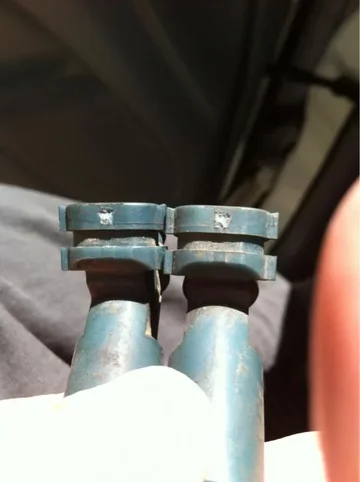

I'm not really sure how it would happen unless the PO pulled on it real hard without depressing the release clip. Wish I had shot a pic for all to see, will get the old injector and post up a crappy phone pic. It's the release tab on the bottom of the injector fitting that's busted off. Guess the vibration of driving finally vibrated the wire connector loose.

Here are the culprits.

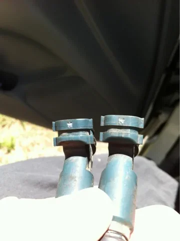

And a little closer
Two new injectors and down the road I went, problem solved. Time will let my wallet recover.
