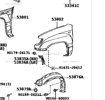

Hi, my antenna mast cord broke and so it is time to take out the antenna motor to do the repair. To access the motor, the wheel well liner needs to partially come out and it is held with some black plastic clips. I understand that these clips often break and so before I start the job, I would like to have some spares in hand. Went to Lexus, they told me to order part no 75396-30260, received them, but those are white clips, not the same type. I searched on the diagrams on line and the best I found was part no 90467-10186, called a liner retainer clip. Received them, it is not the same part, this clip has a round head. The clip in the wheel well is not completely round, has two flat sides. Does anyone know what the part no for these clips is?
thanks
looks like 90189-06211 to me
this is what 90189-06211 looks like^

Thanks for checking, I should have added that my LX is 2000 model year. I just took photo of the clip, it does not look like part no above .
Many threads come up if you search "fender clips"
You can either go the more expensive OEM route
The 22 clips that hold the fender liner in is PN 53879‑60010. Retail for about $1/ea. I gotta order some too.

I have no point of reference as all of mine are missing. @LucasM , the part number i have looks just like the picture you posted. Part 53879-60010
I'll update this post once i get around to installing them.
UPDATE: THESE ARE CORRECT. 3 on each side.
