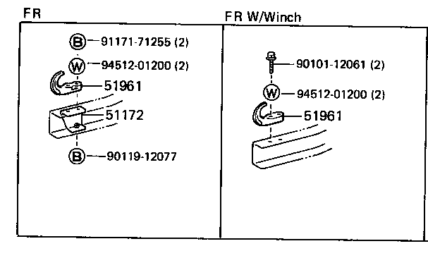

Looking for the part number for the two bolts on the front tow hook.
I can find the tow hook part number, but none of the parts diagrams I'm seeing include hardware.
Thanks for the help

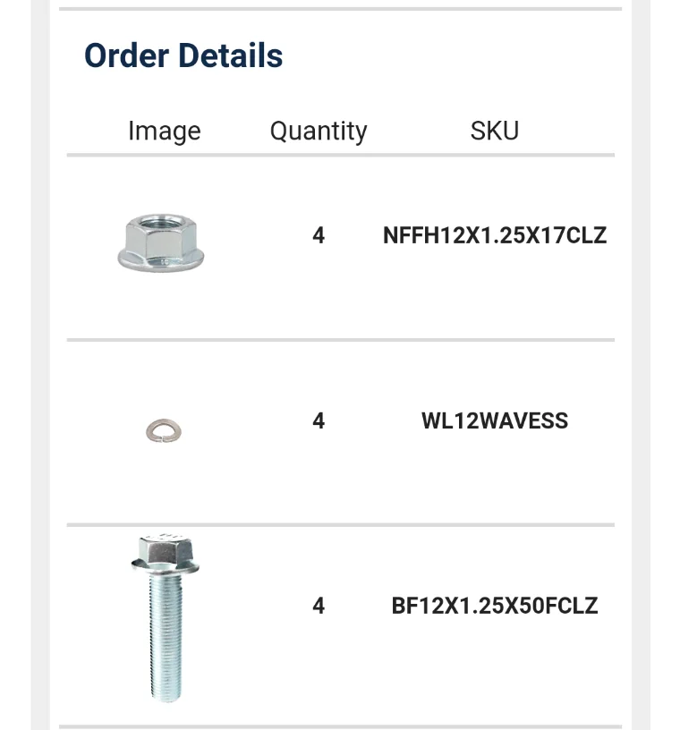

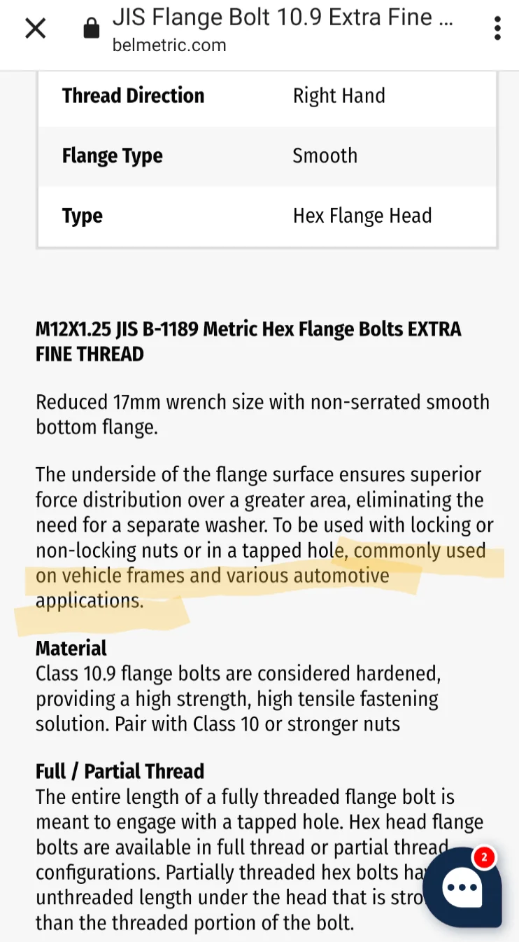

I ordered these JIS bolts from Belmetric for the front tow hook. Work great 👍
I try to get Toyota bolts wherever possible too. The ones for the tow hook were rusty and I'm sure there is a Toyota part number for M12 x 1.25 pitch bolts (and nuts) in around a 50mm length, but I figured the Belmetric hardware would be good enough for my purpose.

Curious, where did you pull that page of the parts catalog?

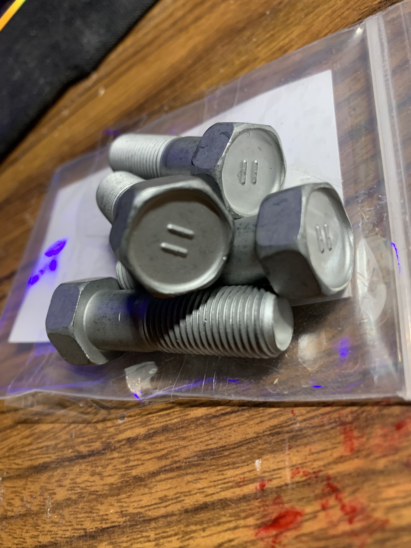

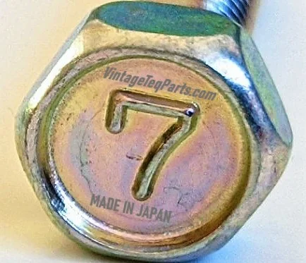

these are the updated JAPAN Spec. JIS grade mark haed 11
this is simply heavy duty toughj as nails and oem toyota period correct 2022 year technolegy
The old 12061 is disc.
