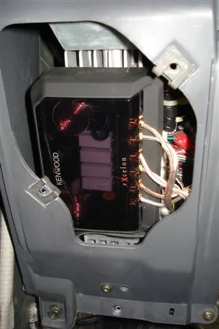

1) The new speaker is behind the stock grille- No spacers, prayer or snake oil required! I had to clip off the round loops that stuck out around the mounting holes. Used #8 X 3/4 pan ss screws to mount in the stock nutsert thingies.
2) The Excelon passive crossovers go where the old dash speakers were located. There is a slider switch that controlls how 'bright' the tweets are.
I mounted the tweeters on the dash in the corners by the a pillar, they are hardly noticeable.
