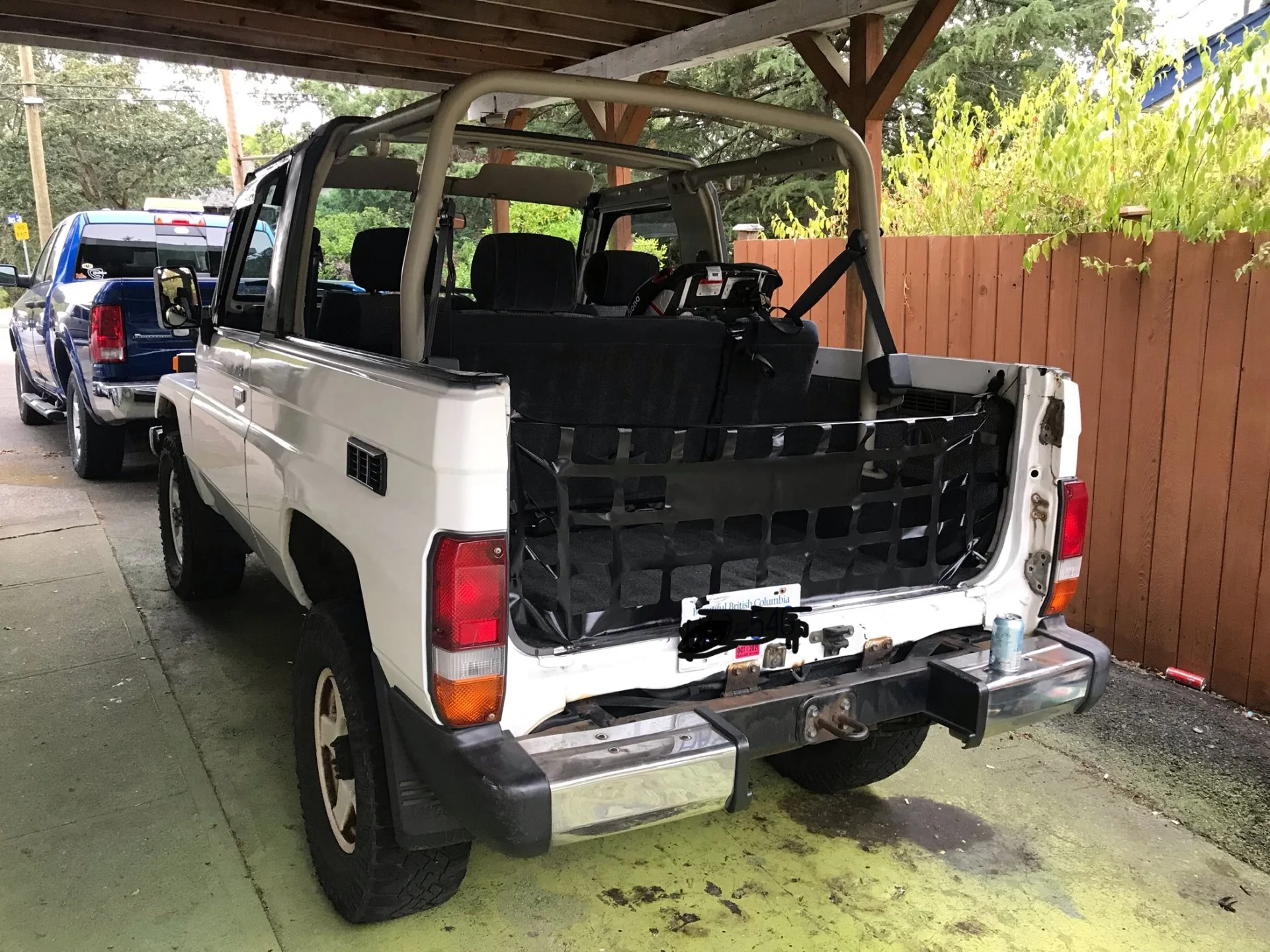

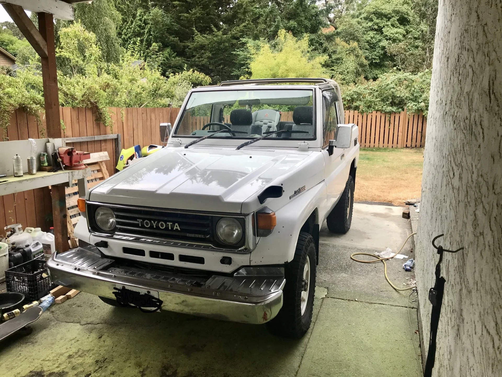

Hi. I’m looking for opinions on front rotors and brake pads for my 93 HZJ73. Front rotors are warped a little and it’s driving me nuts. I heard there is an upgrade if I use 80 series parts but I don’t know what parts to get. Any help would be greatly appreciated.
