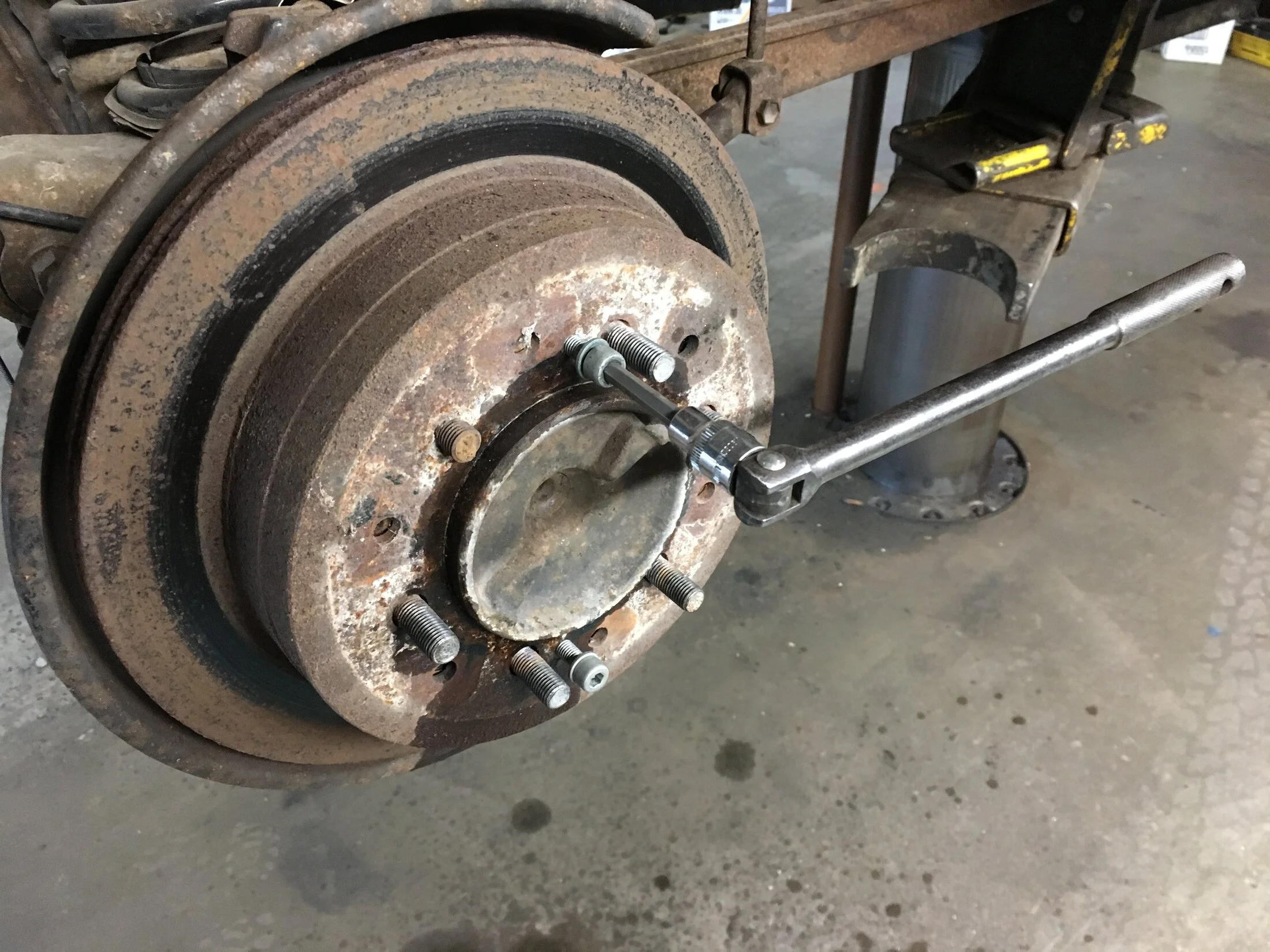

FJC rotors work on a Prado, so I doubt they’d work with a FF rear axle. Any chance you have some other photos of your rotor? This is what my originals and the FJC ones look like:

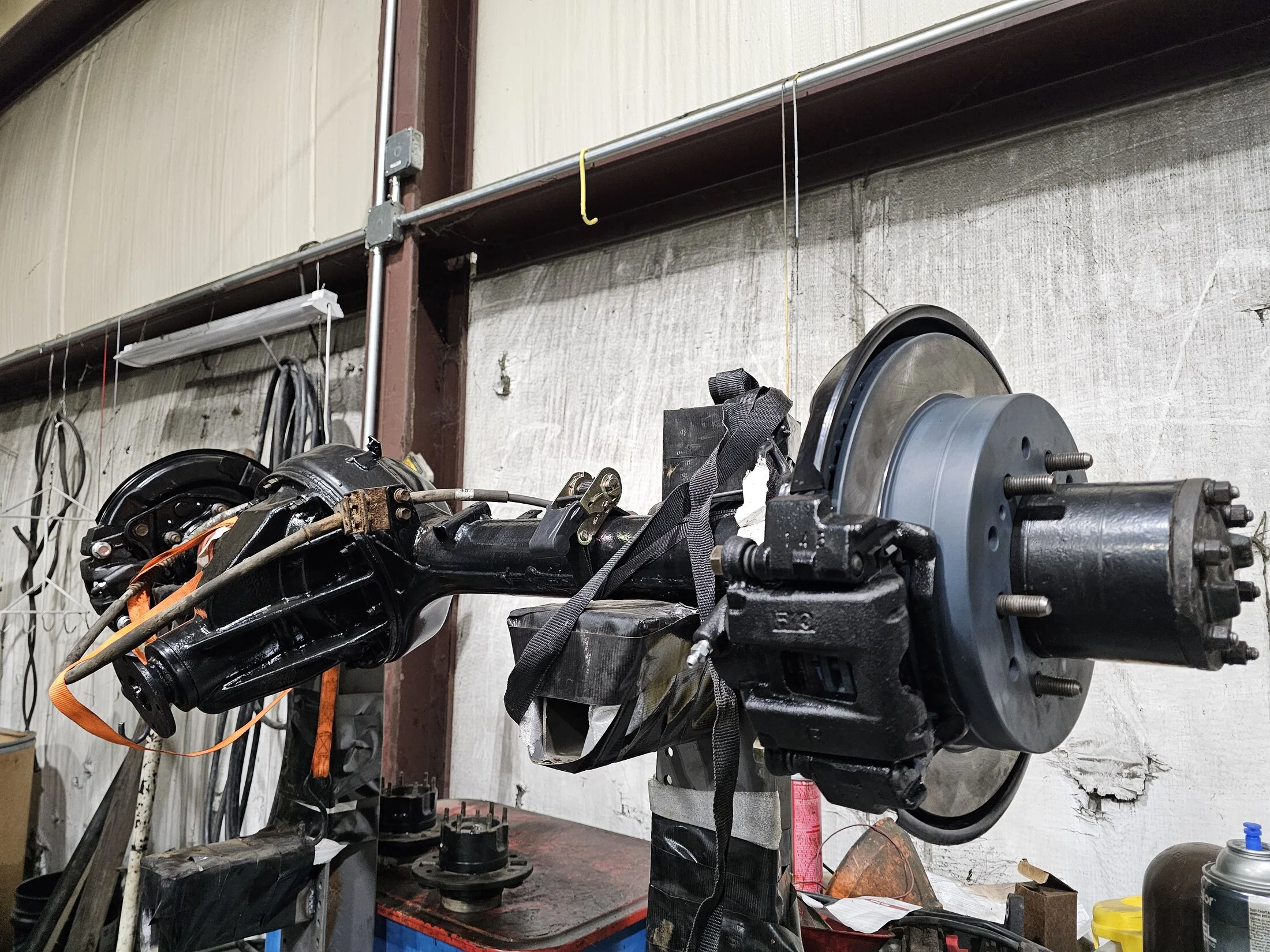

I just got my rear HZJ-73 axle rebuilt. We used FJ Cruiser rotors and calipers. The calipers are switched left to right, and of course Fj Cruiser pads. The park brake cable and e brake parts went back smoothly. It will be a couple of weeks before it goes back under the truck. We are actually swapping in a refreshed set of axles with air lockers into my 98.
The brake hose mounting is very tight looking but I am getting FJ Cruiser brake hoses and they look like they will work.
Soooooo, long story short, I am 90% sure this all works but will be a couple weeks before knowing for certain
Soooooo, long story short, I am 90% sure this all works but will be a couple weeks before knowing for certain View attachment 3801062

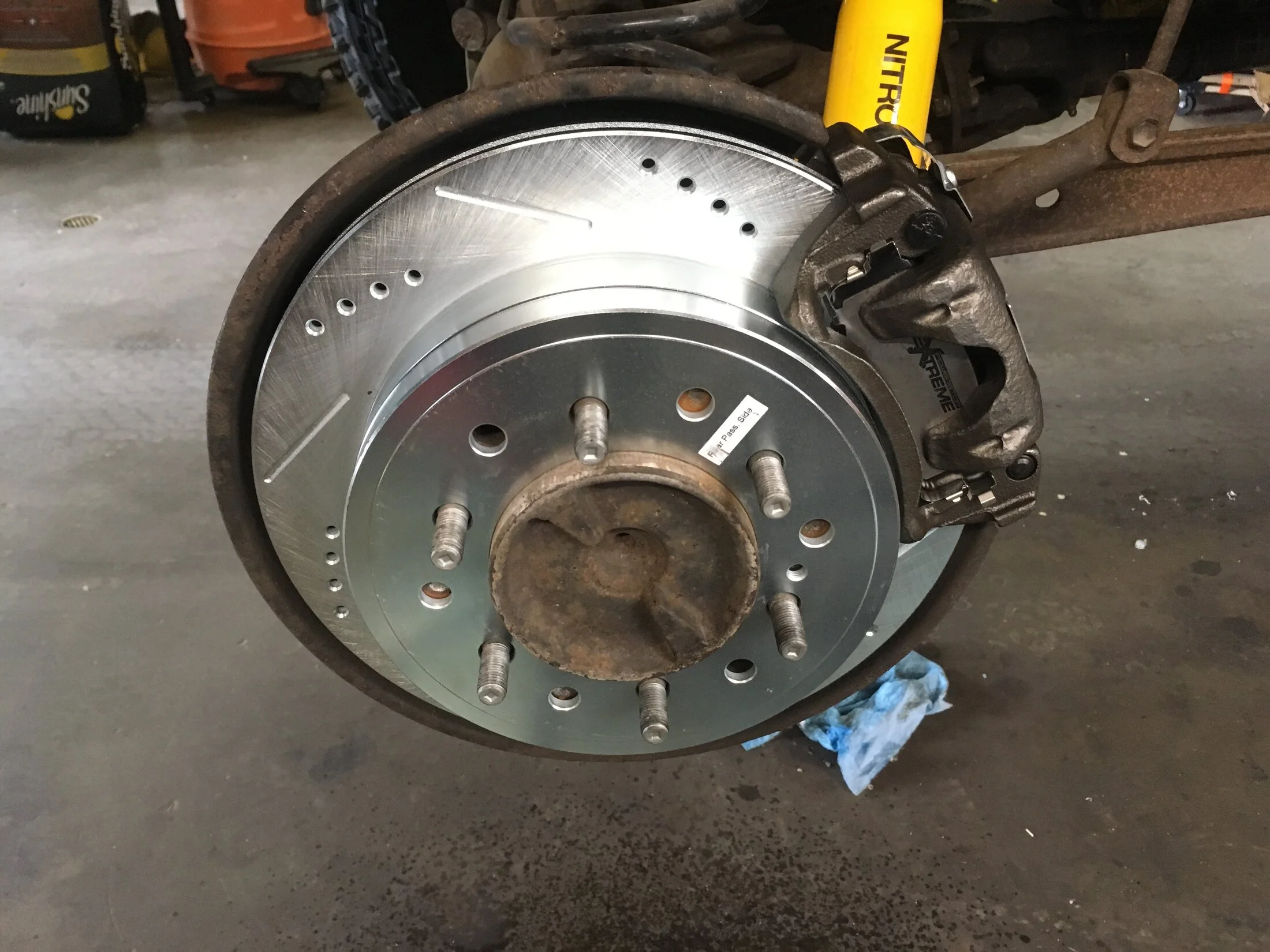

The FJ calipers definitely work. See my build thread for parts details. I have rear rotors from Terrain Tamer. I used stock brake hoses and lines. Assembly of the parking brake is a pain in the ass 😳
What’s the part number for the FJ rotors? I've got it as 42431-60311. The 73 is 42431-60180

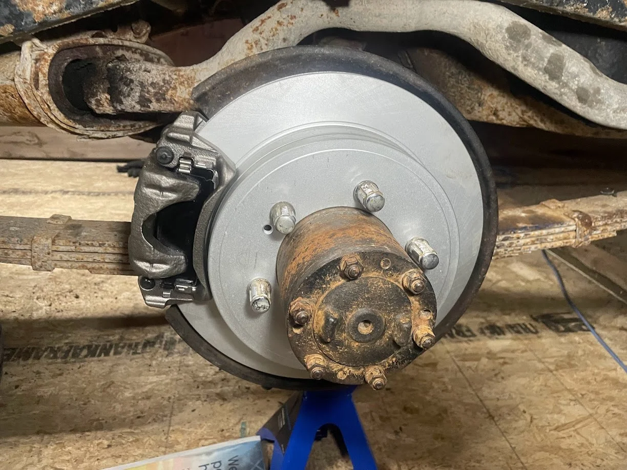

Here is a pic of my rear rotor. It looks like it has fewer holes then the one you've got. Speed Holes - LOL!!!
Here is a pic of my rear rotor. It looks like it has fewer holes then the one you've got. Speed Holes - LOL!!! View attachment 3801097
I got my rotors/calipers from Napa. Not my favorite choice but they were in stock 5 minutes away and we were ready for them. There are 2 sets of slightly different 6 hole patterns, not sure why but that doesn't hurt anything so no harm, no foul.
