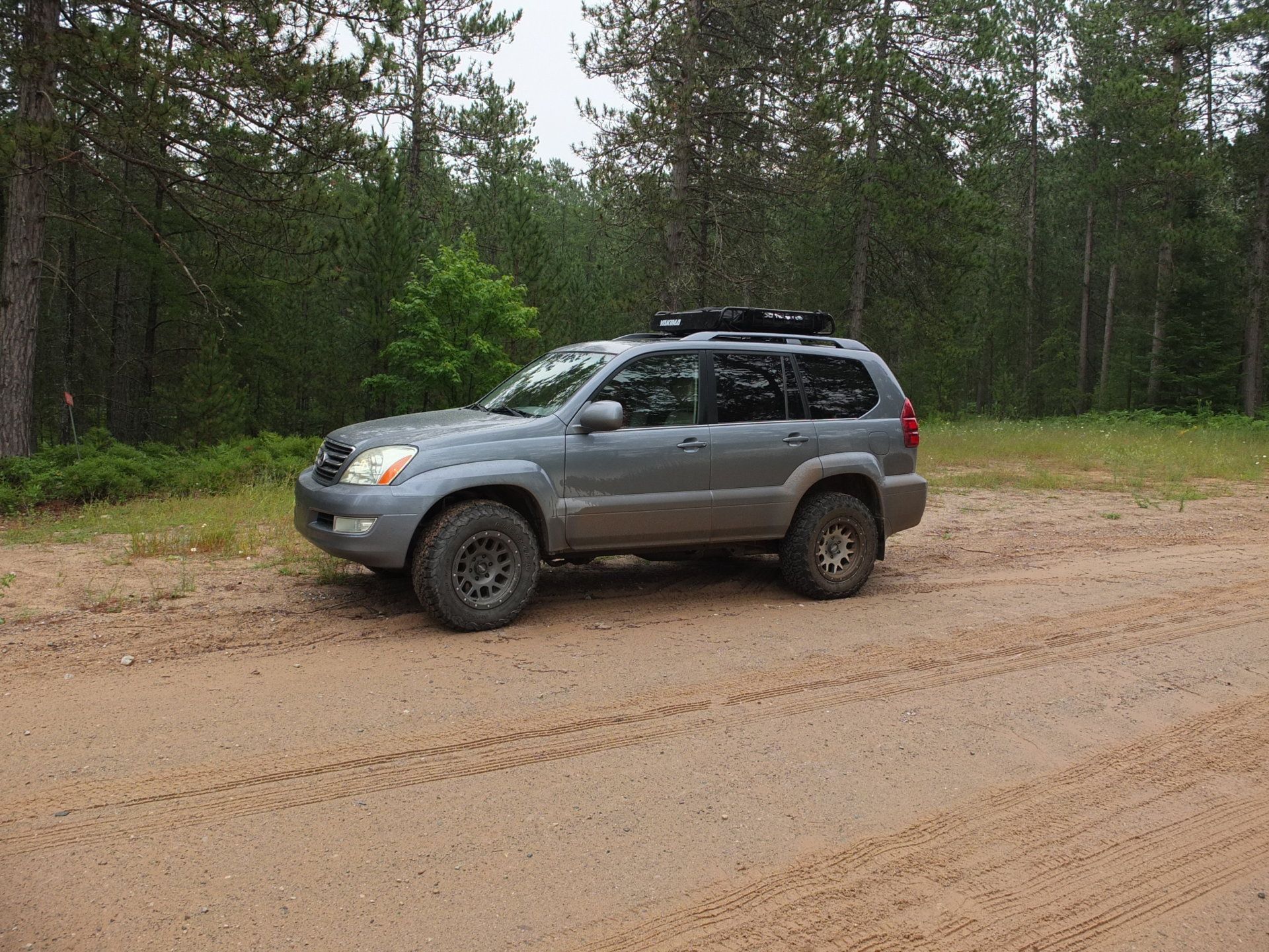

I will try and read the numbers on my Fox springs, I would say the spring rate is light. If you want a true 2.5 and will be loading it down with armor, junk, etc I would go heavier on the spring rate for sure. I have 2.5's with remote reservoirs and no adjusters for reference. I also run OME 895E springs in the back and they handle all of the weight I put in the truck and ride well unloaded.
Here is a pic of my setup fully loaded with a weeks worth of camping gear including a fridge and AGM battery in the back.
I agree with you in the fronts being a little light. I would want the 700# springs if I was adding any weight. I have Ironman springs in back but I’m not sure which ones. I have Fox 2.0s back there and it rides nice.
