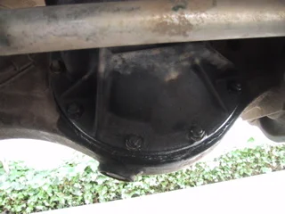

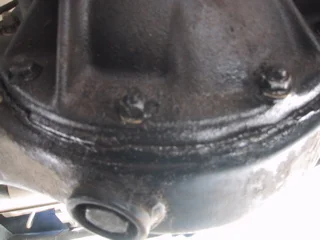

I took my FZJ80 wheeling a few weekends ago just noticed that there is diff oil leaking from the back of the front pumpkin. The bottom nuts were also loose. Could this have loosened when the front shaft was over-stressed, from overfilling the diff fluid, coming down on a rock too hard, grease contamination from axle or do these gaskets just wear out over time ?
How do I tell if this has anything to do with the pinion seal ?
Thank you,
Matt

This won't be a breather issue simply because looking at the entire diff chamber as a unit, the easiest place for pressure to get out is the axle seal at the tips. To me, it seems just what you described - loose bolts on the rear diff cover. While not common, some folks here have found a few loose and it's simply from someone during the truck's life perhaps not torque-ing them down, or slight flexing from hard use. I suspect you can torque them to proper specs and stop the leak.
DougM
I had this happen in Death Valley. If the 3rd member is at all loose, the torque causes shifting of the third member(differential) on the studs. That allows oil to seep past the paper gasket that sits between the third member and the axle housing. If you are really lucky, tightening the nuts to the proper torque will solve the leak. If you are not lucky, and you probably arn't, you need to pull the third member and replace the gasket, which requires the disassembly of the front end. PIA, but pretty straight forward. A leak at the pinion seal, the one time I had one, was pretty obvious.

I had this same problem. Ended up having a dishonest mechanic at a gas station pull the paper seal that was already gone when I NEVER asked them to, just asked them to refill it with gear oil so I could get it home. Ended up taking it to LCS my local cruiser shop and they replaced all the inner axle seals and everything. Doesn't look likea pinion seal leak, there would be gear oil all over the crossmember I think or that bar that goes across the axle right under the third member where the front driveshaft connects. Oh and my nuts were loose as well.

Clean the oiled area really well with brake cleaner. Make sure you torque the nuts to spec. If the oil leak comes back, you should be able to tell where it came from. In my case, the nuts were a bit loose and the differential case shifted enough to tear the thin paper seal. Driving the 400 miles home, I had to stop and add a bit of gear oil every hour or so. The only fix was to tear it all apart and replace the gasket.
My theory is that the front differential on the 80 series is attached to the axle housing with 8mm studs and 12mm nuts. They do not develop the same clamping force as the 10mm studs and 14mm nuts used in the rear and in all previous Land Cruisers. Over time with heavy use, the third member can squirm a bit and eventually loosen the nuts. My advice would be to check those nuts at every oil change and make sure they are tight-spec is only 20 foot-pounds. Compare that to the rear tightening spec of 54 foot-pounds and 30% larger fasteners.
One last thing-check to make sure the drain plug is tight. I've seen them get unscrewed when you smack them on a rock.

Looks just like what my pinion seal leak looked like. :)
