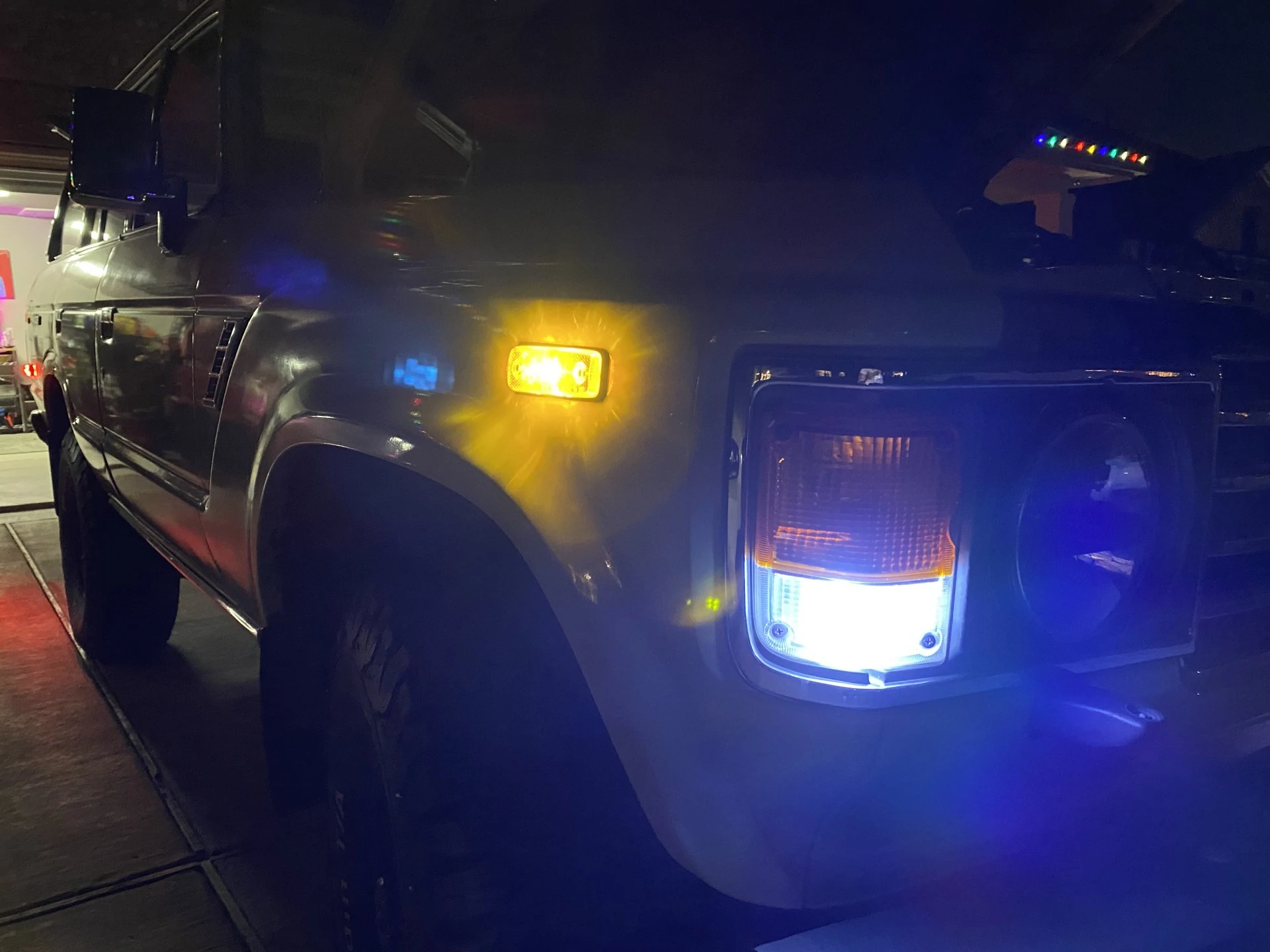

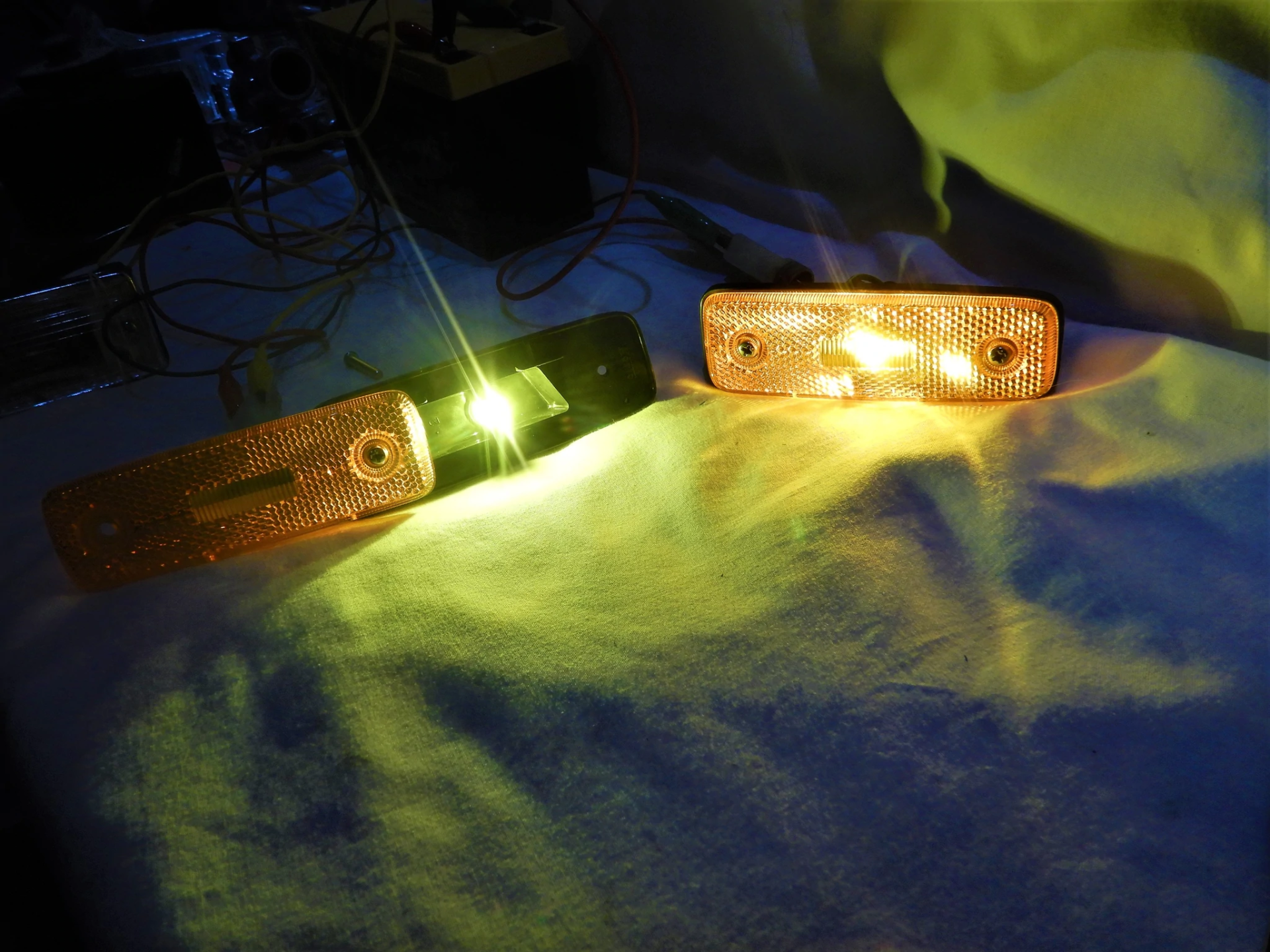

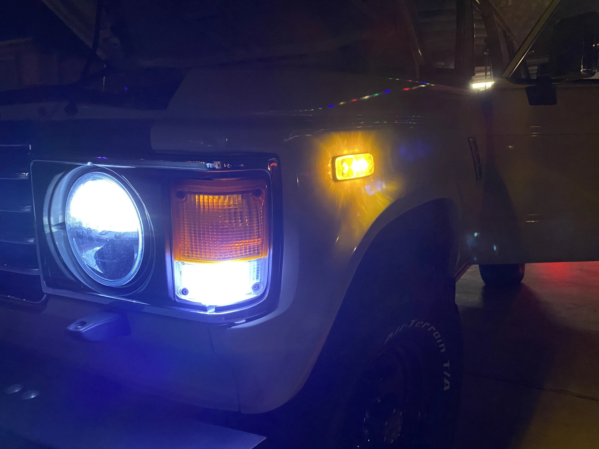

i can help here
i offer 2 options
Kustom Kioto New genuine toyota with very HIGH quality non usa sourced LED Upgrades Bulbs
see links below
the NON USA HJ61 Lower cost ones are kool period correct flare and direct plug and play too
thanks
i can help here
i offer 2 options
see links below
thanks
