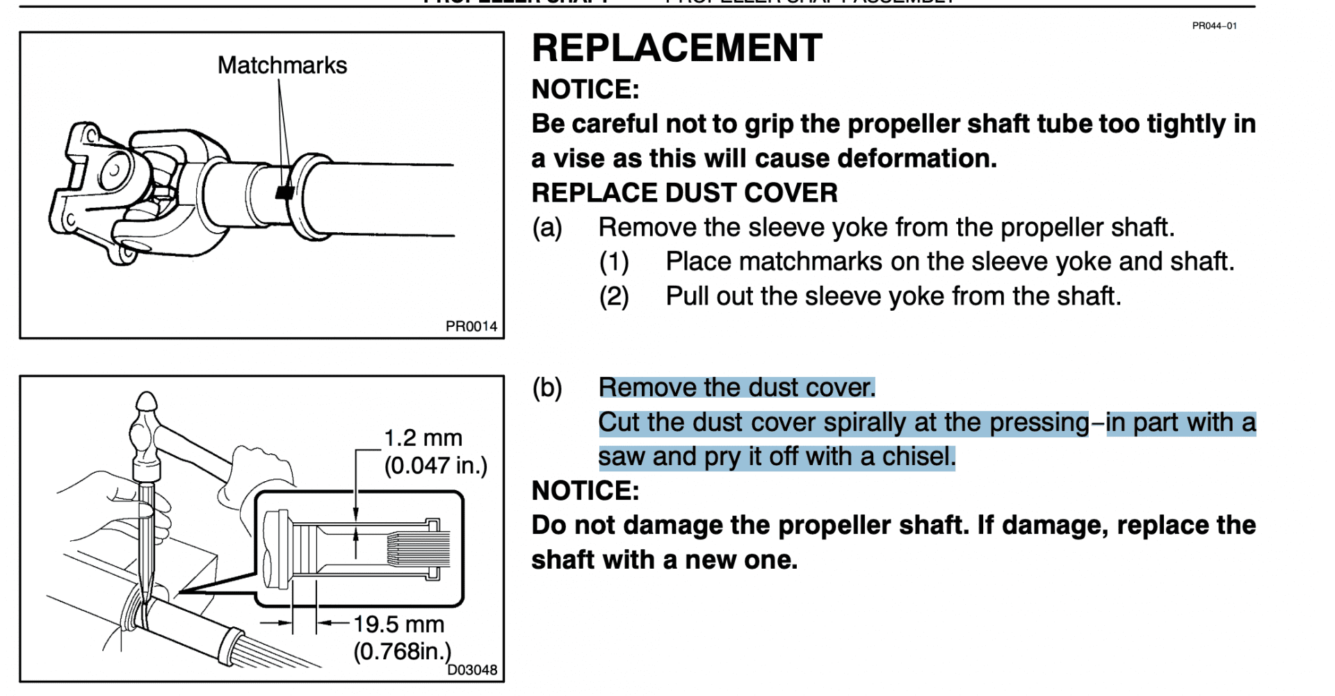

I've been watching what I assume to be the dust seal/cover poke it's way farther and farther out of my front driveshaft. I was going to replace the whole thing but was reading the FSM which seems to indicate this can be serviced. But, I can't find the part number. Has anyone done this and know what it is?
I'm in the boat of replacing the entire driveshaft. If you're going to go to the trouble of replacing that seal, might as well do the u-joints while it's out. Then get it rebalanced. By the time you get all of that done you could almost justify just getting a brand new driveshaft which comes ready to install.

Hmm, that was my original plan until I found you could replace the seals.

IMO, for the front driveshaft, I'd just pull it and inspect the U-joints for play (and replace seal). That front slip joint hardly moves and hardly gets out of balance. The rear driveshaft takes the grunt of it all.
If you want to spend money, and considering your mileage and upcoming trip, maybe R&R the rear axle seals.
