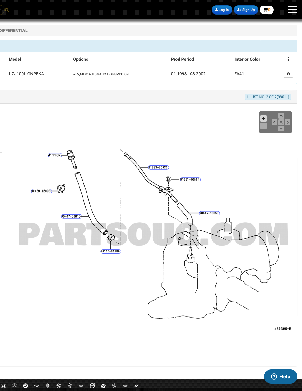

Here's a Partsouq screen cap of the front diff breather. ('99 UZJ100)
Barb fitting off the front diff into short piece of hose into a hardline
into another hose then finishing with the breather.
I believe the line travels up the passenger side of the fire wall.
