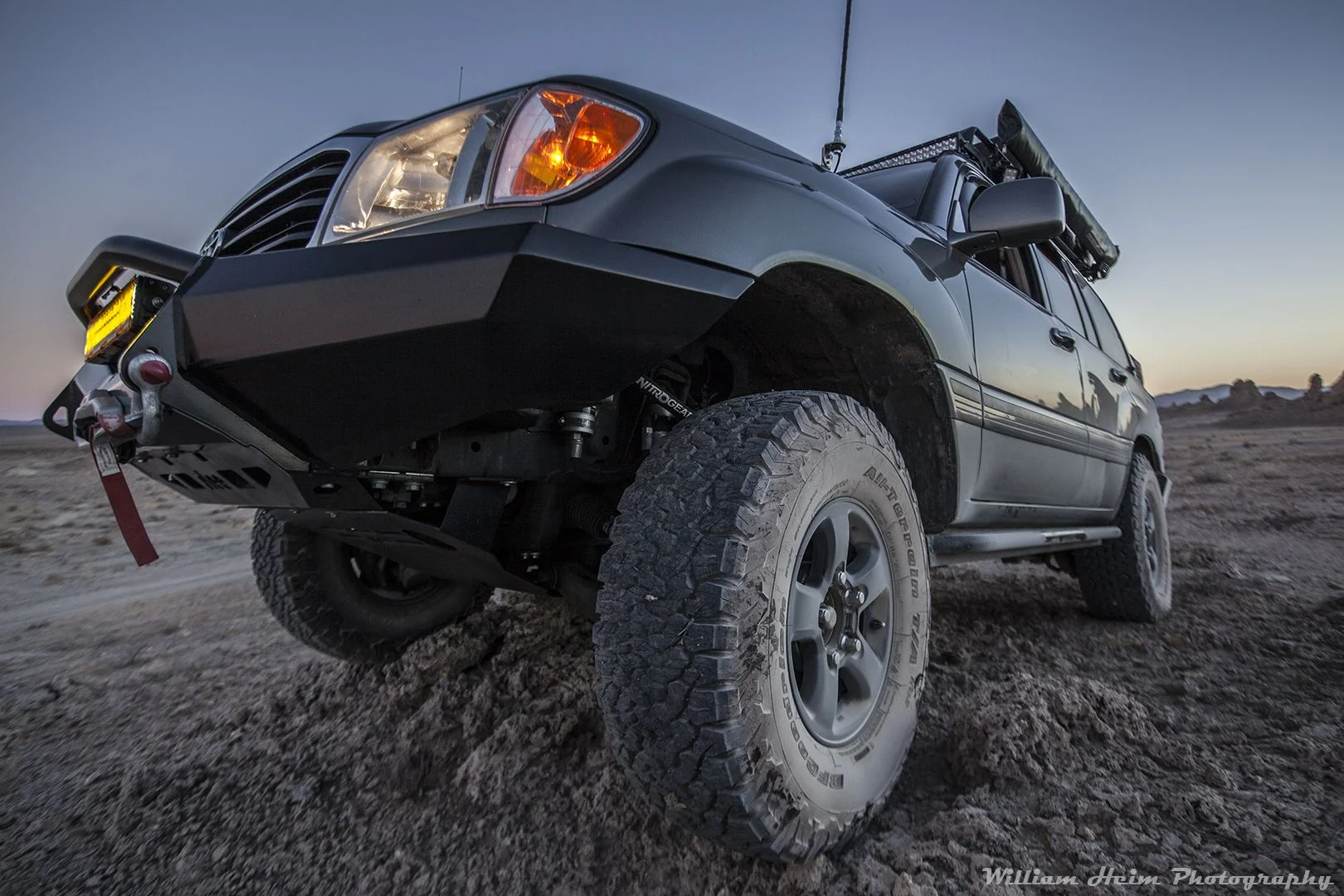

Over the summer, I did some major (but common) modifications to my 100s. One of the changes was to do a 2.5" heavy load lift. The lift consists of Nitro Gear UCA's, Old Man Emu torsions and springs, Icon 2.5 stage II RR shocks. The upgrade has been really nice but I've now run into a problem and could use some assistance from our knowledgeable community.
