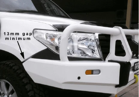

Sorry for the delay.
It has adjustment built into the brackets and should be set with 13mm of clearance between the fender and the bumper edge to allow for movement. Once the height is set properly, drilling is required in the "pinning bolts" to set the bumper in its' final position.
It comes with rubber filler panels, so on the 200 series facelifted models, you don't have to cut your original bumper.
Thanks for the reply I am really interested, one more question is 13mm enough clearance considering? by looking at this vid it makes me think I need a bit more but maybe I am wrong.

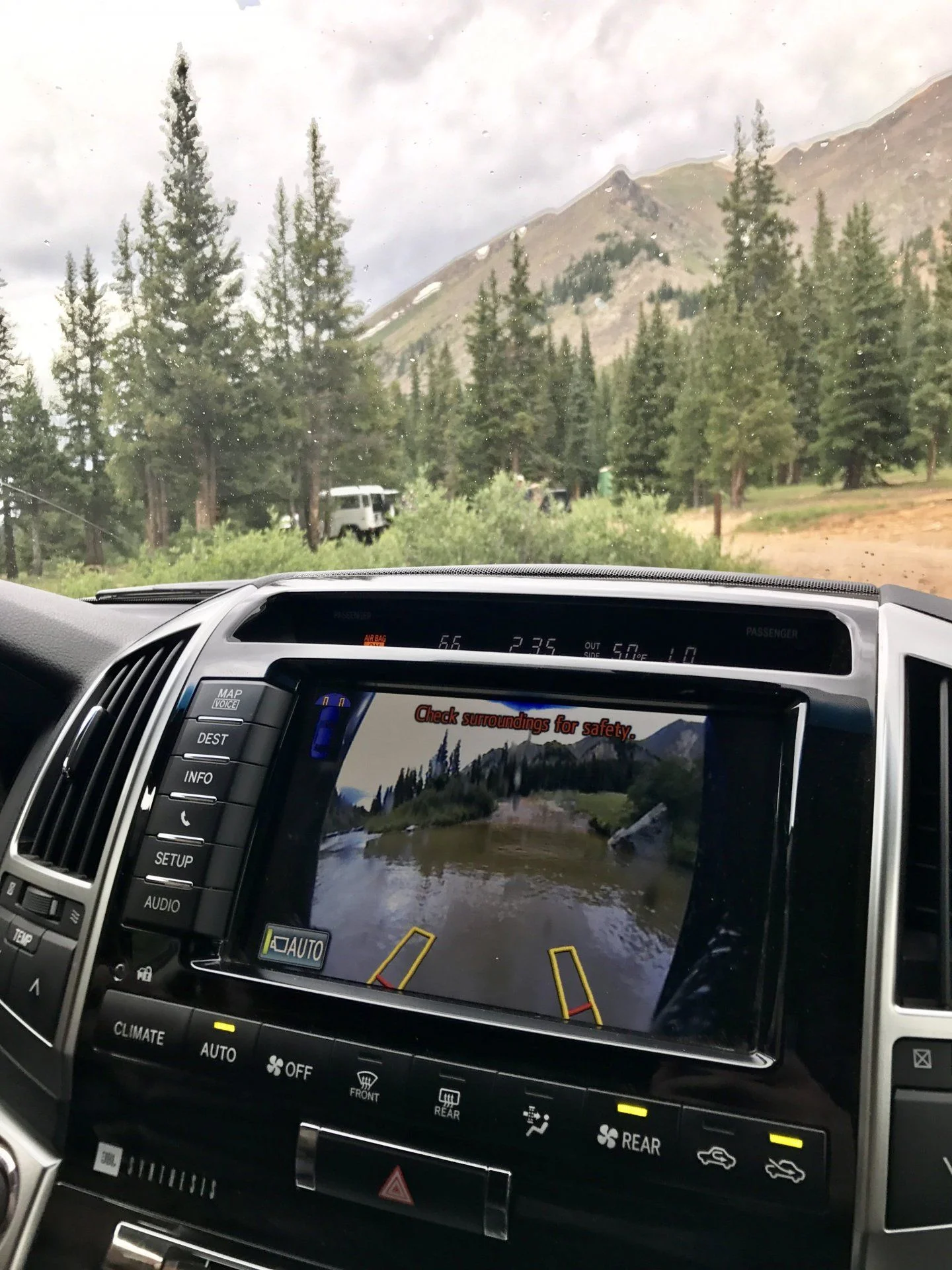

Did you do the camera relocation kit? I have the relocation on my ARB and this is the view with it - totally unobstructed:
