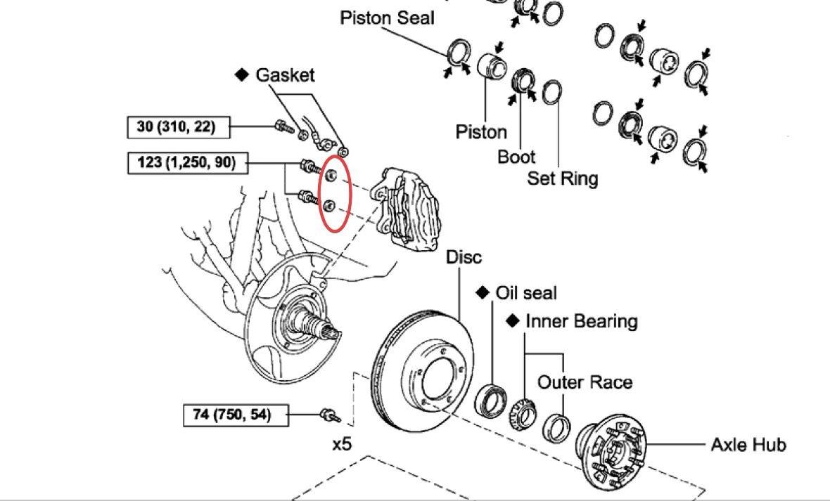

While reviewing the service manual, I noticed there should be a washer but my LX didn't have it. Checked a brunch of YT videos, and didn't see any has the washer either.
So my 1st question is if the washer is necessary? I assume it's since it's designed in that way. Can I use any M14 washer, or it's a special one?

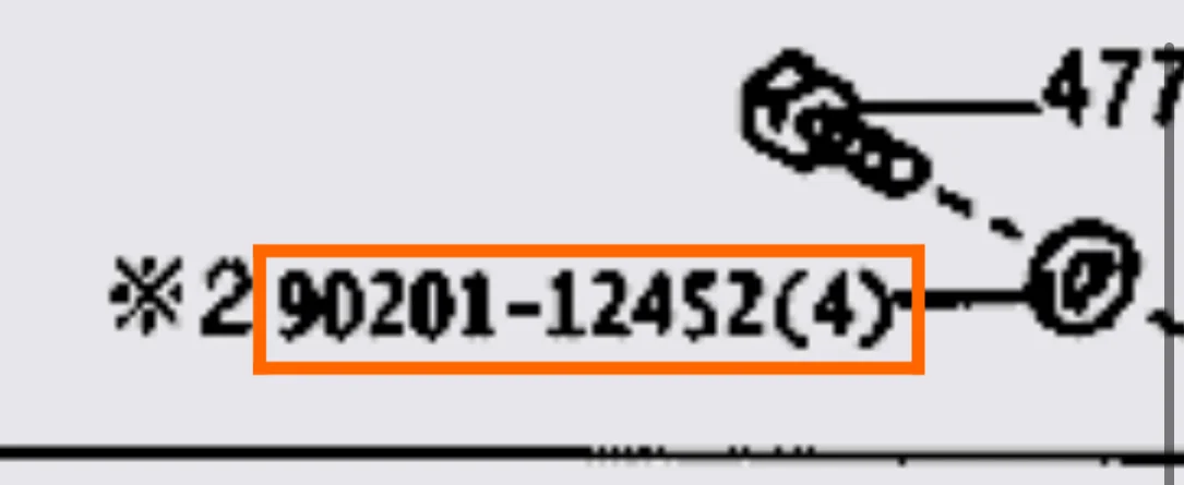

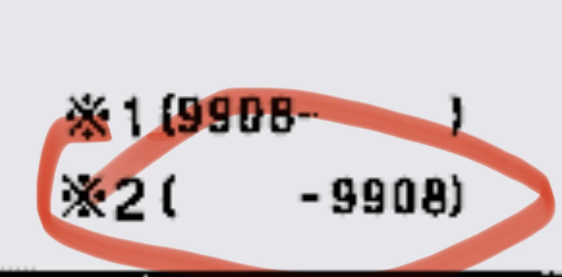

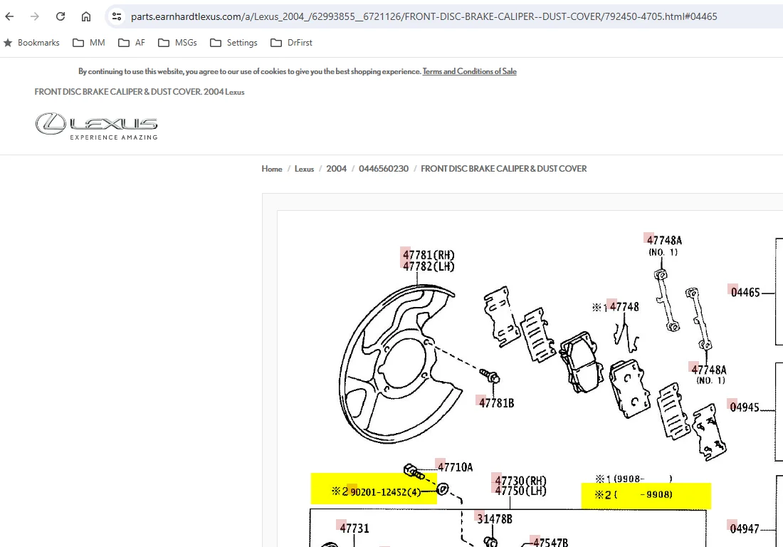

90105-12175 do **not** require washers.
Washers were only specified through 08/1999. After that build date, caliper washers were not required.

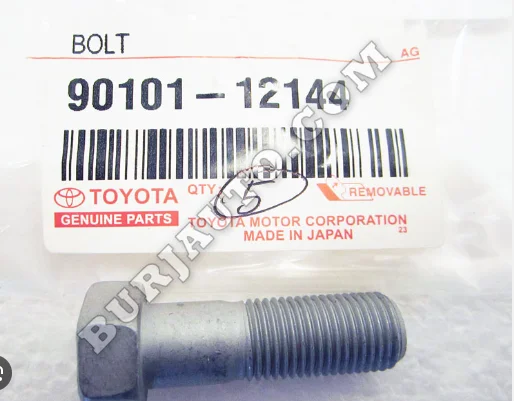

Just checked the parts catalog for 1999 LX470, and the bolt part # is 90101-12144, which has regular hex head instead of hex flange head. Although washer isn't required for flange head, I will still add the washer to be safe...

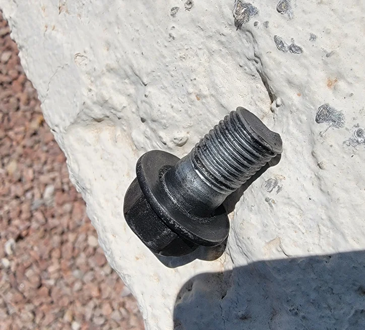

As @OGBeno said; washer was done away with, after 99. We use the newer bolt on all years 90105-12175, when we replace.
The rear calipers, do use a washer 90201-12452 with bolt 90101-12167.
Toyota changed the recommendation in 2008 (200 series). Making the bolts non reusable. The new bolts are the same as 100 series, except they have sealer on threads, and torqued reduce 20% (due to lube/sealer).
